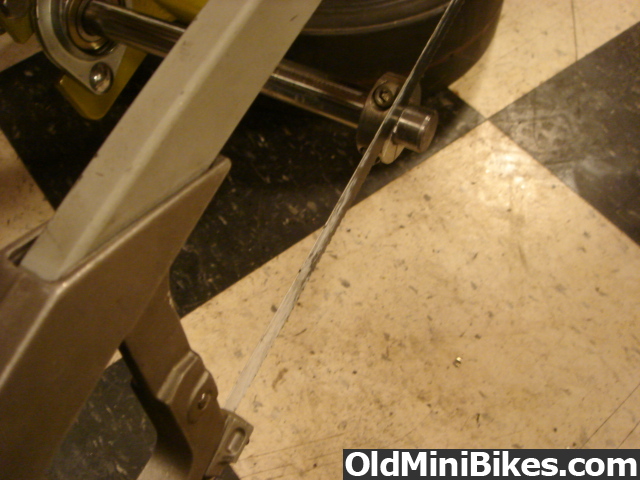

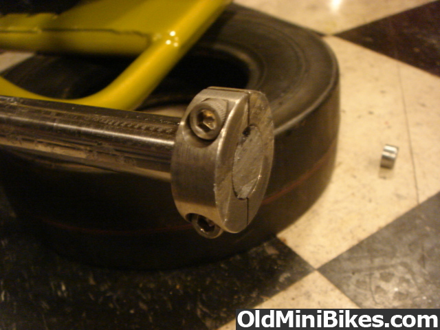

Needing to cut down the axle in my trike, but not wanting the job of taking it all apart….I used a ¾” shaft split collar and locked it in place . This acted as a guide for the hacksaw blade and allowed for a perfectly straight cut…..(you could actually use two collars seperated by the width of the blade)…
I finished dressing the end with a smooth file.

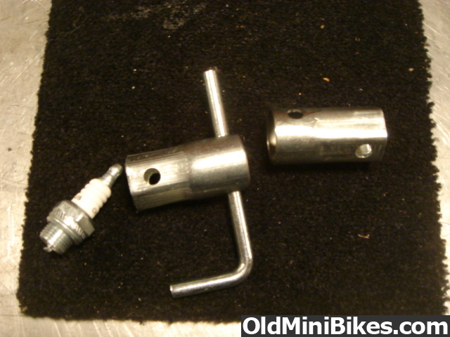

I like to keep a small tool kit on one of our bikes when we venture out…just the essentials: screwdriver, small pliers, spare plug, plug wrench. The problem is some bikes have no clearance above the plug for a socket and wratchet…sometimes you darn near need a box wrench to get them out.
We solved this by using one of the inexpensive plug wrenches sold in the OldMiniBikes…we cut the wrench in half which gives us a “shorty” socket for each size plug…then re-drilled the cross holes to accept the turning rod.

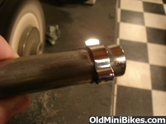

Surpprisingly, a lot of the old bike hardware which looks ugly, has a cadium or zinc plating on them which will easily shine up like chrome if you have a buffing wheel and some rouge...I buffed up 1/2 of this cap screw in less than 5 sec. just to show the difference. I then usually wipe with lacquer thinner or acetone and shoot a light coat of high gloss clear over it to keep it from oxidizing...

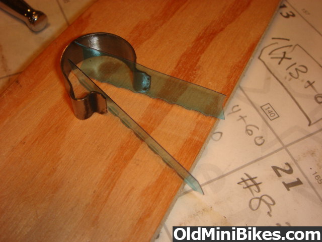

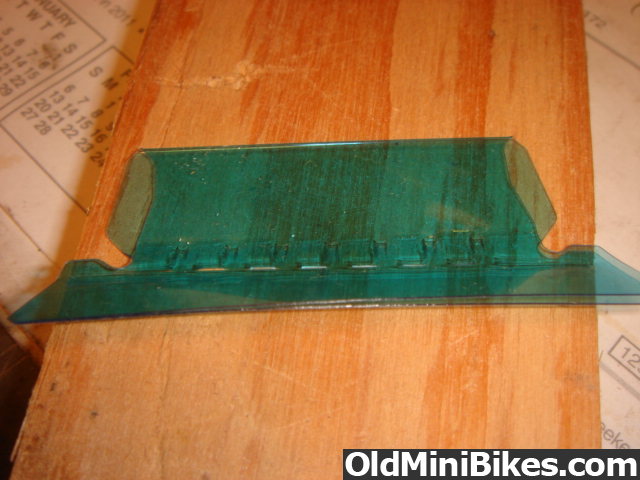

..ever flip out and start throwing tools across the shop because you installed a cable clip and it scratced your brand spankin new paint job ??!!:censure:
Now I take one of those plastic tabs that are used for labeling folding files...cut it in two strips and keep it inside the clip as I pop it on....the strips are slick enough to pull out after it's in position...

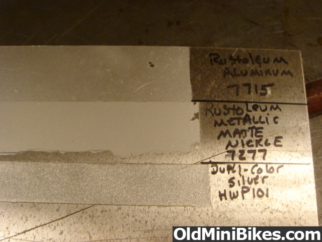

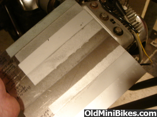

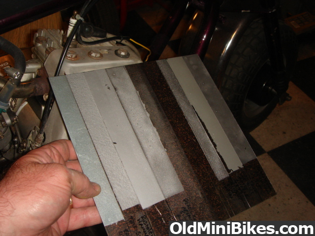

Over the years I ended up with about 100 cans of spray paint :doah:
I have about 8 or 10 shades of silver alone....it pays to take a minute and mask off a piece of scrap sheetmetal and spray a strip lof each color...on the end mark the mfg, name, paint code, etc...in case you run out. This makes it a lot easier when you're trying to match a color or see if you'll like it on a wheel, bracket, etc....just hold the "chart" up to it....:thumbsup:
