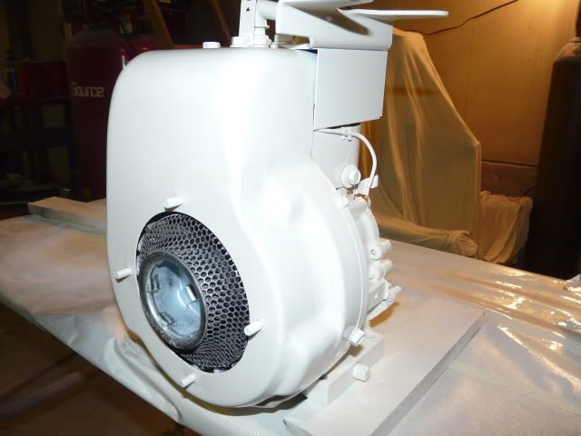

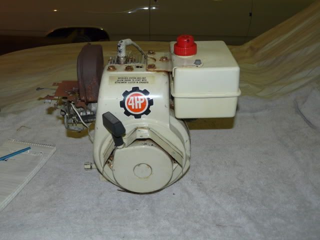

I started with a very clean vintage H35

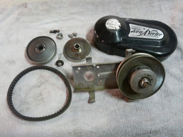

I didnt think of posting this till late so no tear down pics I just took a few tonight. This is the bulk of the parts after a days work

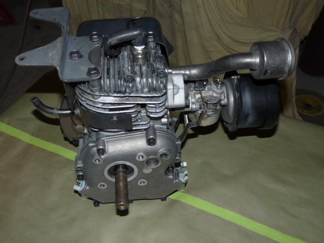

The engine was quite clean inside but I wanted to try and get a little more out of it, and it will need to be eye appealing when finished also. First thing I noticed was how nasty the back side of the valves looked, so I did a slight undercut and a swirl polish versus the oe casting. I also polished the stem and head.
The head in previous pic was milled then I polished the quench area and bead blasted the rest.
#3
The block I did a clean up on the ports with a nice bowl blend trued the deck surface and finished with a glass bead in ports. The cylinder I did in a 400 finish.
#4
A little better look at the head, I milled it polished the quench area then masked the surface, I put a head gasket on it cut the tape then blasted it.
This should lower the detonation rate and not allow any carbon build up.
