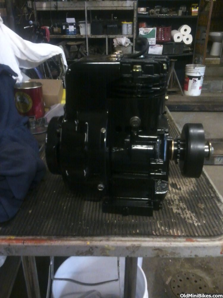

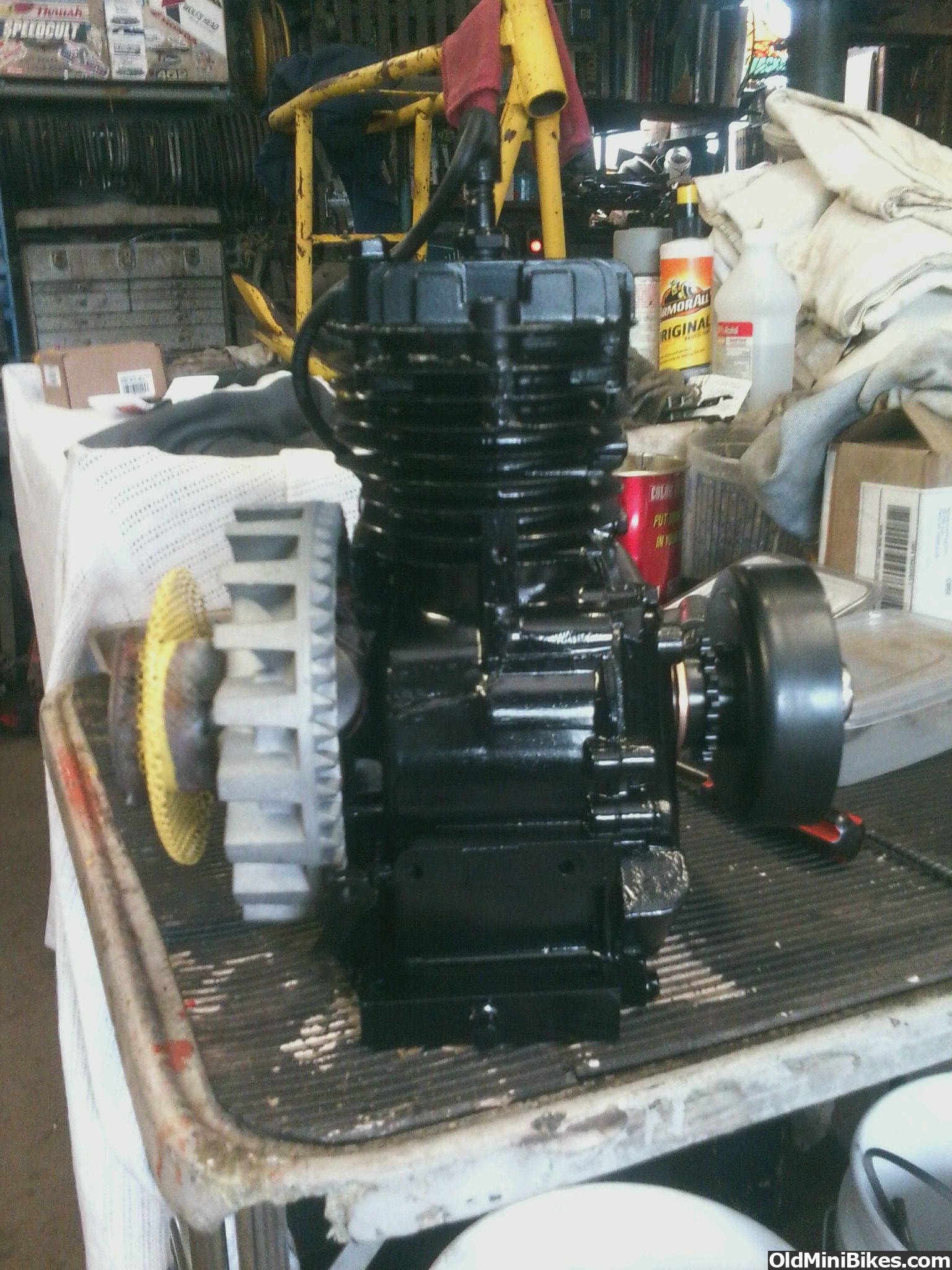

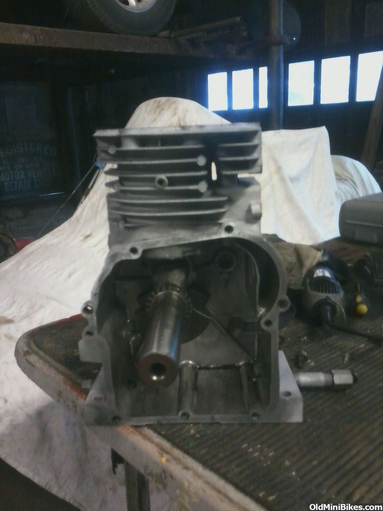

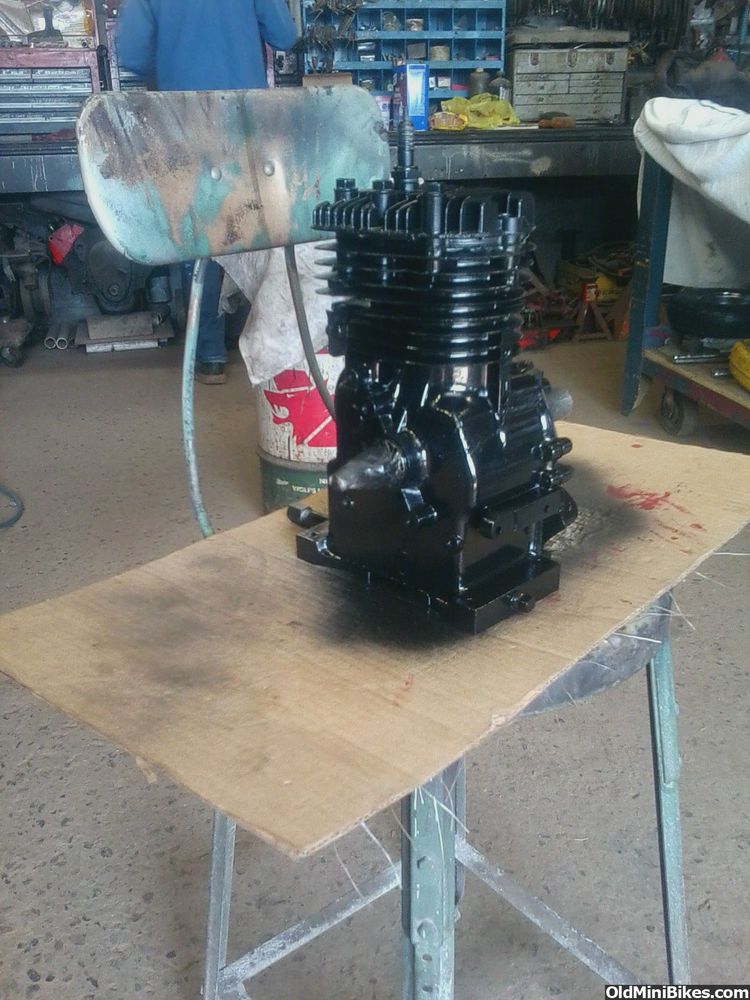

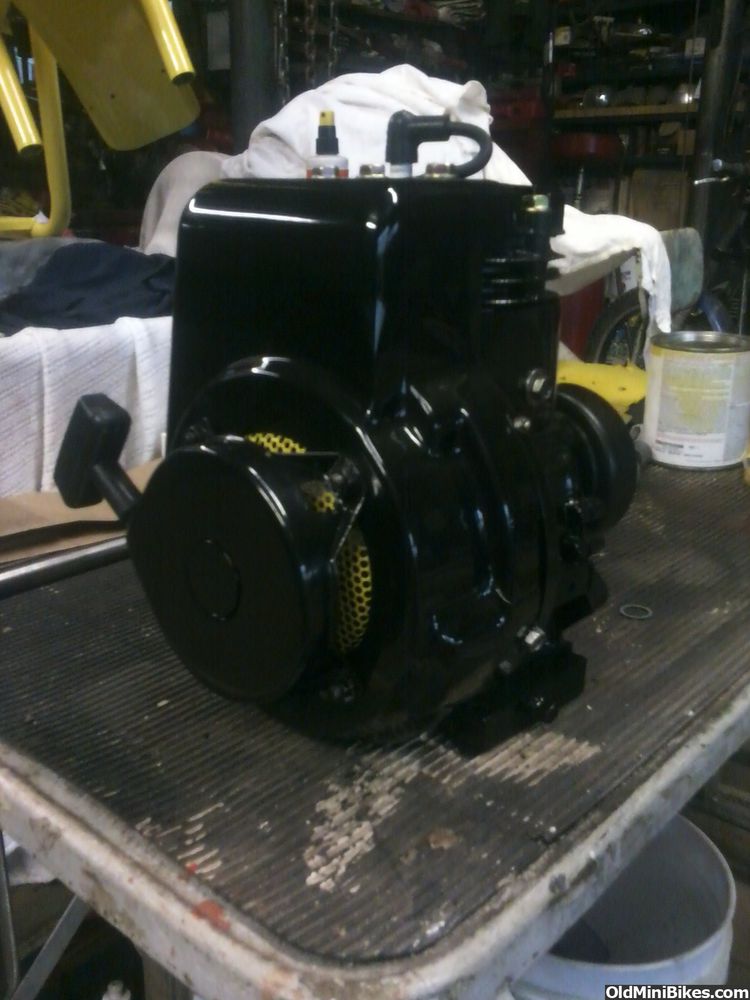

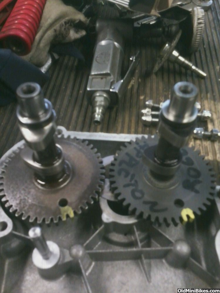

Just before painting It hit me I better put the cam and valves back in, so the valves were lapped in the cam installed and clearance set.
when I got the cam from Tim Isky I noticed the big difference between the stock one and the new one. I mocked things up with playdough in the head and there was not a lot of clearance there. The clearance on one of the valves had to be increased slightly to give a little more room under higher rpm.
