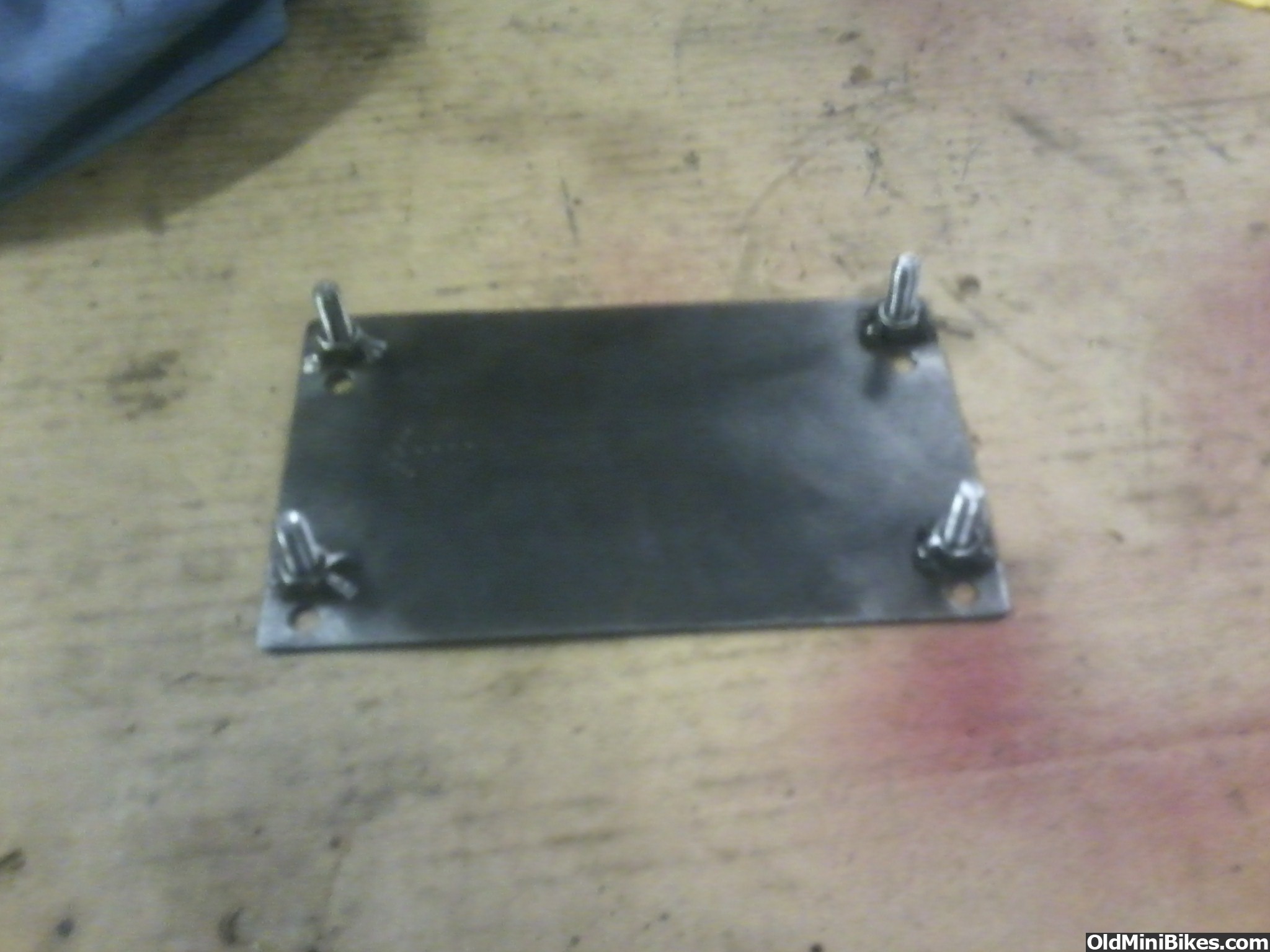

The mount I had fab to get the clutch and rear sprocket to line up.

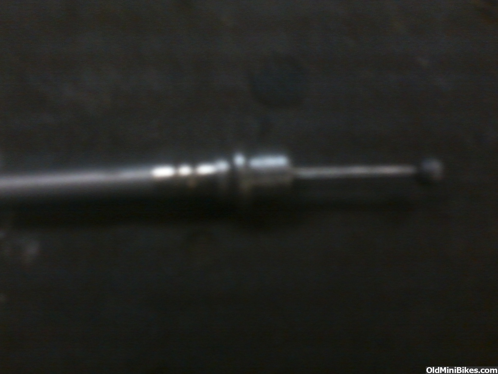

Had to make the adapter between throttle cable and mount.

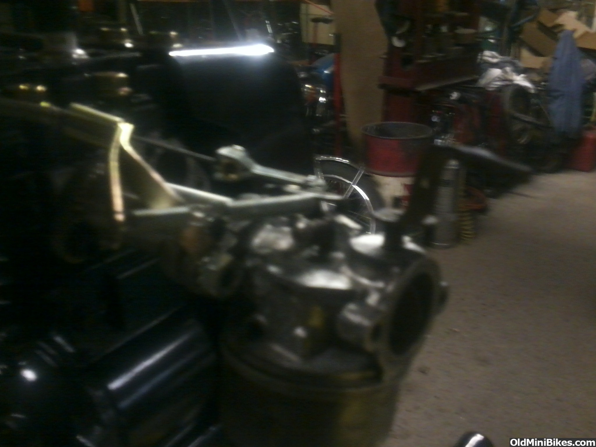

Here we are with the throttle hook up I engineered.
