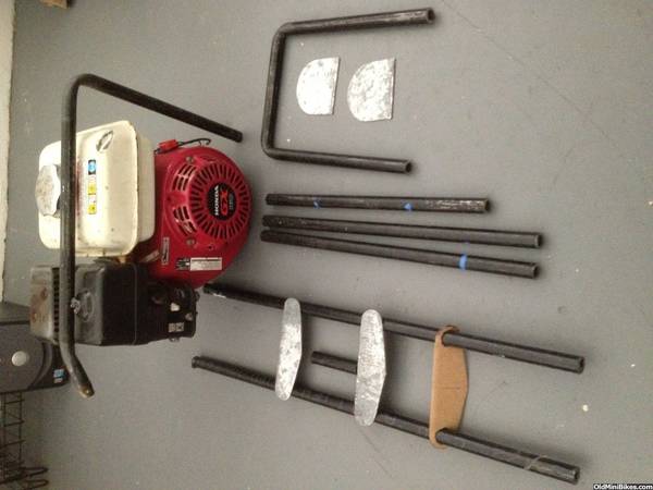

I have been working on the frame parts and putting together a parts list. I will be building the frame around a Honda GX160. Plan to use 4" wheels, 12 tooth clutch, and a 28 rear tooth drive. Brakes will be band brakes off the rear wheel assembly cause I will have to modify the crank to fit the clutch. This frame is made from 3/4" black water pipe really cool looking and very simple to build. I did make the triplates and rear wheel brackets out of some 1/8" steel plate. I will be using this as my welding course project so I will be completing this over a course of 1-2 months.
Heres a pic of where I am at:
What I'm building:
Project Start Date: 8/31/12
What I'm building:
