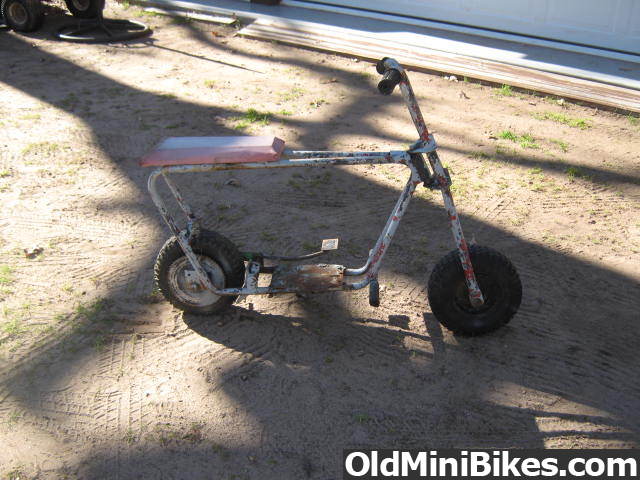

I have had this frame sitting at home for a few years now, and I believe now is the time to start working on it! I bought it as is from a co-worker for $50, who bought it from another coworker that was going to scrap it. I have ideas already, but would like to hear what the choir has to say.

Whichever you decide I have the correct wheels that fit the frame offset without spacers, a direct fit and the welded on sprocket is good. $65 shipped to your door. And the wheels will have no tires when they arrive, the ones on it are trash and you'll be glad I took em off. The rear wheel is on backwards in this picture. I've had several Wren/Runabouts and these are the best wheels I've gotten on any of em.

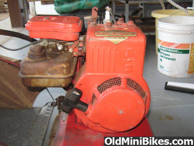

I also have a great running 1960 2.5hp briggs with embossed emblem on blower housing, it has a 3/4" shaft so it's a 2.5hp for sure and is on a working mower. I'd take it off and ship it to ya for $150 to your door.

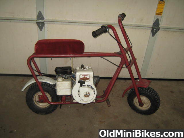

This was one of my Wrens, it now belongs to Tork620 a member here now since buying it and joining. It had it's original 2.5hp briggs that I still have and was sold with a 1972 rebuilt 2.5. I made a steel brake pad for it and also made a clutch cover not too unlike the original, it used the original mounting locations. Like I said I build riders, it was a really good one I hated to see go but I had to make room.
