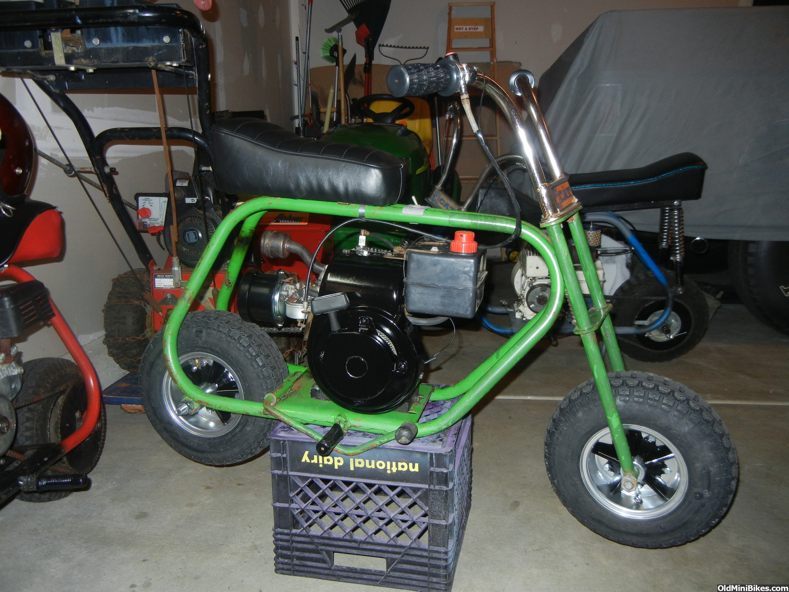

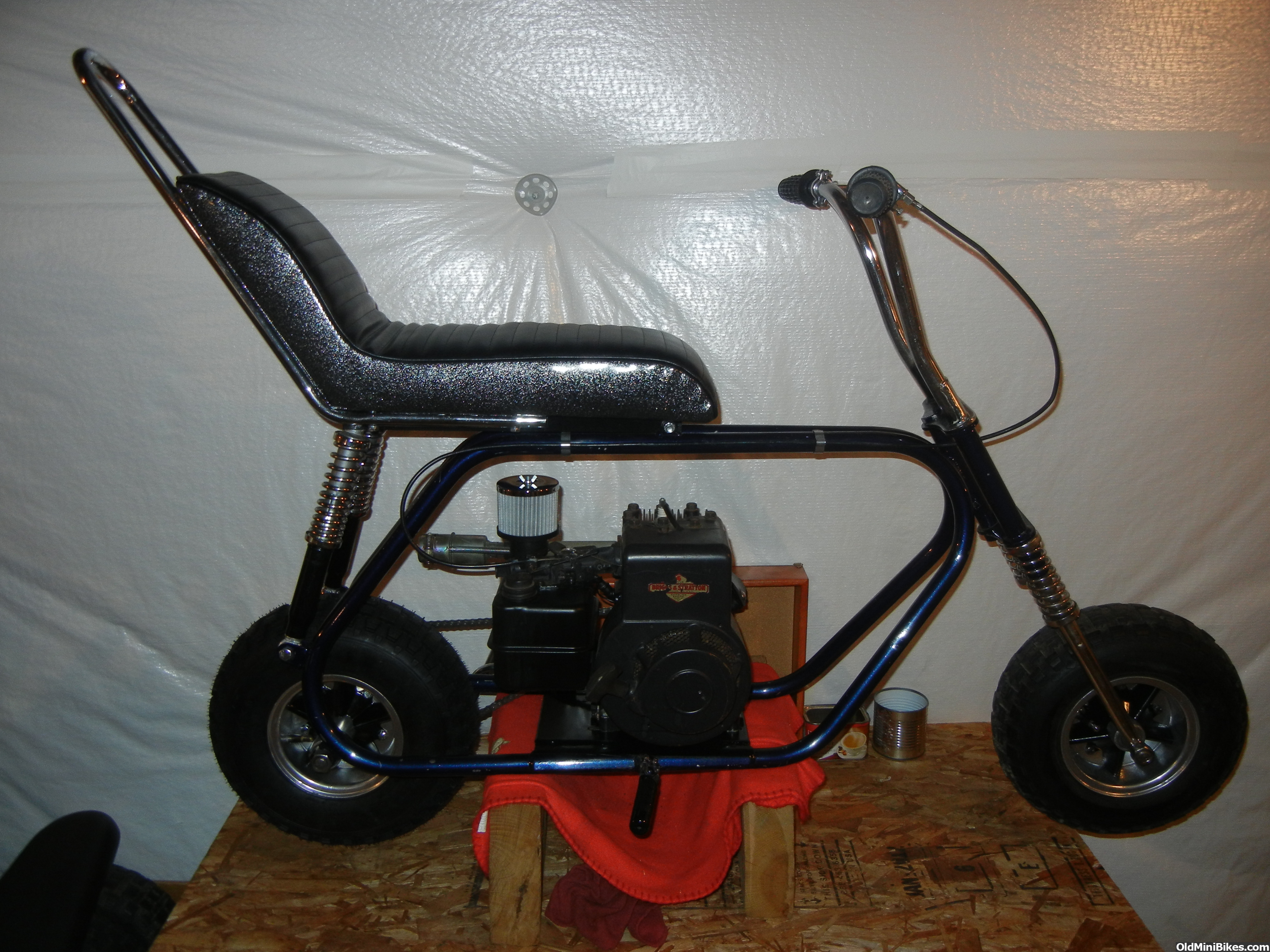

Milk crates for when I have them in the garage and a piece of plywood on sawhorses for when I'm working on them in the basement. Both ways will challenge your back though. :shrug:

Well, I have thought about your situation for several years now. I wanted to build a lift that would go almost flat to the ground and crank up and down so I could put about 3 or four of my minis on a shelf unit. I never built it. Sorry. I do use three milk crates screwed together with a plywood top. I still have to lift the bikes up, and that would not work for you. Please post what you come up with.

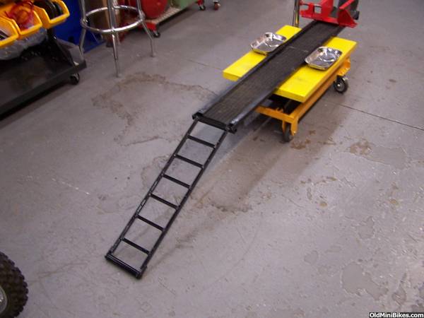

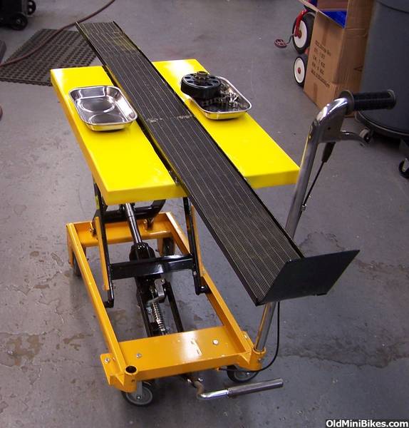

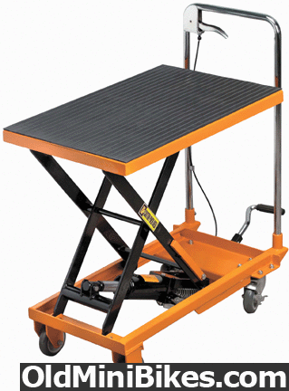

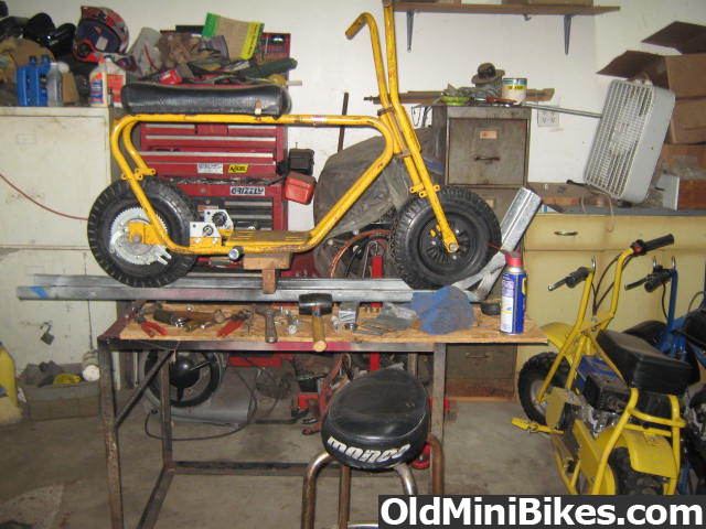

This one is not mine but they used to be sold at Harbor Freight.
That is mine, built in 2009. Trouble is, bikes should be on their wheels when worked on so you can R&R the motor.
So, I built this one and it is still my main minibike work lift. These are still at HF I believe.

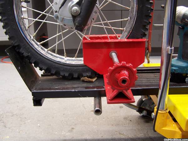

I added the following and this thing works perfectly! I use 2 tie-downs from the handlebars to the edge of the table, just as you would tie down in a truck or trailer. You can see one tie-down in the last picture.
I use my BendPak 10,000 lb Asymmetric twin post hoist for everything customers vehicles , my cars and my pickups , dump truck , John Deere 332 rider , mini bikes , three wheelers , gokarts you can pickup most anything with this lift and it is the best $2000.00 [new in 2004] I have spent :thumbsup:
I built a work table that I either lift or ramp the bikes onto, it has wheels so that if you tip it the thing will roll around. Took an edger base and welded it on one corner for engine testing and repair but also have a board that fits over the studs that I use as a work surface, I also clamped a small vise on it and plan a tool caddy for tools often used to be close by at all times.
