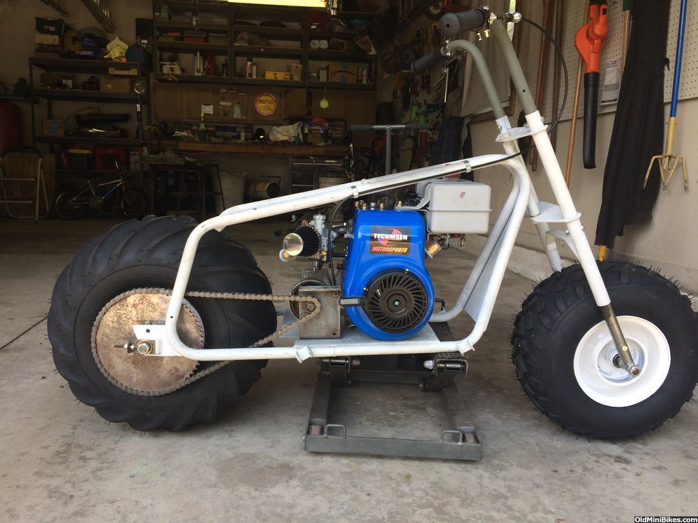

I have a NOS Tecumseh H50 motorsports engine and I put a Mikuni 22mm oval bore on it.
It gets to 6500 rpm and stutters .. if the throttle is cracked wide open it bogs down.
I have played with the stock jet by drilling it open and adjusting the clip on the pin.
I have tried it with and without exhaust, no change.
I just got a new UNI air filter and tried it with and without it today with no change.
So it seems the exhaust and the air filter are not restricting airflow.
I made the intake myself, its the same size as the carb and moror, 1". I don't think there is a vacuum leak in it.

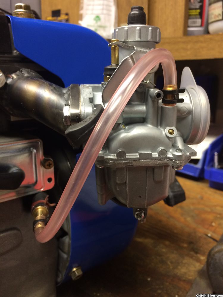

This pic shows the tank above the float bowl and the gas filter below the tank.
The gas line runs behind the blower housing next to the block like HS50's. Then it goes to a 1/4" 2-way brass barb that I took the barbs off one end to fit the smaller gas line the fits the mikuni carb.
This pic shows a spring I put around the gas line to keep it from kinking.

looks like the fuel line is pretty high compared to the tank. the lowest level
where fuel will flow out of the tank is highest spot in the gas line. not much
pressure to work with when things are that close. carplaylb is spot on.
