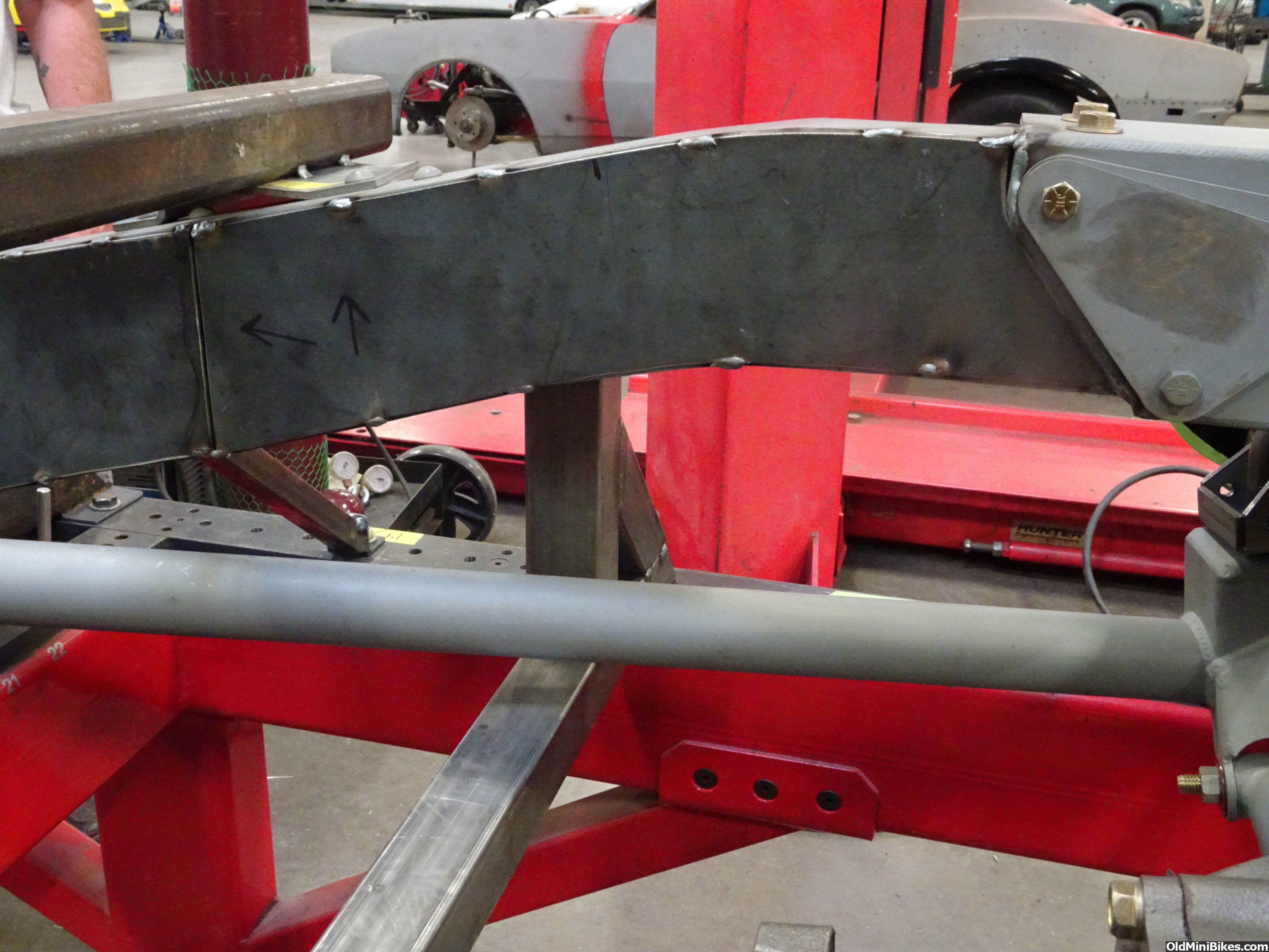

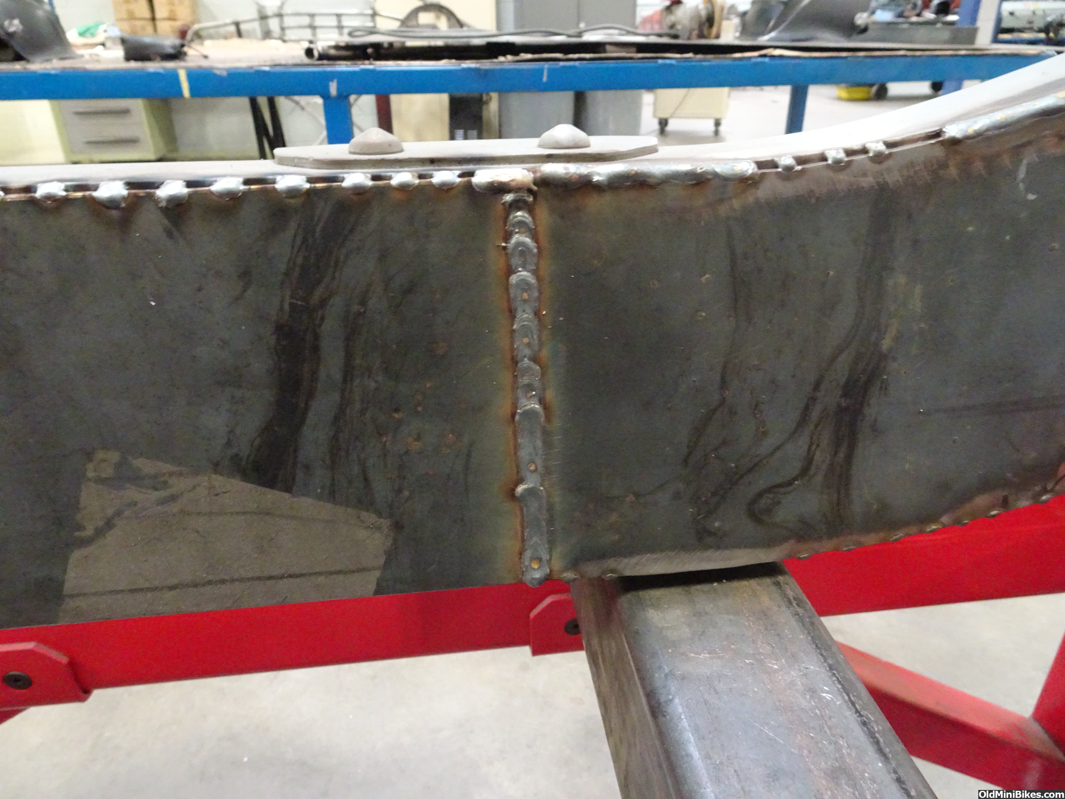

Here is a suggestion for set up. When you are welding a joint space it apart the width of the material thickness and move as soon as you start. This applies to 22 gauge or 1/8'' plate.
This is 1/8'' plate gapped and welded.
Just practice the same thing every time until you get better. You can buy small sheet metal pieces at Lowes, Home Depot, Tractor Supply and the like. We shear 3'' x 4'' 20 gauge coupons to practice on at school. If you can weld thin stuff without blowing holes then the thick stuff is easy.
Doug
lol..... The arrows were to indicate front and up..... We were fitting right and left boxing plates as we went.
