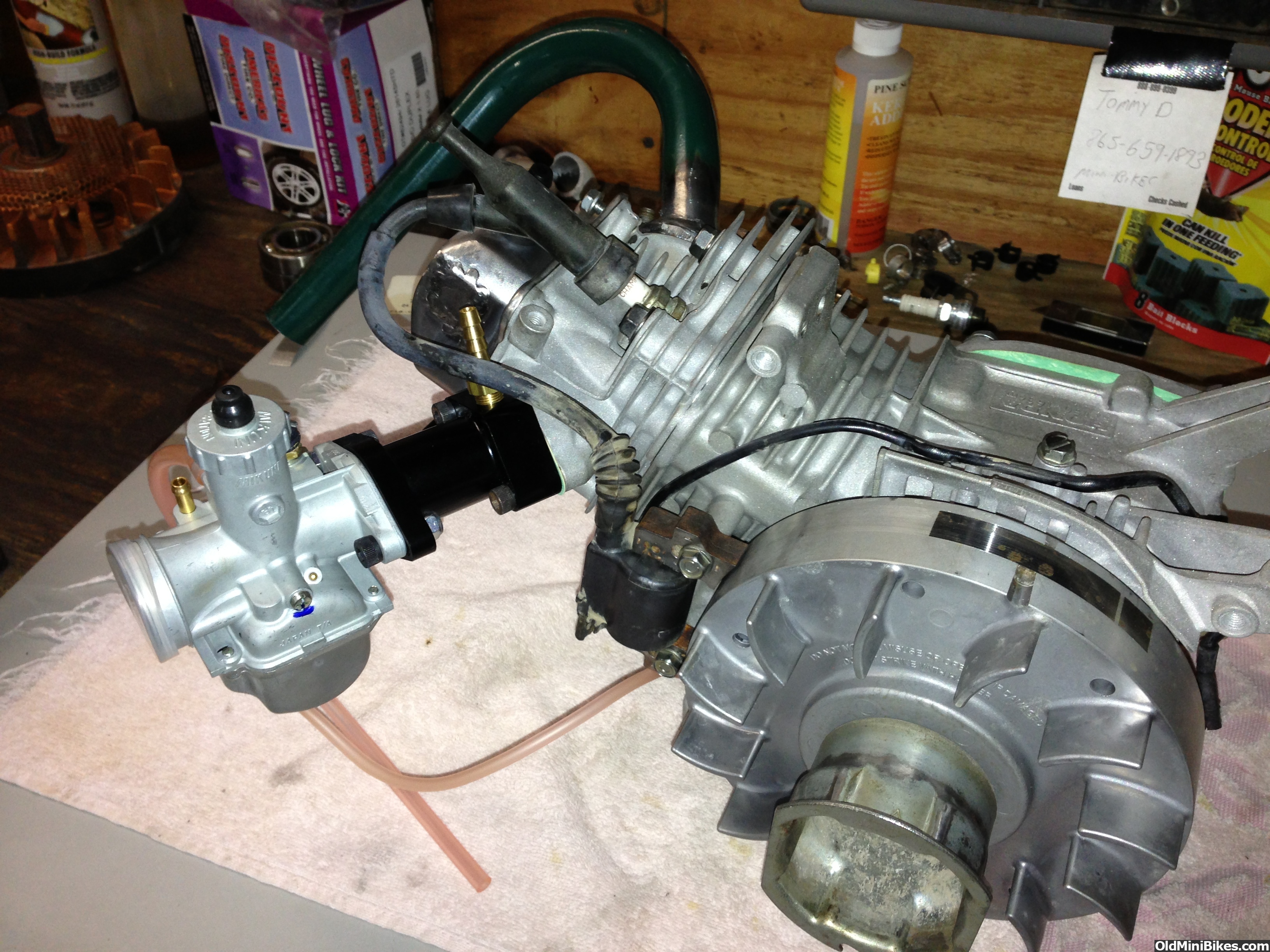

22mm mikuni Carb on Predator 212 hemi
How do I install this puppy? Carb came with some screws / bolts... Washers...
Can,any one give me some kind,of guide to installing carb on the head.

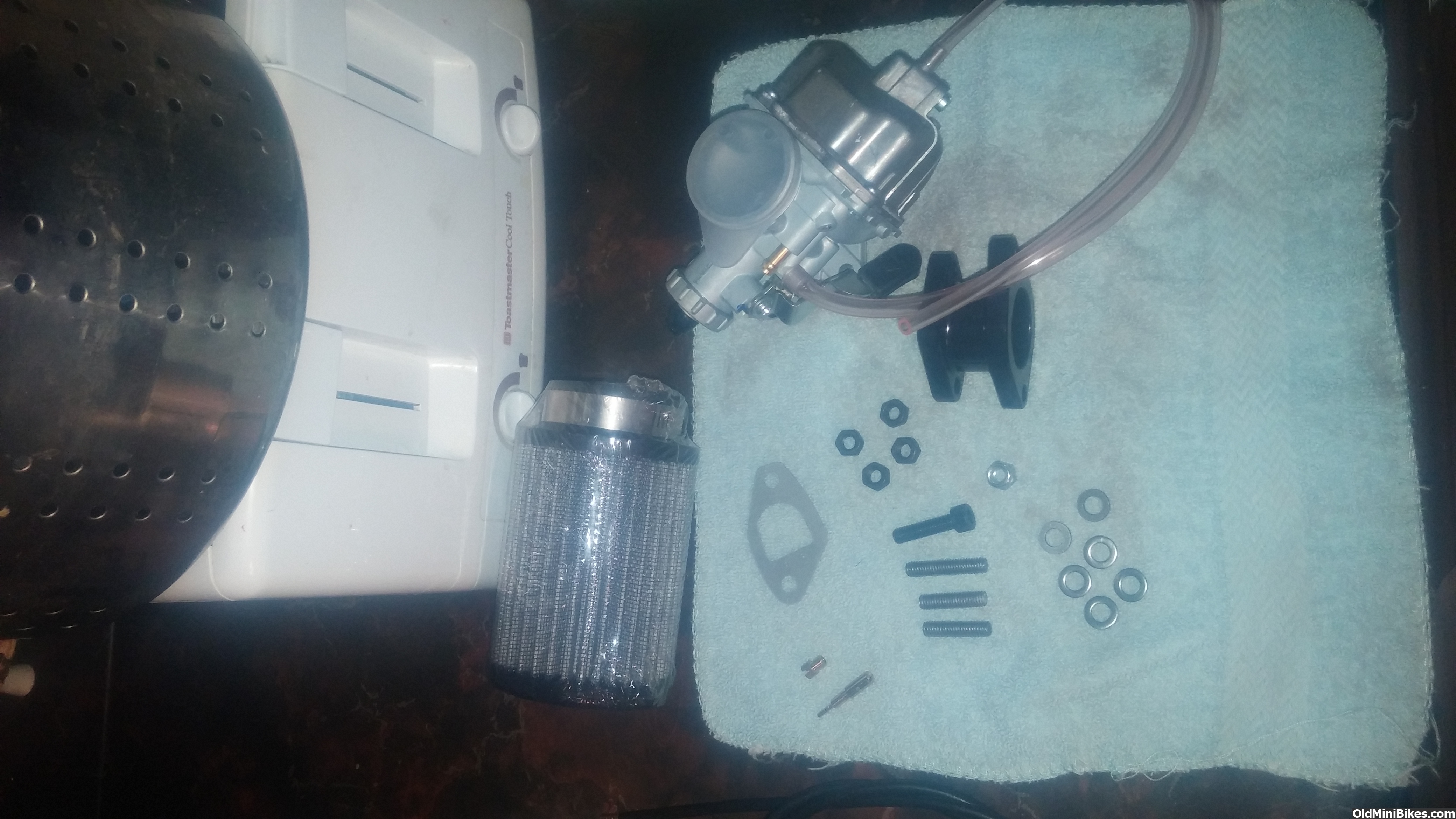

I have everything I would need to install
Your advice is appreciated

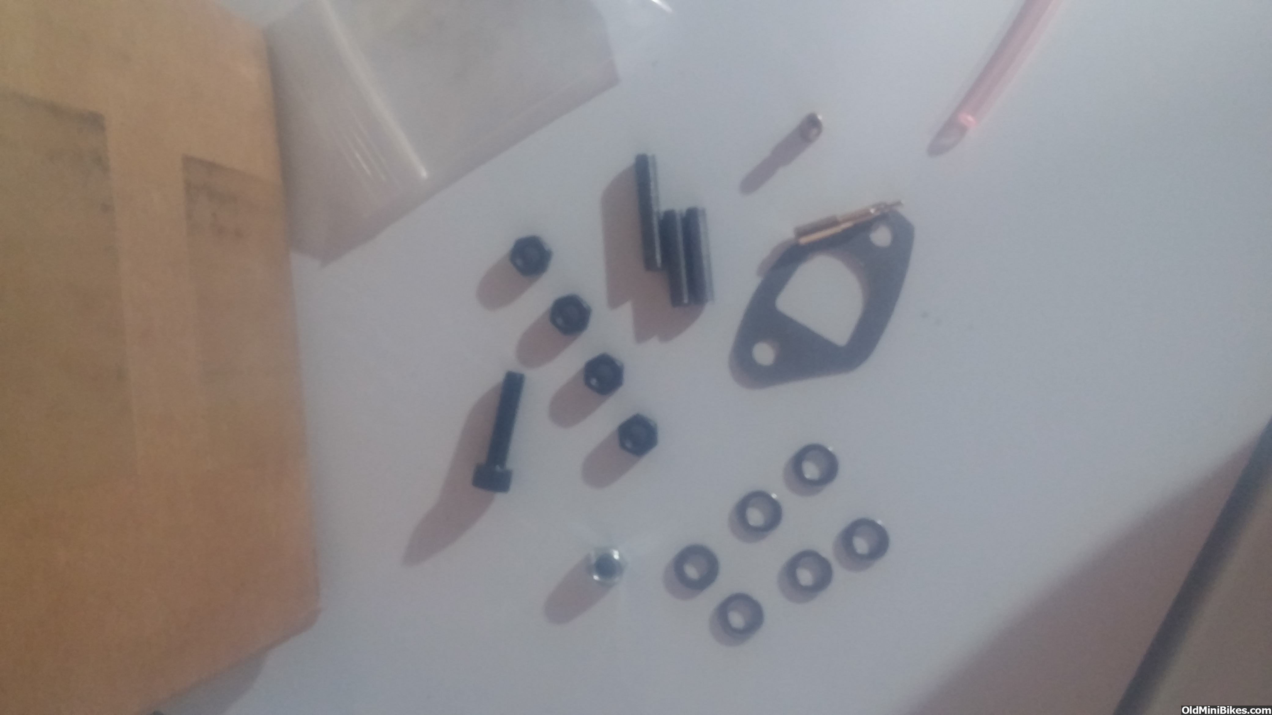

Witch bolts do I use and where do I use at.....
You know what I'm saying?
See the small allthread bolts

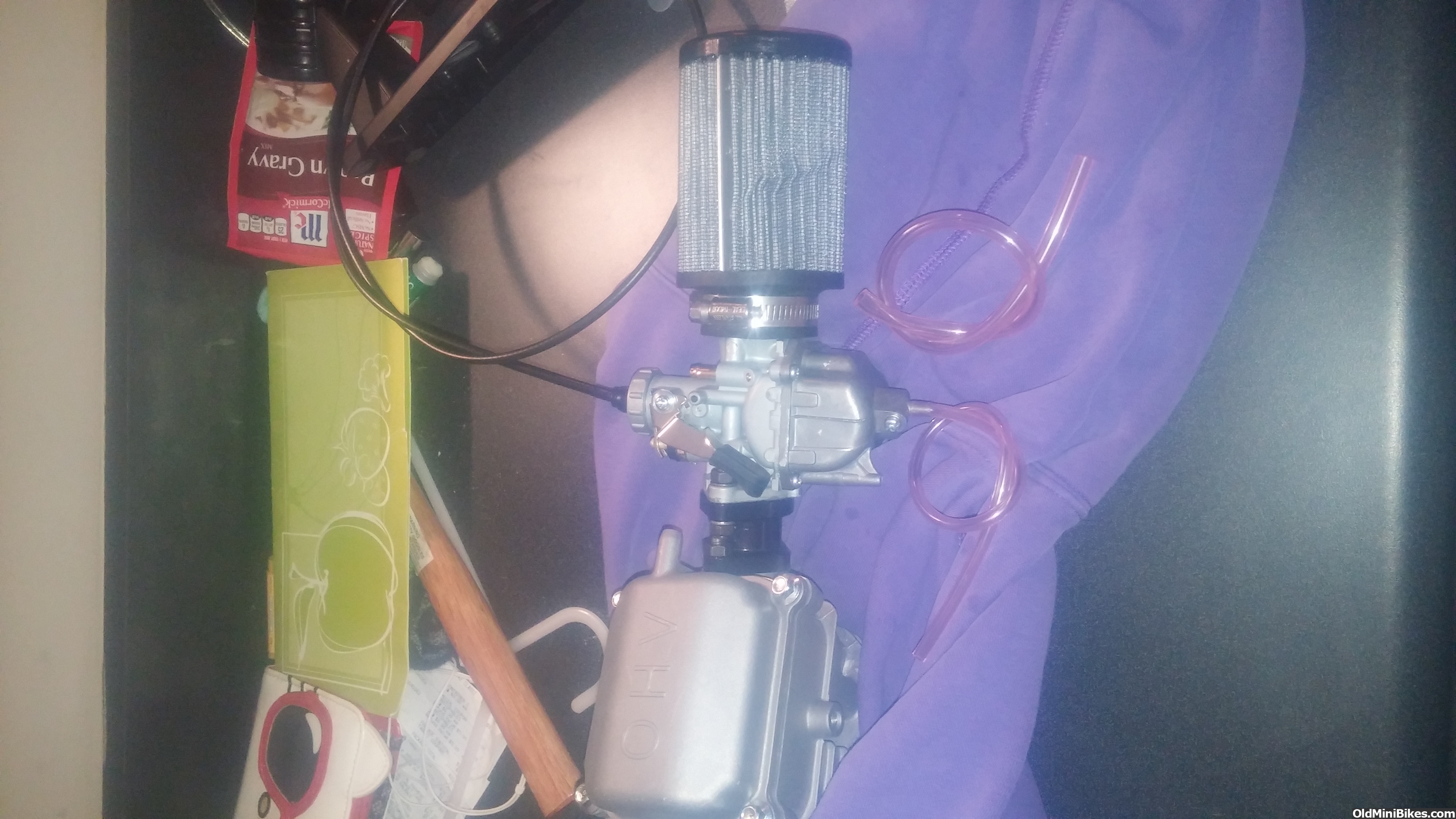

Also what do I do with the hoses...sorry first time using a mikuni
This is just a guess but the two shorter all threads manifold to carb , the bolt and longer all thread manifold to head . With that short of a manifold bolt the manifold to head first then carb to man .

Well the slide has to be picked all the way up . Is the slide installed right ? Make sure it is all the way down , it can be put in backward so check and see .
