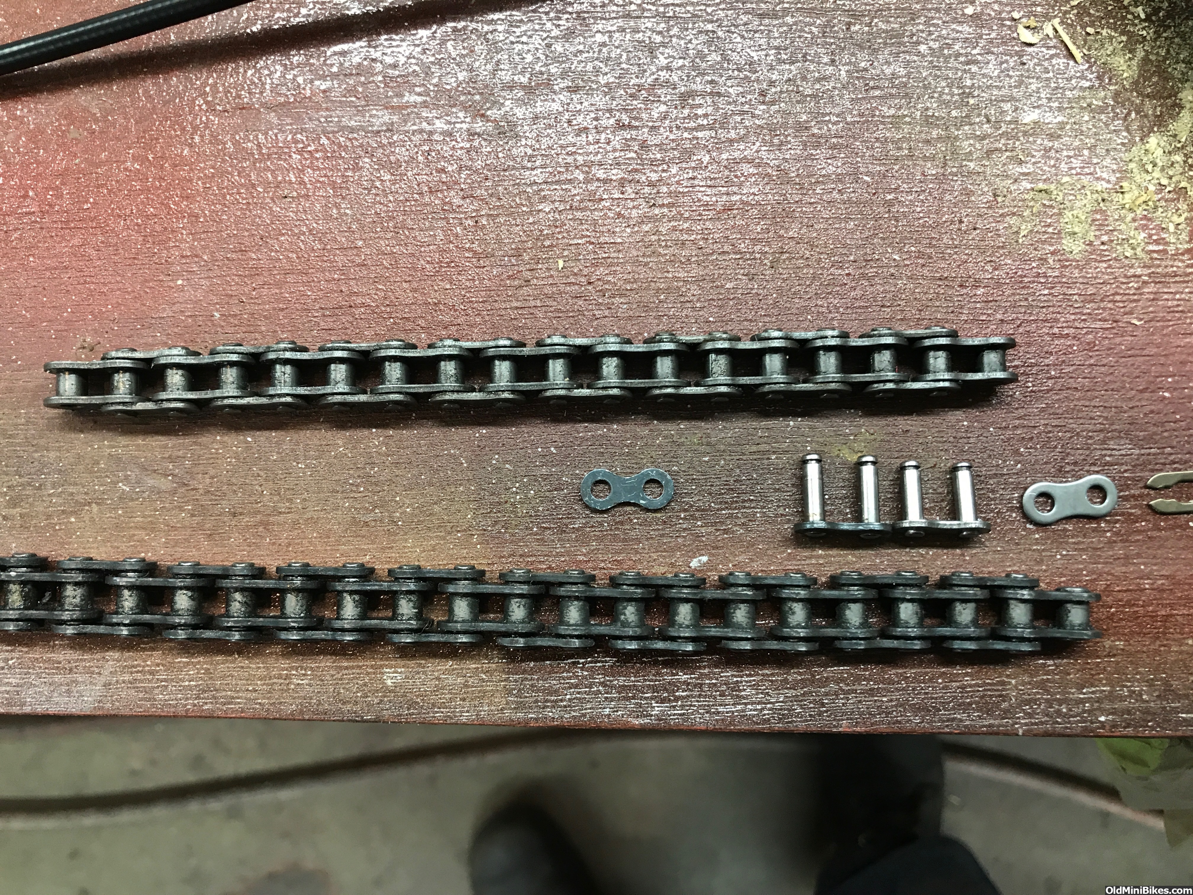

I'm working on a Manco T-Bird with a 6.5 hp Predator. Regular clutch on the engine to a rear sprocket. 5.5:1 gear ratio.
The bike has a lot of acceleration and power. The new #35 chain I just put on snapped in about 5 minutes of riding.
I looked at it and it says China and 35. So yeah, cheap stuff.
I dug out an old chain and noticed it was wider than the China stuff I just broke AND wider than some other 35 chain I have on a couple 10 hp mini's with torque converters and no breakage.
Look at this picture. You can clearly see one chain is wider and stronger. It takes a longer Master link too.
What kind of chain is the wider one shown on the bottom? Where can I get some more and some longer master links for it?
I want to buy some strong #35 chain so I don't break it again. The mini bike has a clutch band brake that works great. When the chain broke all I had was the scrub brake that was useless because the tire was wet. I'm glad I wasn't going very fast when it snapped...

The EK silver is also good chain. Once you use the EK, or the RLV, you'll wonder why you ever did. Both are indeed wider than the cheap chain. The width difference occurs at the bearing flanges on the chain. However the standard #35 tool works fine. They come with ML's, although I've about quit using them. You will not find a half link for them, or at least I couldn't.
You should not have snapped "any" #35 chain with your power, unless it was defective. But you'll find smoother operation, and less stretch in the better grade chain, and now I realize why you were mentioning chain stretch in my thread. It is minimal with quality chain.

Thanks guys! I bought some RLV Gold on Gold. NRRacing.com sells it by the foot. I needed 55" so I got 5' @ $5.29 per. Cheaper than buying two 40" pieces elsewhere. I have enough "stuff" laying around now. I'm trying not to over buy things for "spares".
