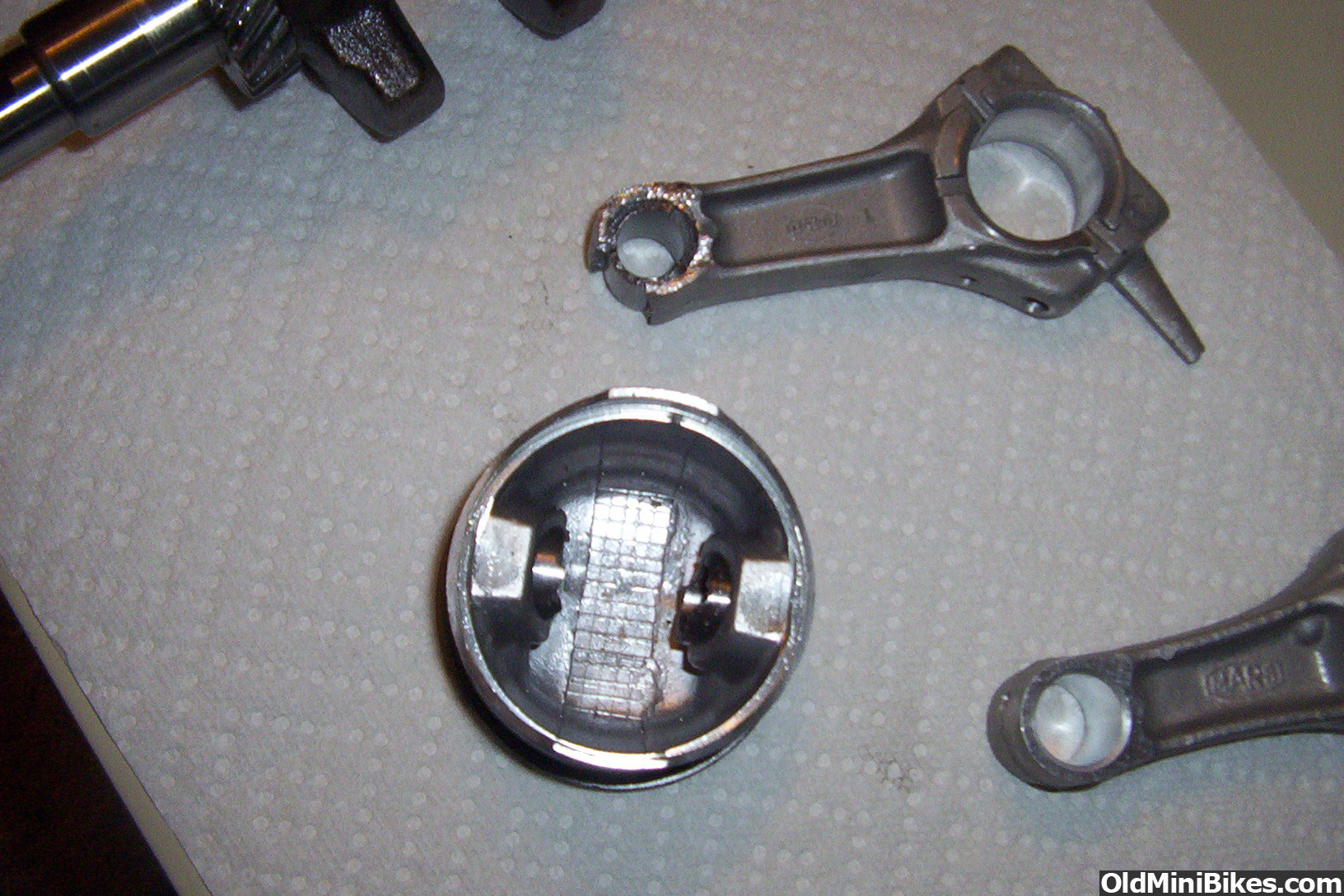

Small big valve head 28.5mm intake, 26mm exhaust, dual springs
Fully ported and polish, head is in my photos

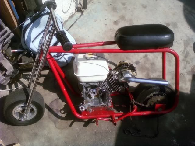

My old .306" lift MMS cam with HD Parsons 1.12 rockers
HL348 alky tillotson carb, EC intake, port matched

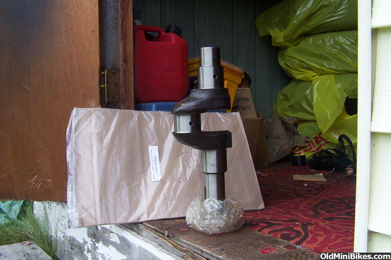

Billet rod, flat top piston, billet adjustable ARC flywheel 34 degrees.
The motor was running real good, it even won a little money for the owner 2 weeks ago. I'm guessing saying that it makes about 20hp. It does about 78-80mph with the 120 guy on it.
