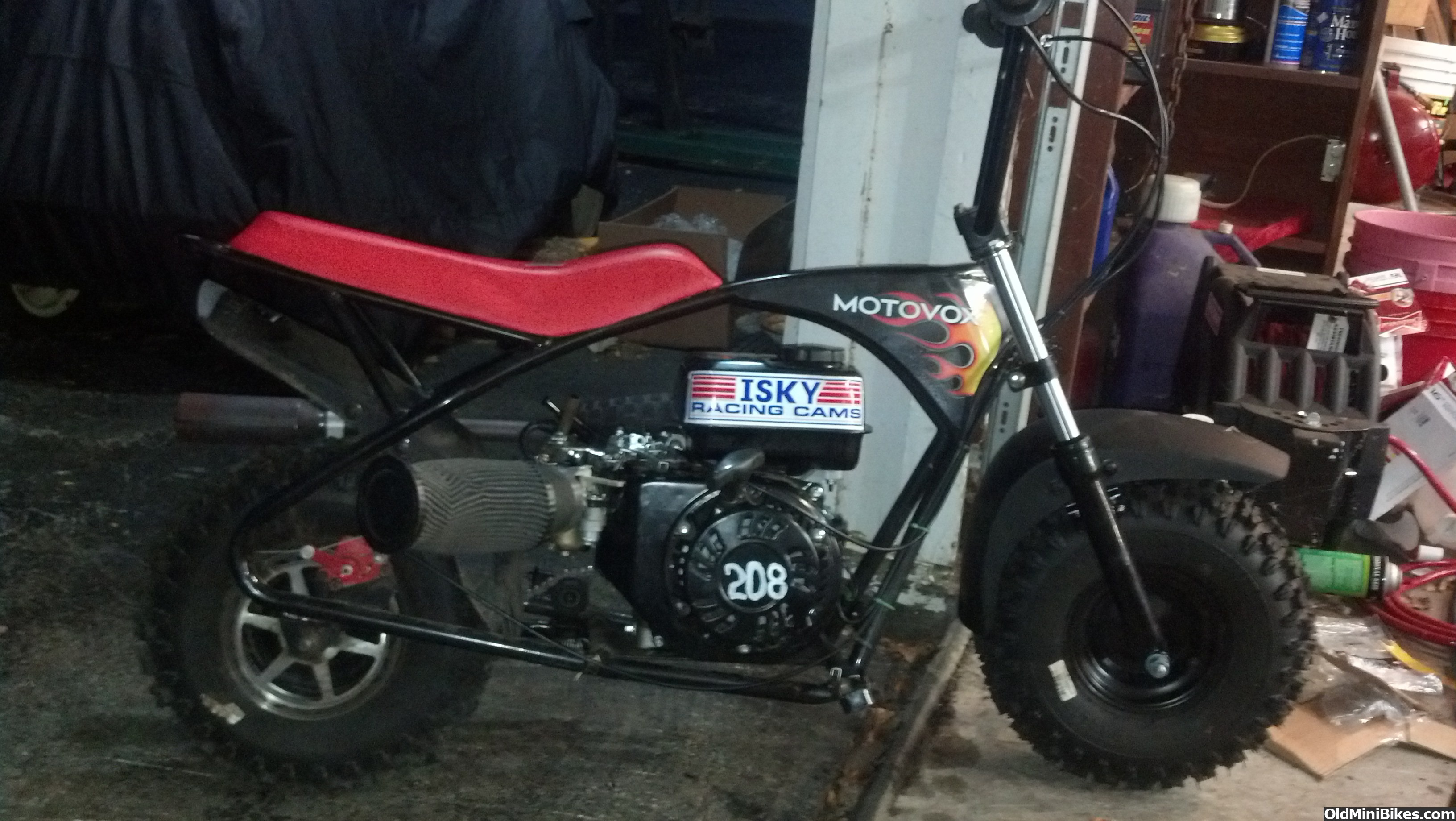

I really like my motovox. I put started out just drilling the engine bolt pattern in the engine plate(no adaptor plate) for a predator and with a shotgun header and open air filter and 12/75 gearing it would do 38 mph with lots of torque. I then added the mbx 11 forks which really helped the handling in the rough off road terrian. I bought a refurbished rolling chassis for $150, predator $100, header and air filter $80 and tires $50. For less than $400 I have a real decent minibike.....
But then I built an 8000rpm 208cc predator and turned it into a real quick minibike. I have it geared with a high ratio 11/75 and it will still hit 50mph and will break the rear tire loose and wheelie pretty much anytime you want. Super fun! And so far unbeatable around my yard race track.haha
Here is a picture of my vox.

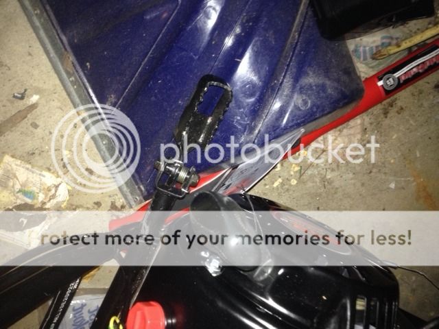

Trip to the local hardware store for two 3/4" ID washers, plus Lowe's-sourced clutch bolt and washer, equals success:

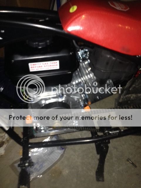

Tight fit between the engine cowling and footpeg...have to see how comfortable this is when riding. Messy background is due to wheeling the bike into the garage and then deciding to do photos as an afterthought.
Exhaust was originally bashed with a sledgehammer, then removed to fit in the frame. It was reattached after the engine was mounted, with room to spare. Yes, this will be replaced with a real pipe sometime before next spring.

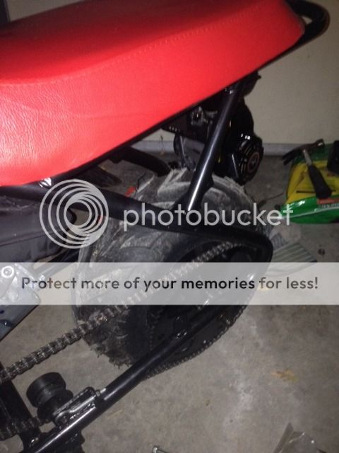

Clean rear end with no plastics for the moment. I know I routed the chain wrong and under the tensioner, have to redo that tomorrow. Anyone want a nice, near-new stock engine for free? It's luring in the background here.
Overall a nice fit, I am pleased. Thanks to all of you!!!

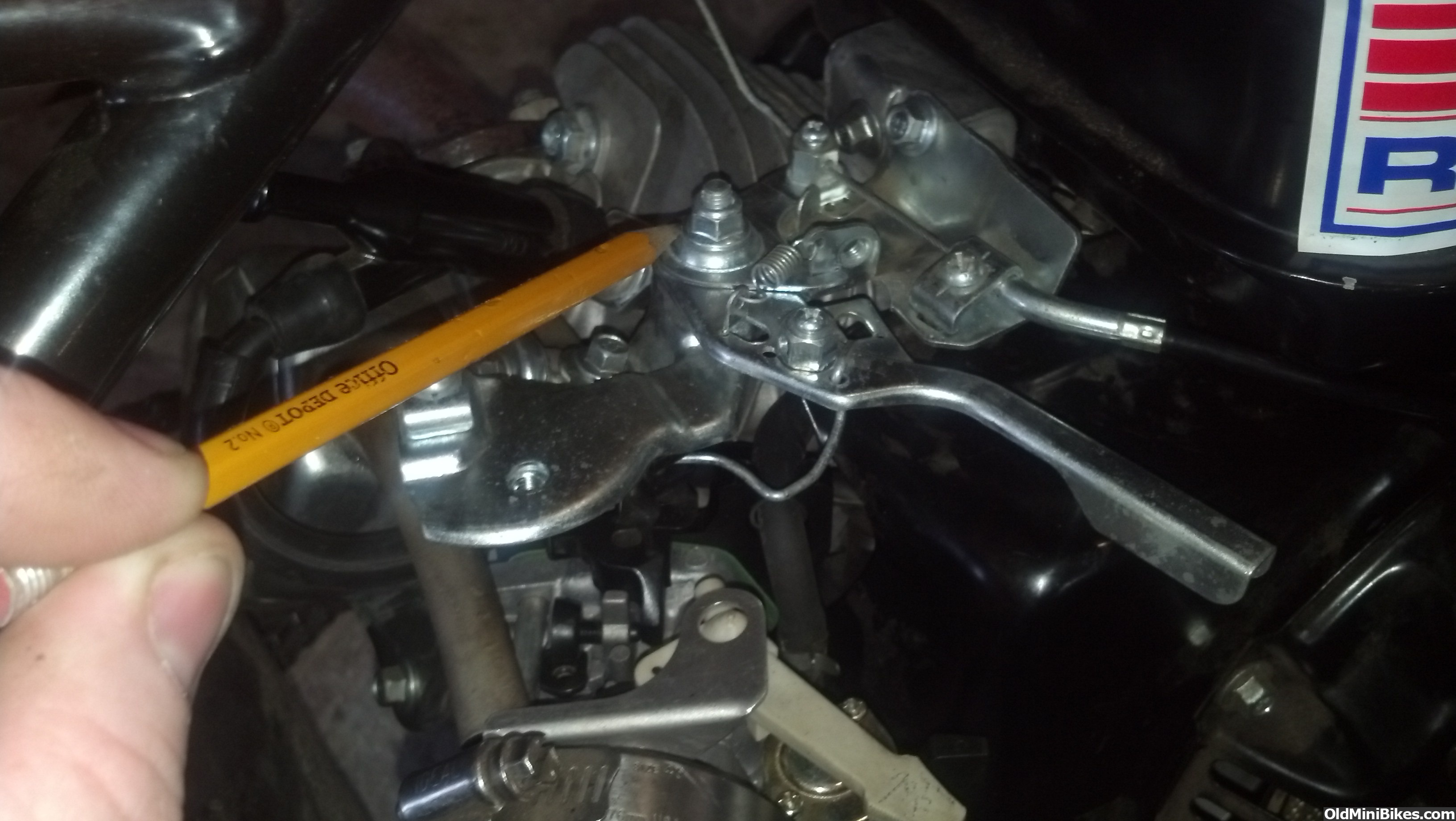

As far as the throttle lever, you need to loosen the nut on the pivot stud so the lever can move freely and return to slow idle with a light return spring.
Here's a picture of how I setup my throttle using the original motovox twist throttle and cable.
I have a pencil pointing at the nut you have to loosen up so your throttle works freely.
Hope I could help.

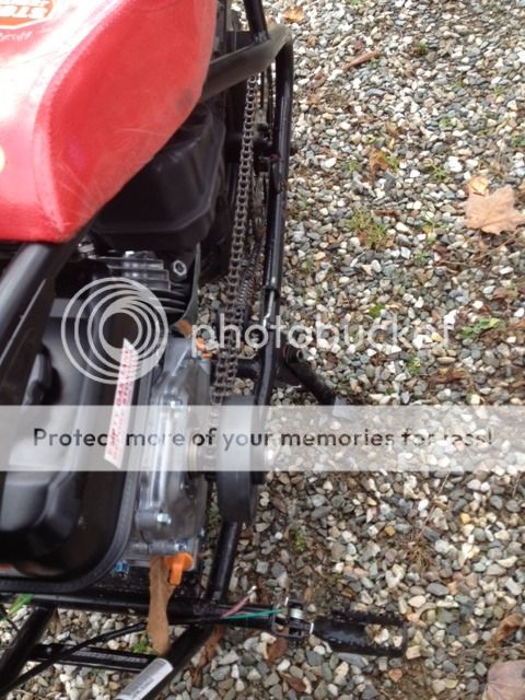

I am guessing that the chain really stretched during that first ride, as I had almost zero time on the chain with the OEM engine. I put a master link in, still found that the chain fit sloppy, then lo and behold it was finally slack enough to properly route around the tensioner. Now she drives beautifully and the chain is great!
Chain's path appears to be nearly perfectly-straight to the naked eye.

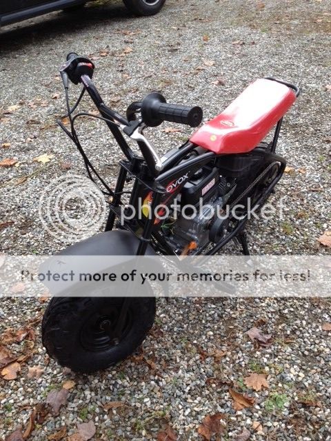

Near future plans: proper chain guard, redo rear plastics, proper or new air box, better exhaust.
Here are some photos from today:
