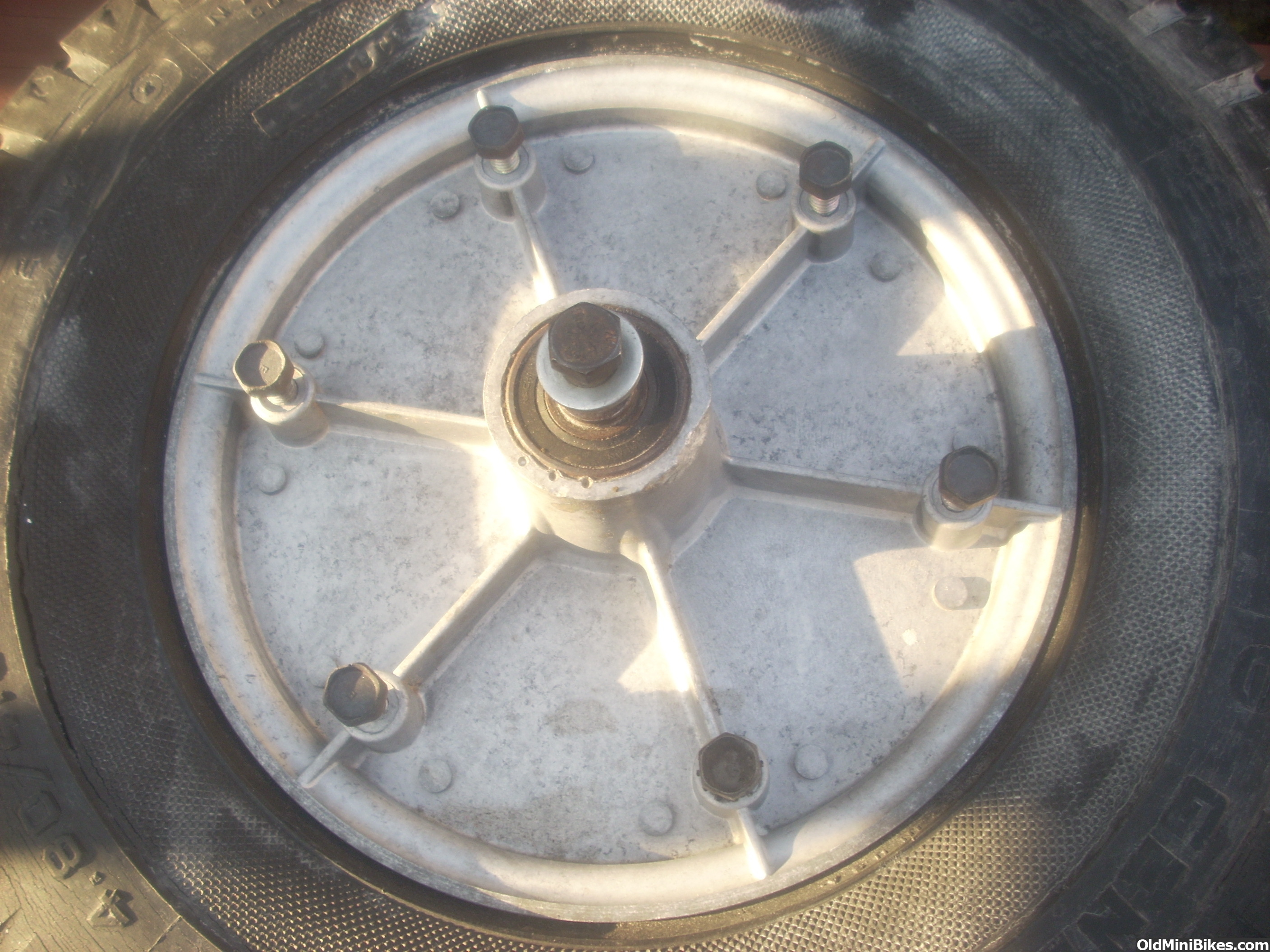

i tried this setup on a set of powell aluminum wheel halves. i have a big ind. compressor. the air nozzle from H.F. doesnt pass enough air thru it. i switched to an old air nozzle i had with that blew a lot more air,worked much better.the 7/16th plastic tube need to have something on it to adjust the amount of soda coming thru it. this setup needs more air and less soda but it did do a decent
job. make sure you clean the crud off your parts real good before blasting
