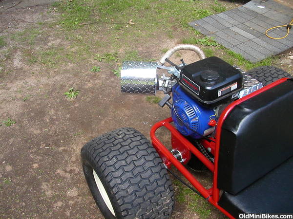

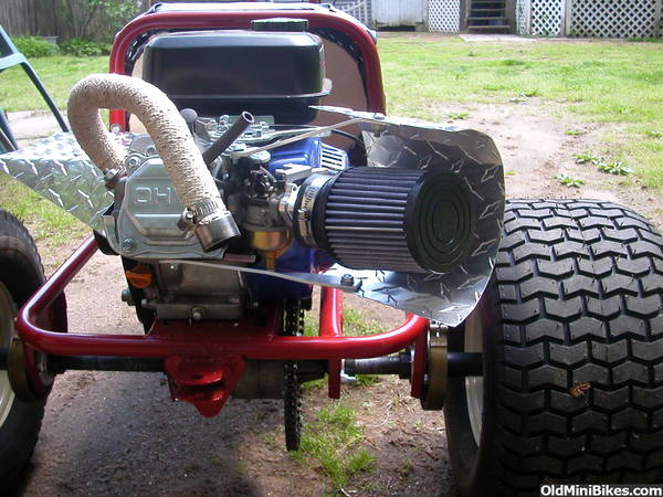

With that said, I ran my clone motor all weekend at windber without one, and just occasionally removed some of the heavier clumps of mud off the air filter....
It depends on how much water. A little water is actually good for it. It'll decarbon the head and valves. It will run cooler and prevent detonation. Too much water will possibly contaminate the oil, or even short the ignition. Or worst case, hydrolock the engine and bend the rod or valves.
