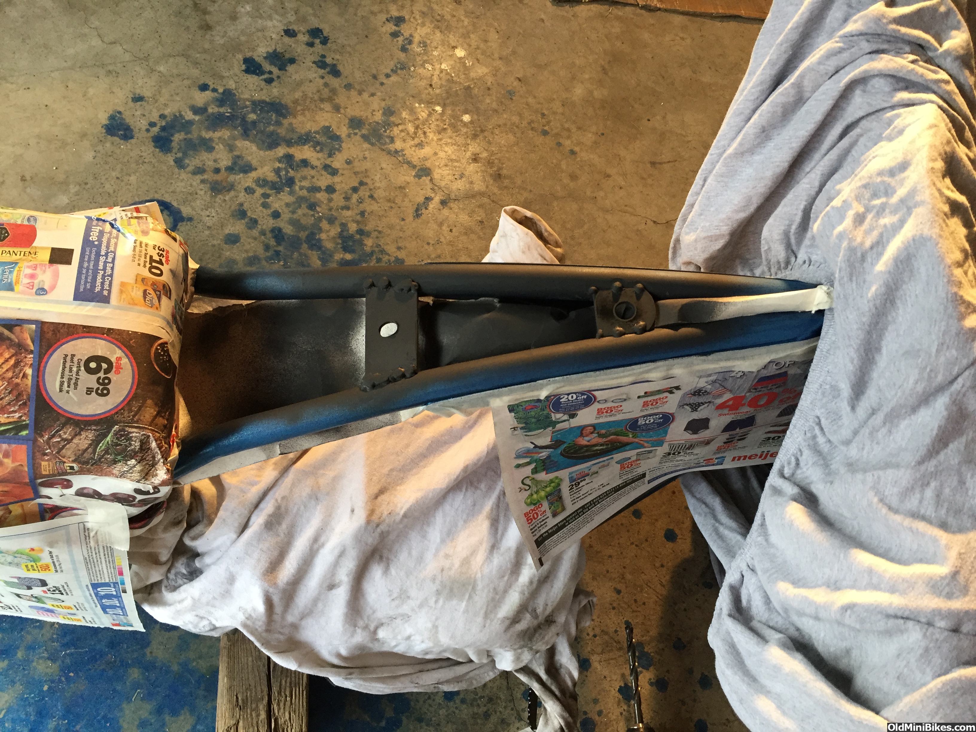

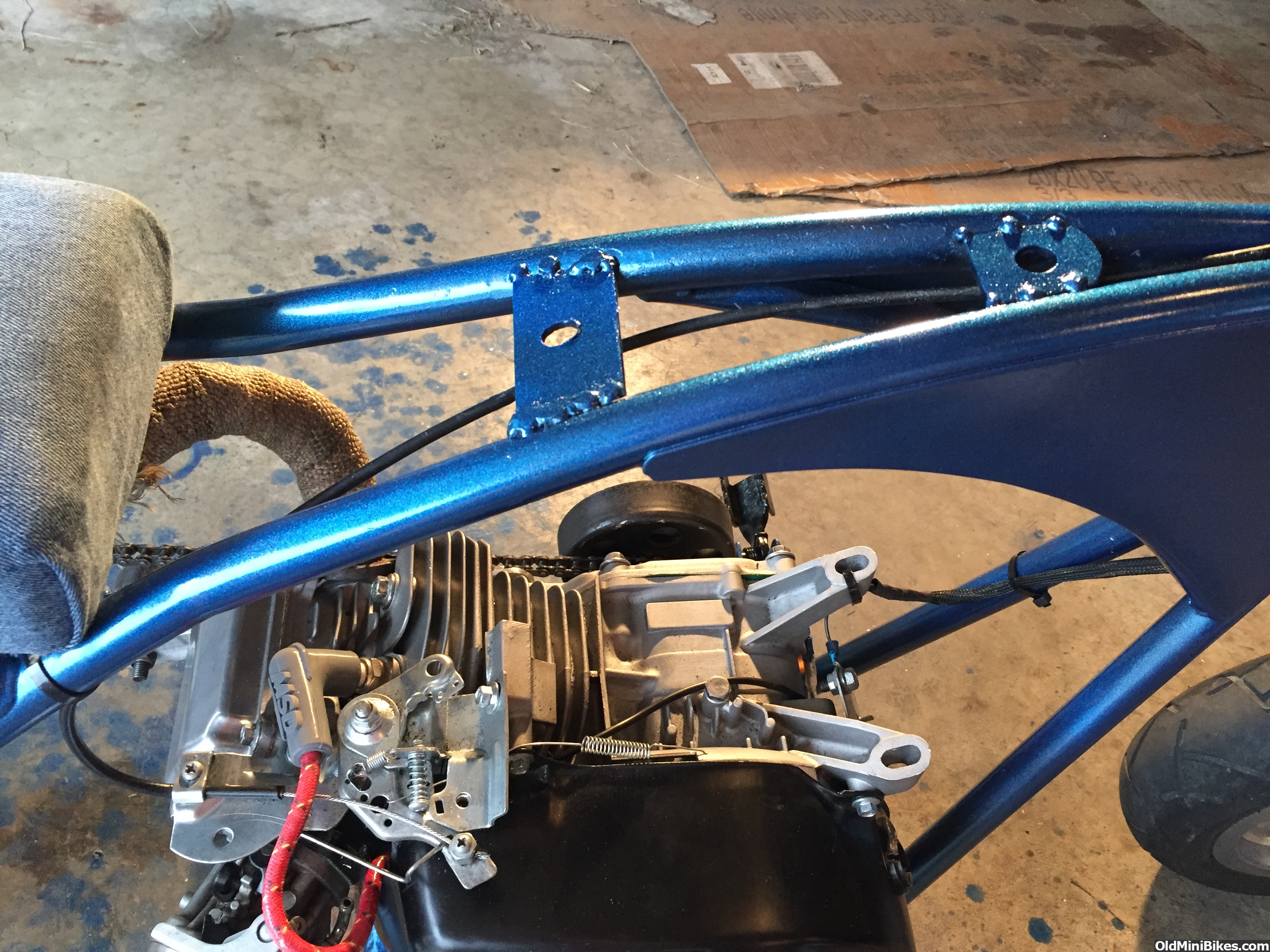

I have fitted a proper gas tank mount! Sucks that I had to weld on it after having painted, but I taped it off and redid the paint on just the top rails. I think it turned out pretty good! I bought some rubber bushings too. I should have the tank remounted tonight and take another test run.

One thing I bought a long time ago that really helps is a heavy duty welding blanket. Double fold it and put it on top of that motor and sparks won’t get to it. This is one reason I left my bike in primer lol having to go back and weld on the frame. In fact I had to go back and weld on gas tank bracket myself same as you. And also notch one of the upper bars for spark plug.

Love the blue paint, moetrout ! :thumbsup:
What's the brand & color description by chance ??
Pretty much the color I have planned for on my MM80 frame.

It's a pocket bike wheel and tire that was on the bike when I bought it. I'll take a look at it tonight when I get home and post the details.
