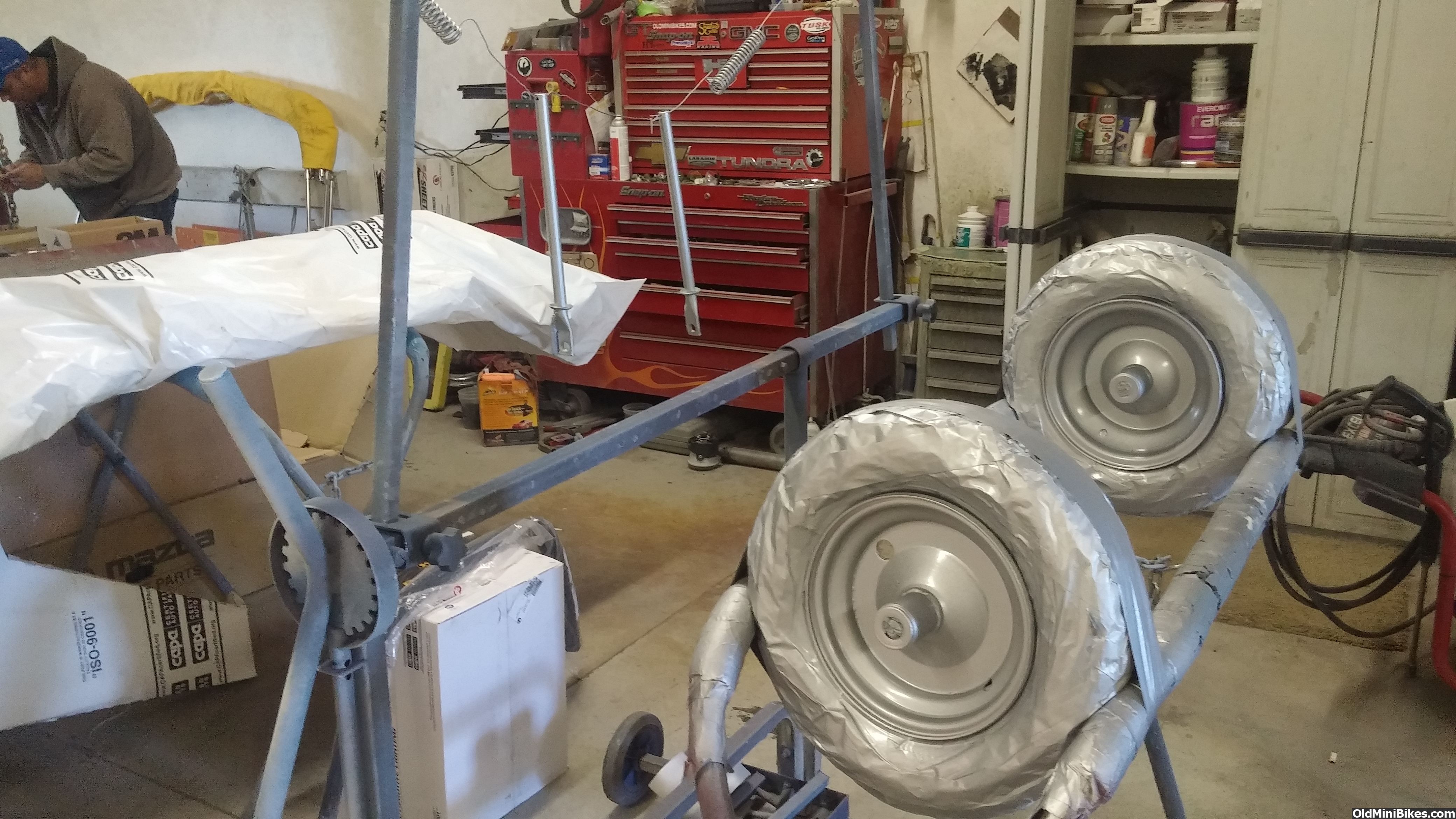

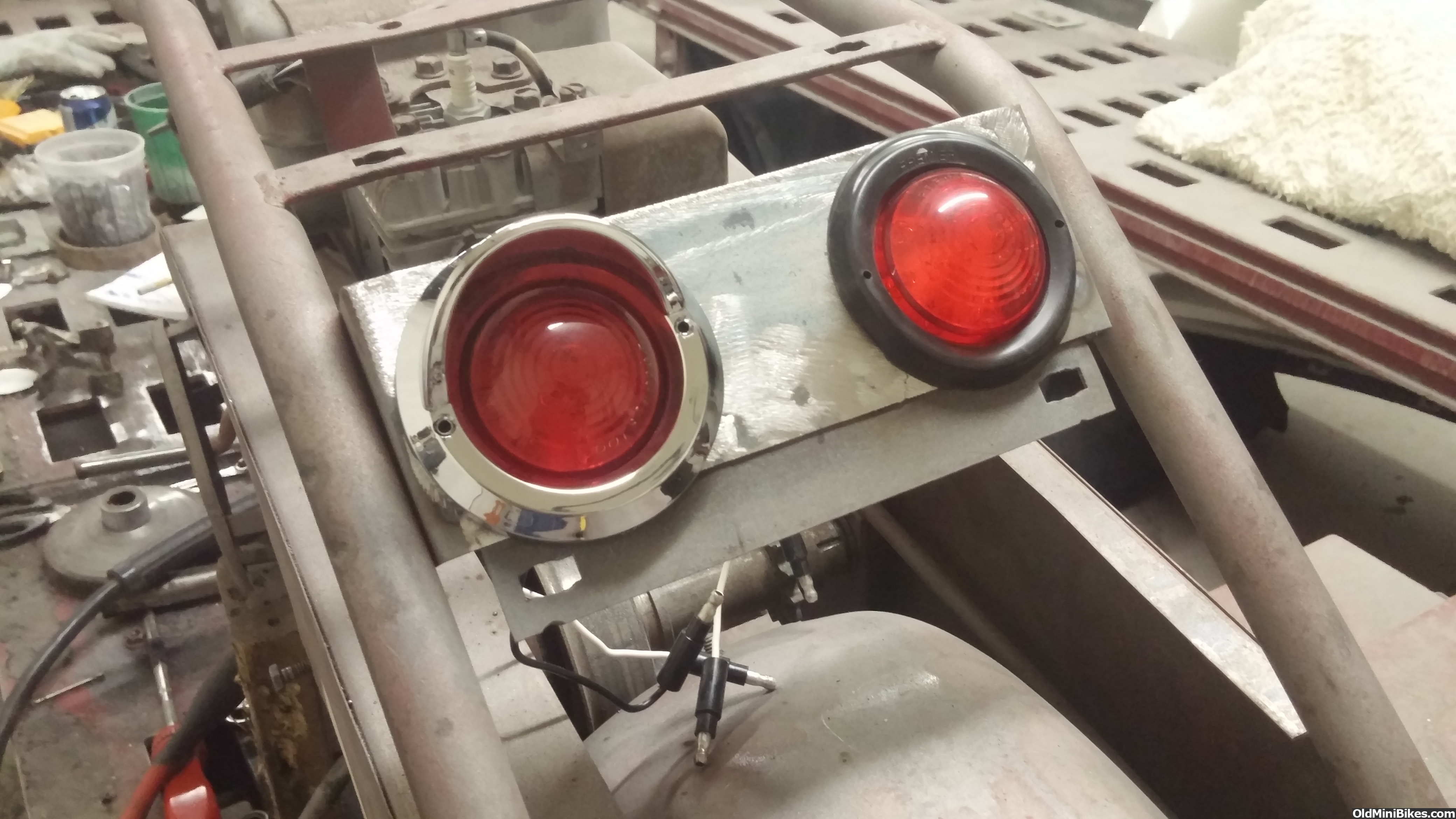

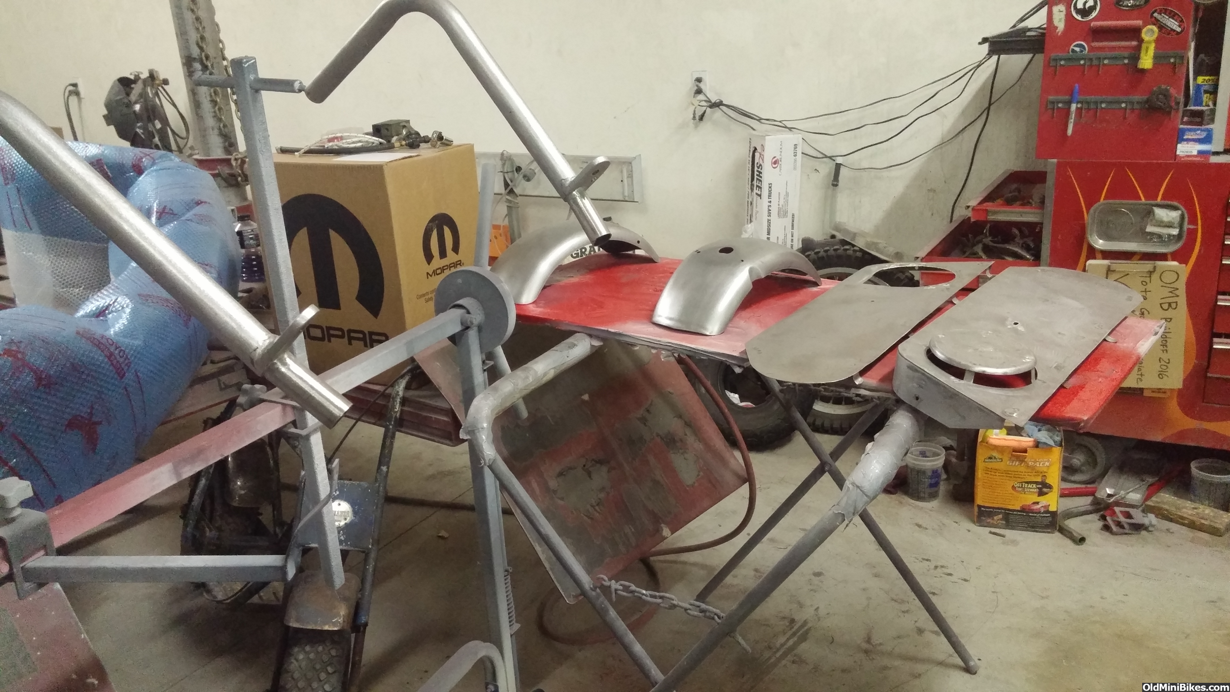

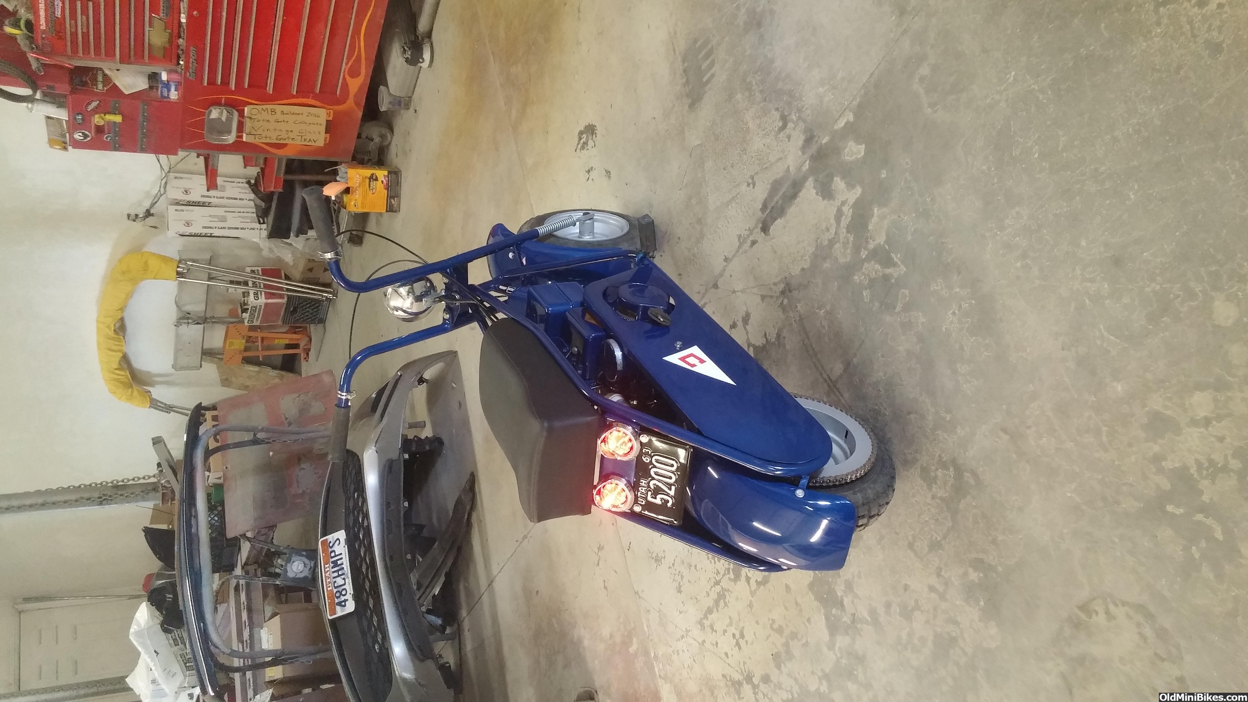

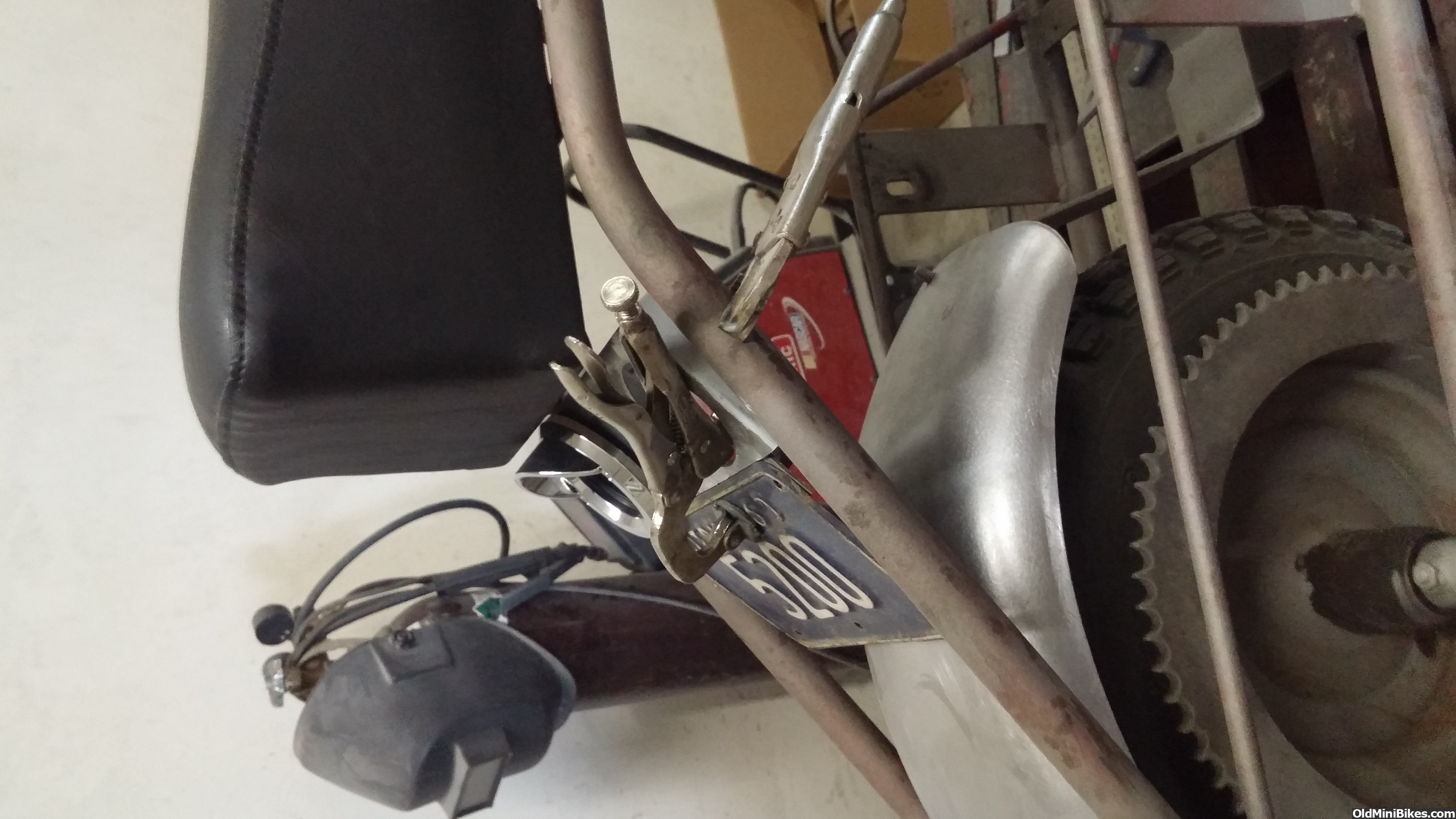

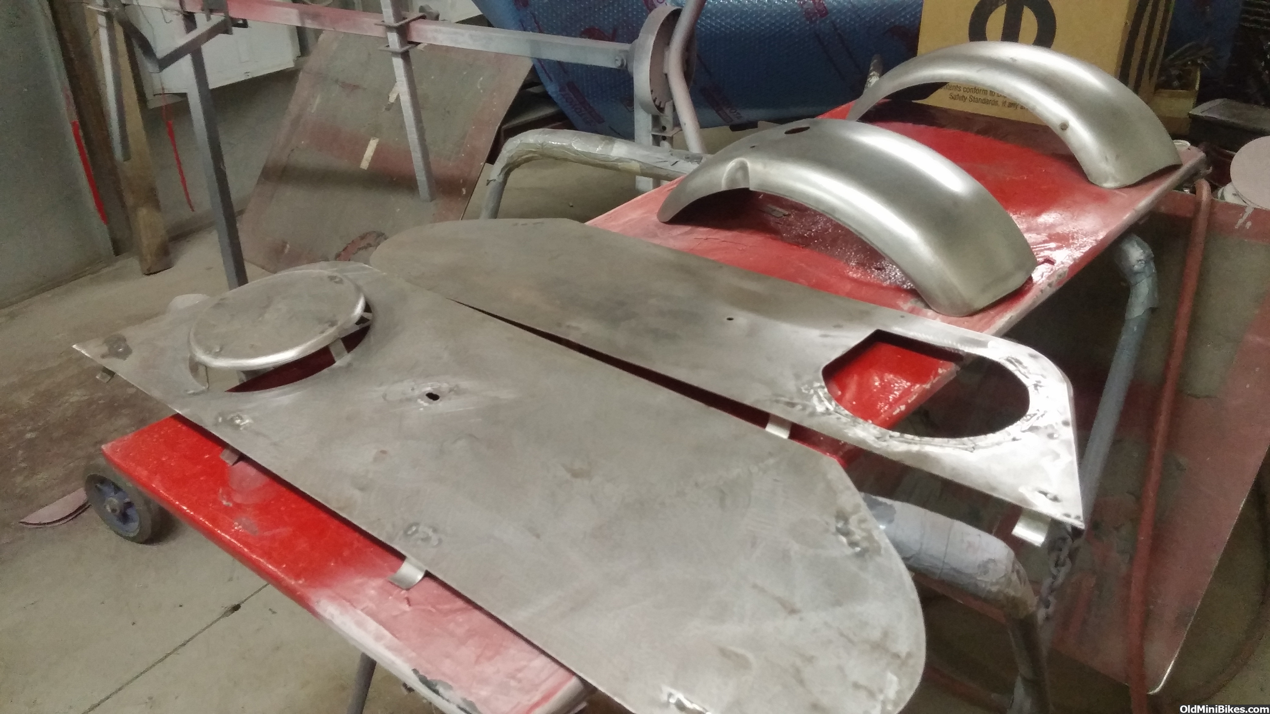

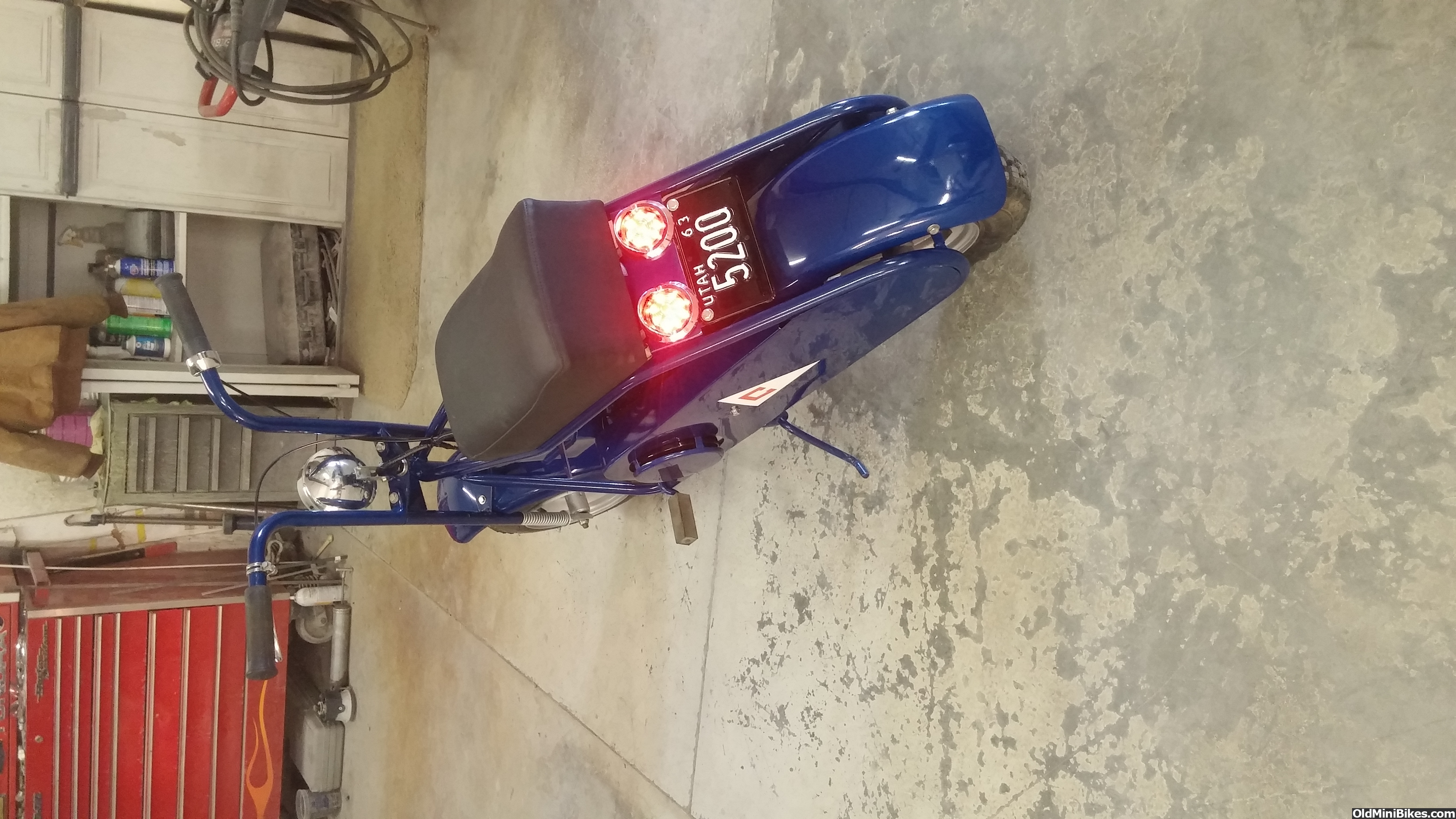

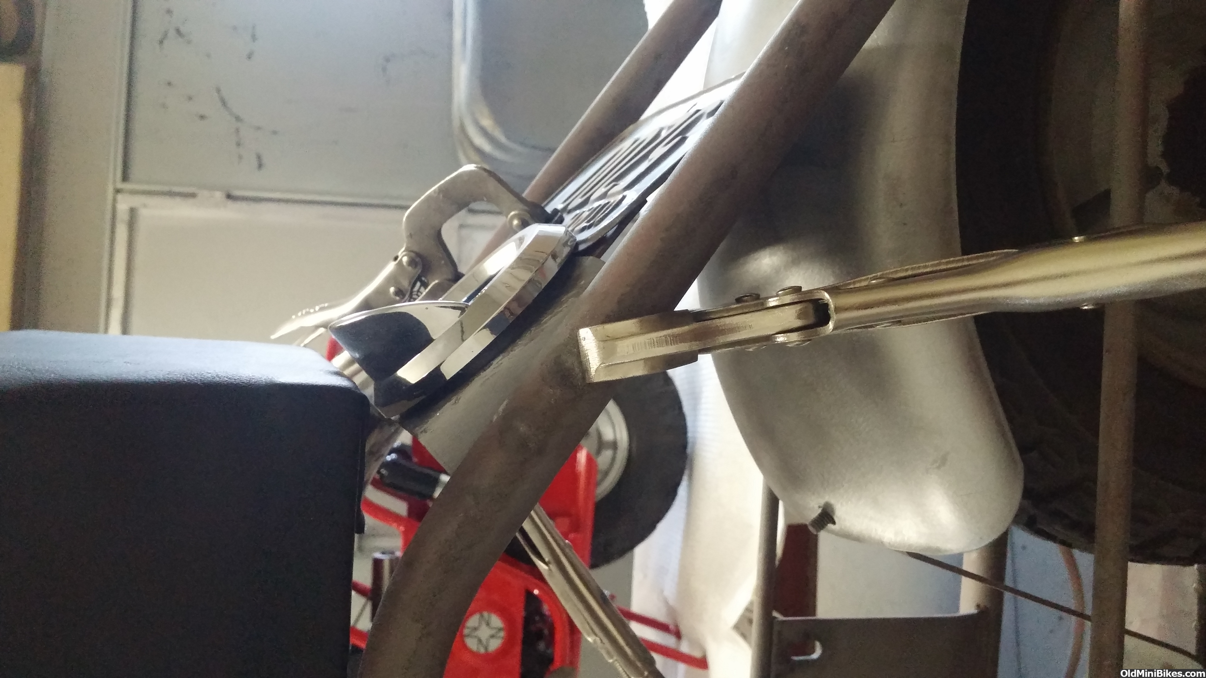

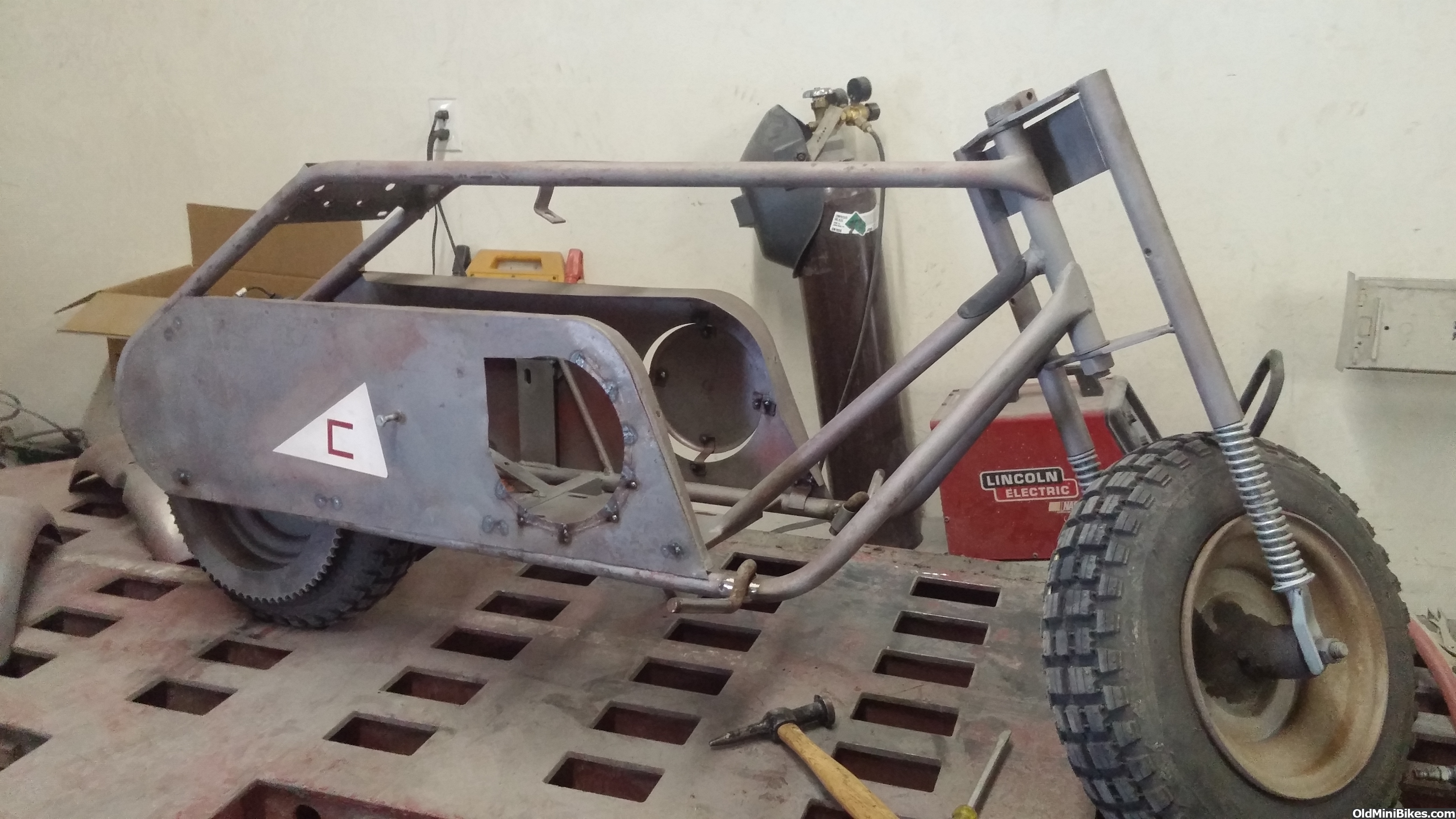

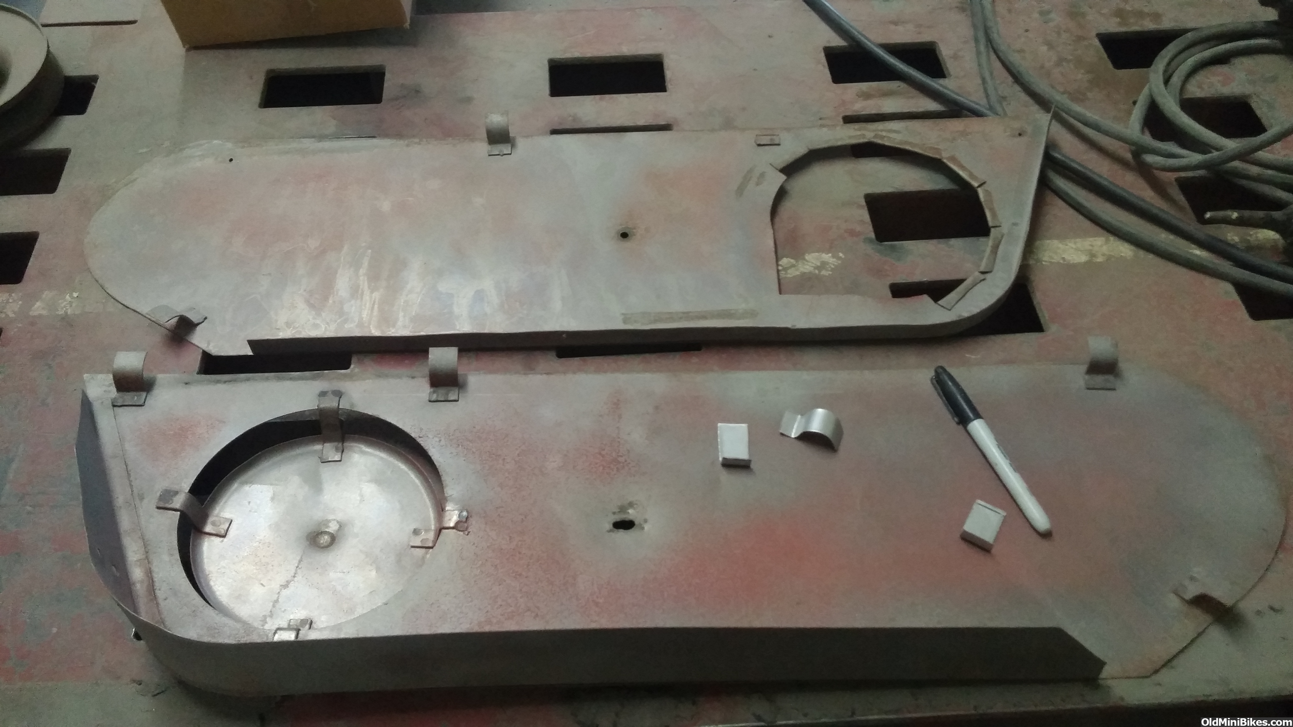

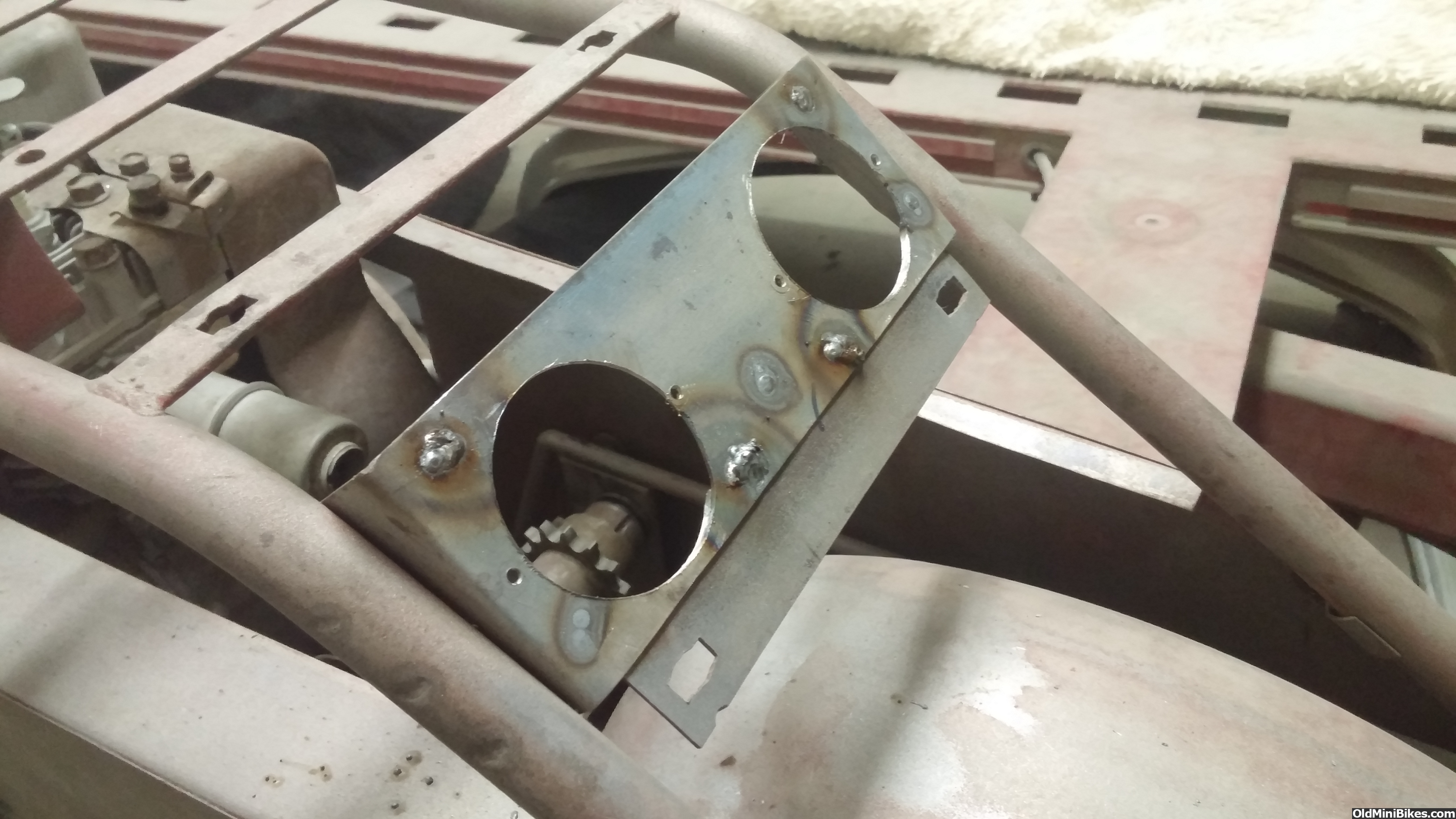

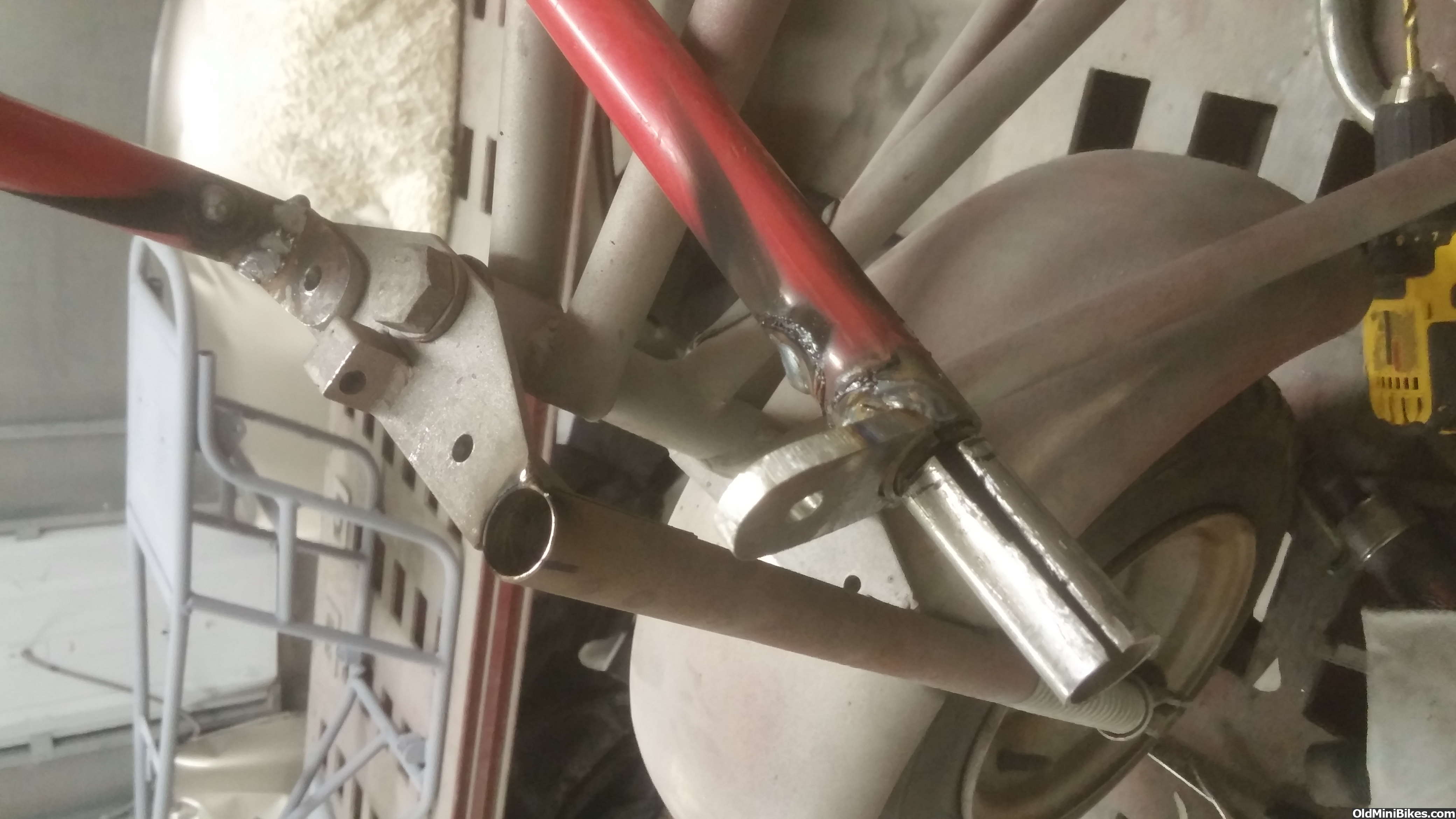

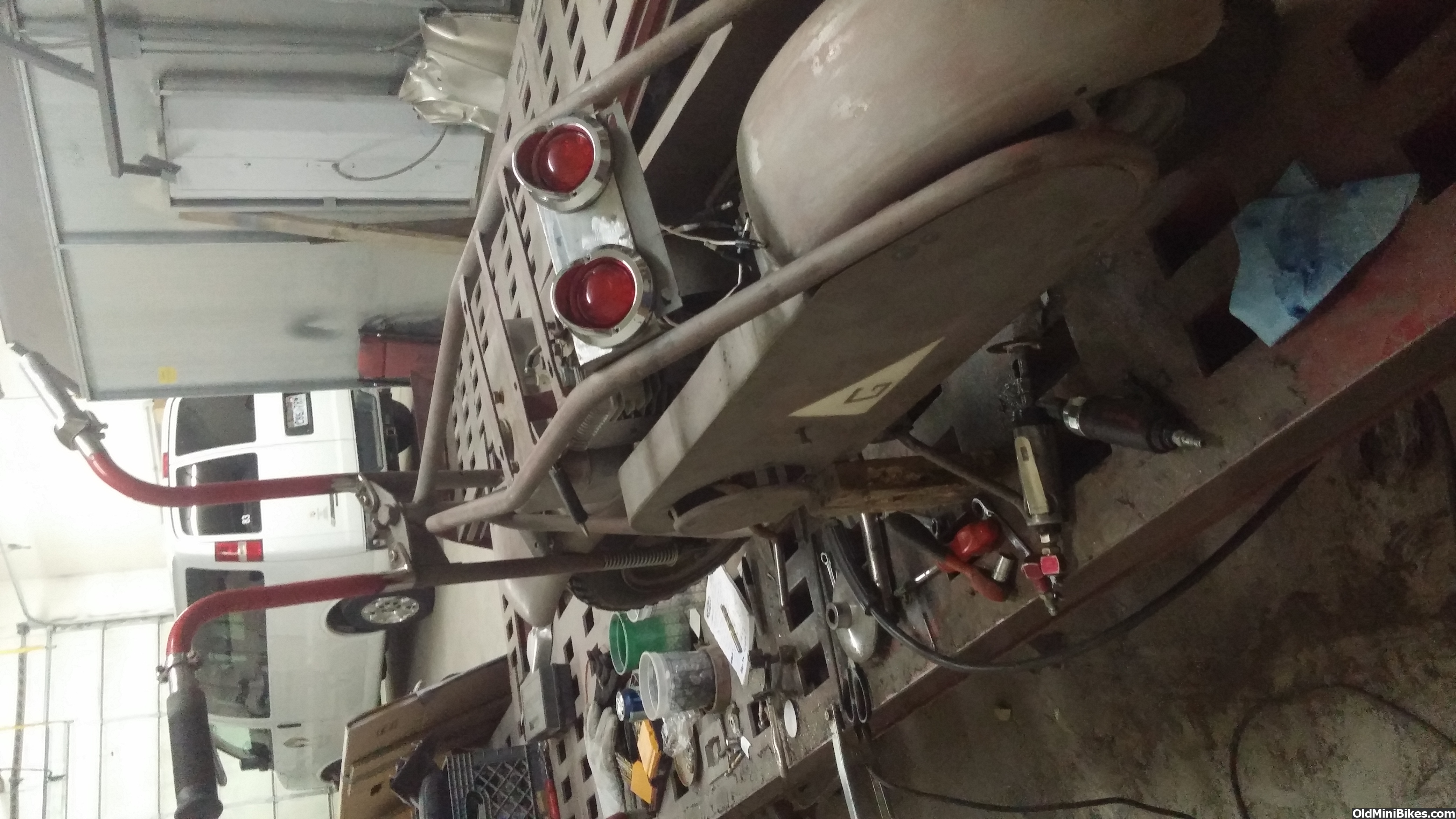

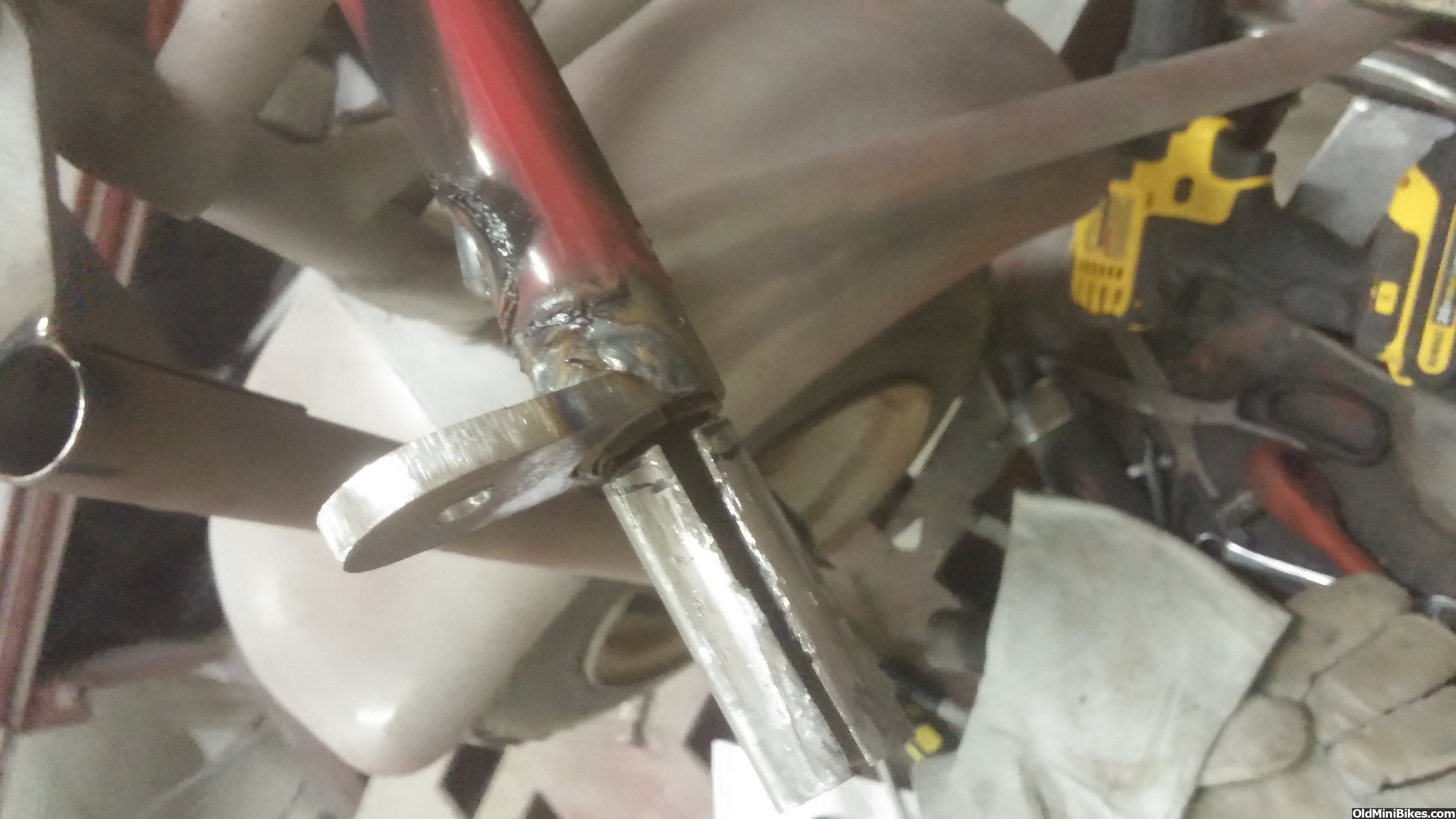

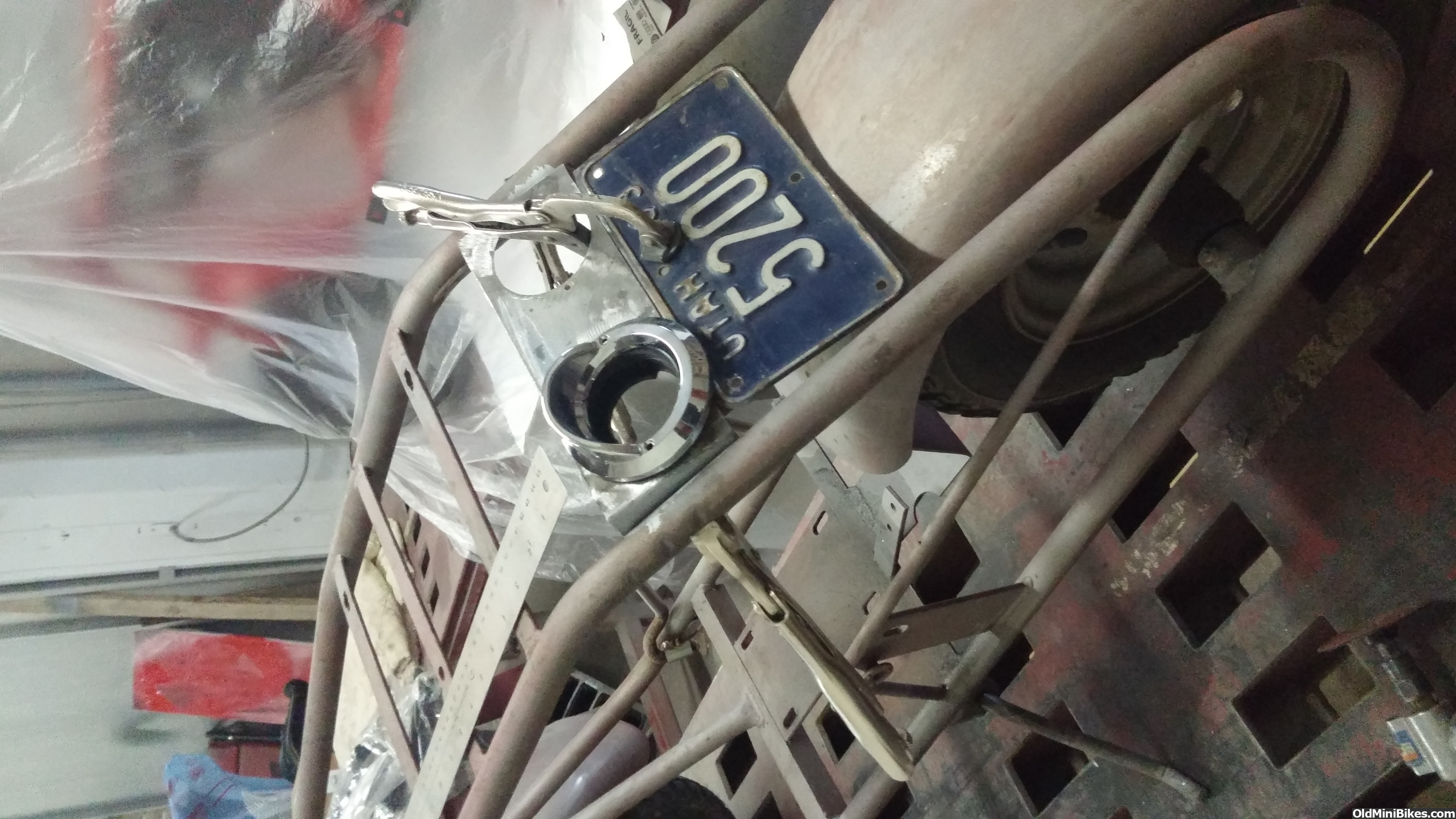

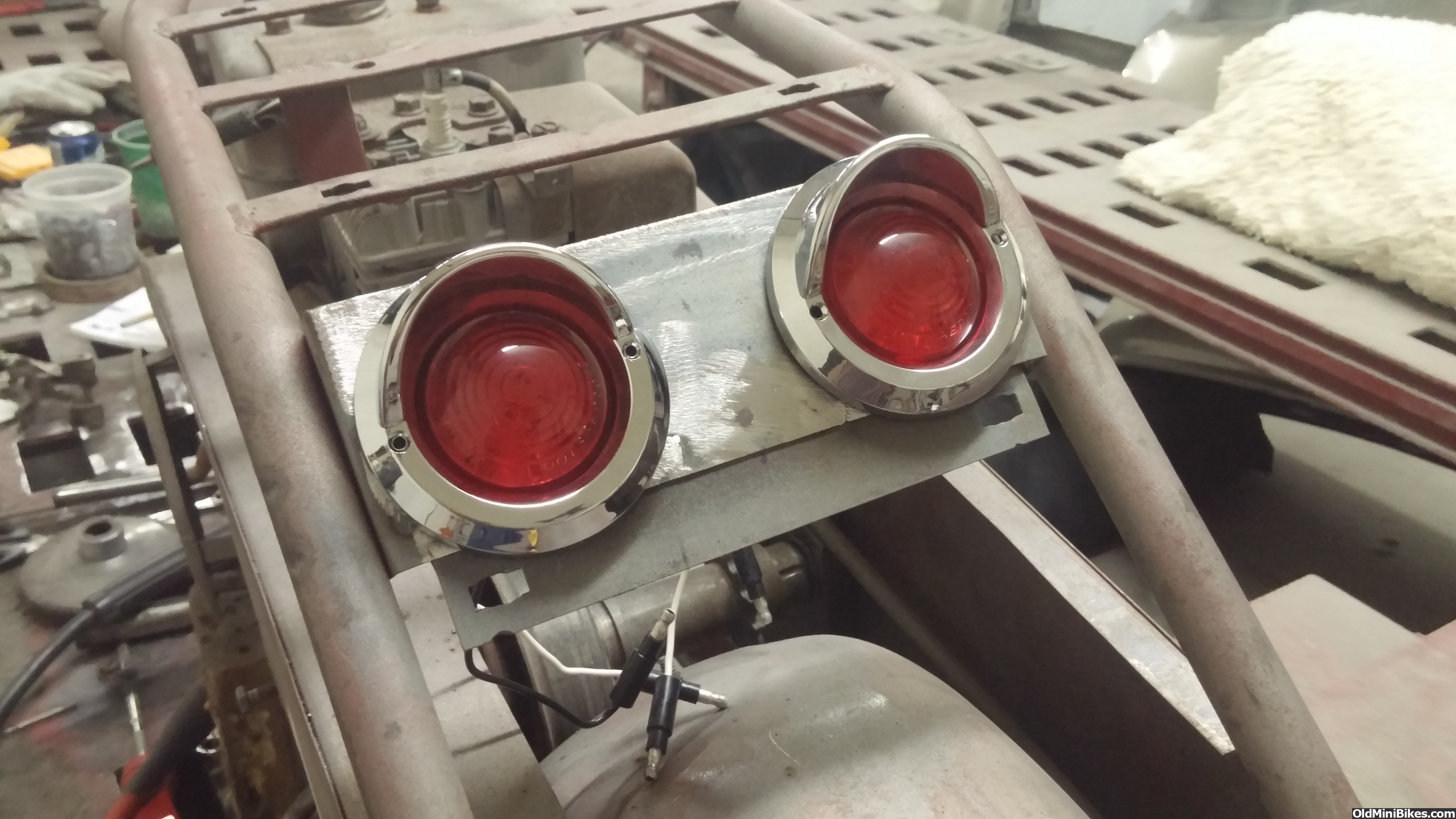

Close to finishing all the metalfab..Got the seat back and was able to adjust the tail light bracket to back of seat/bezel clearance while giving the licence plate room between the fender. Slinging some bondo at er now..

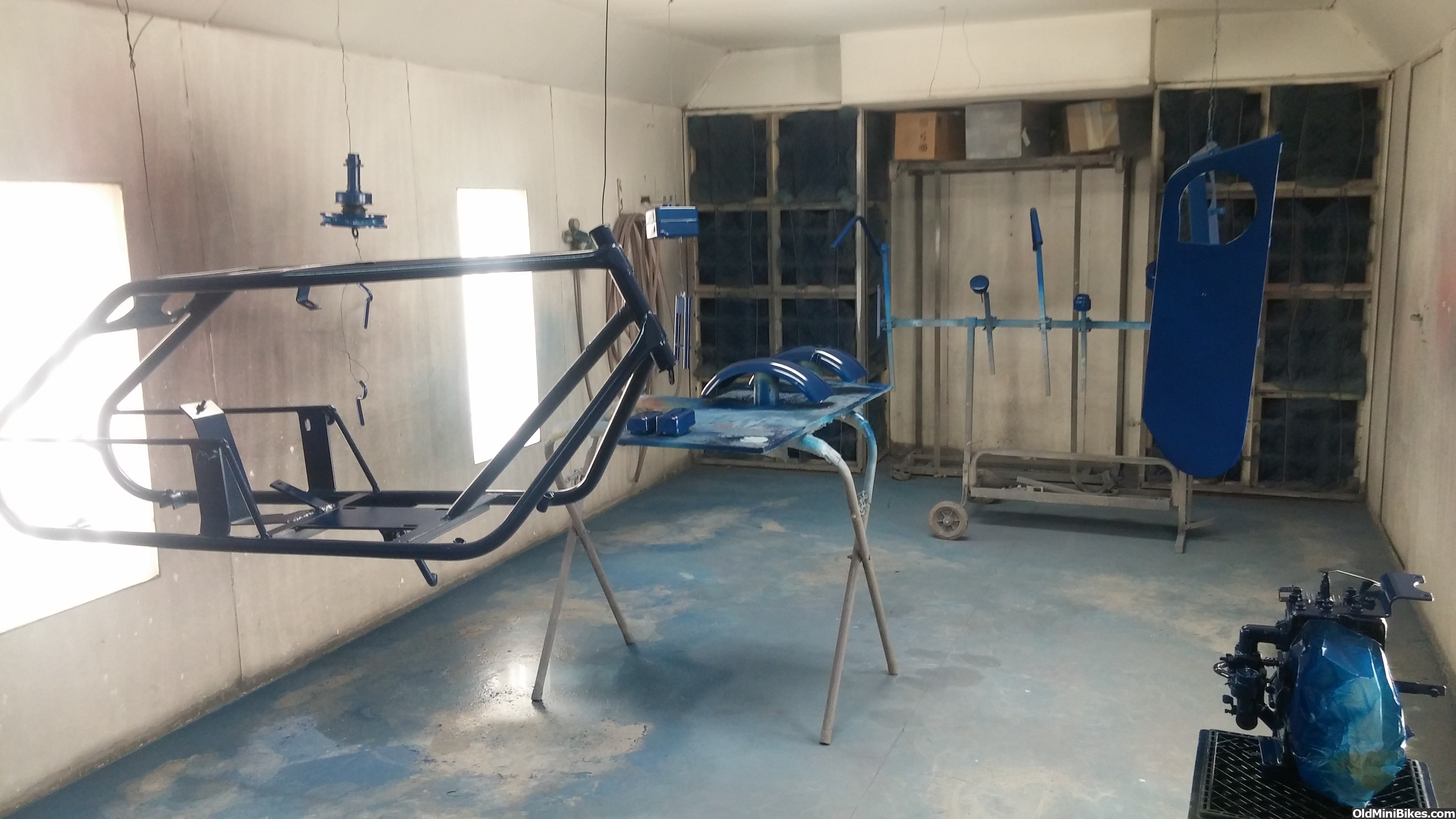

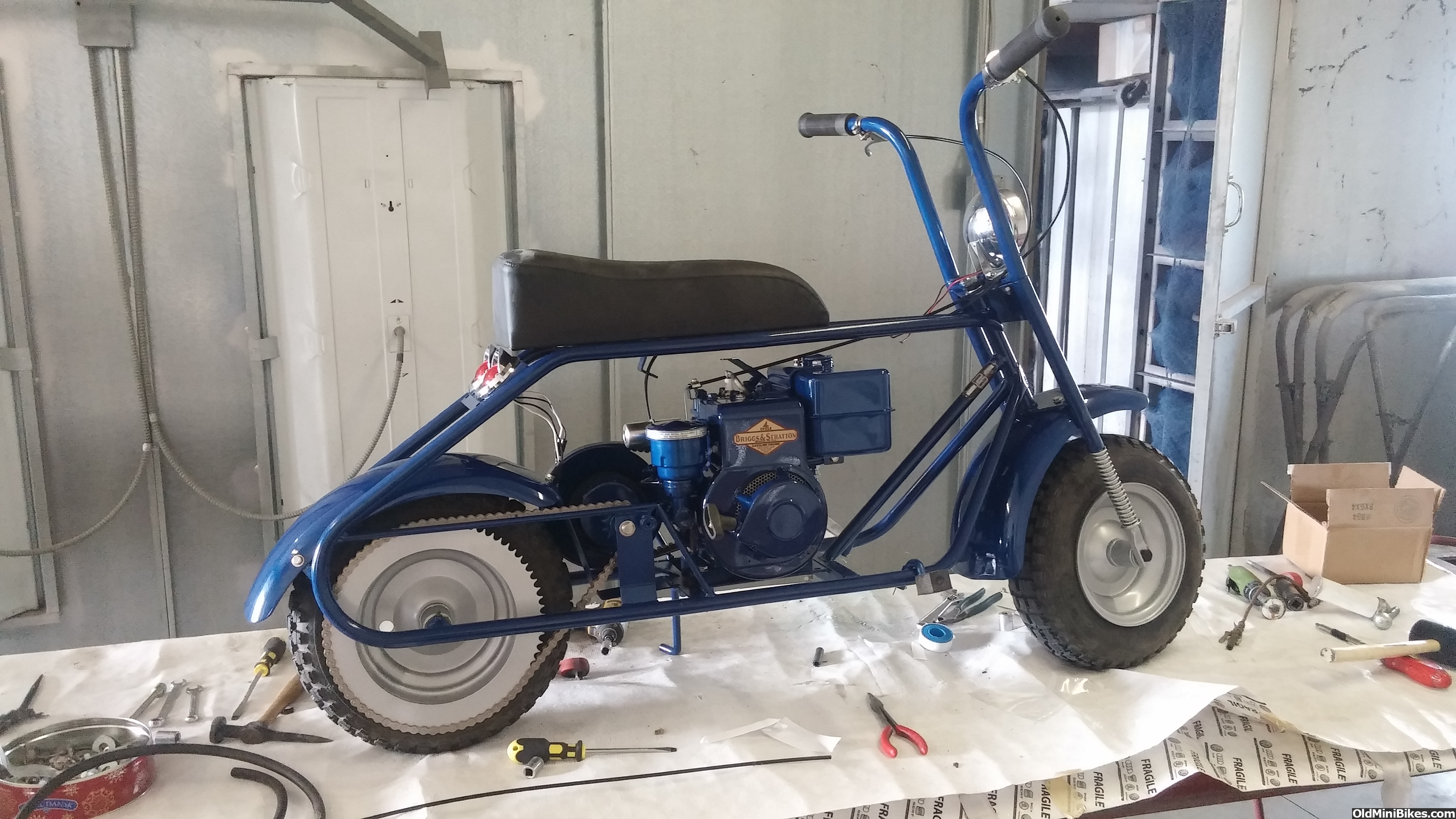

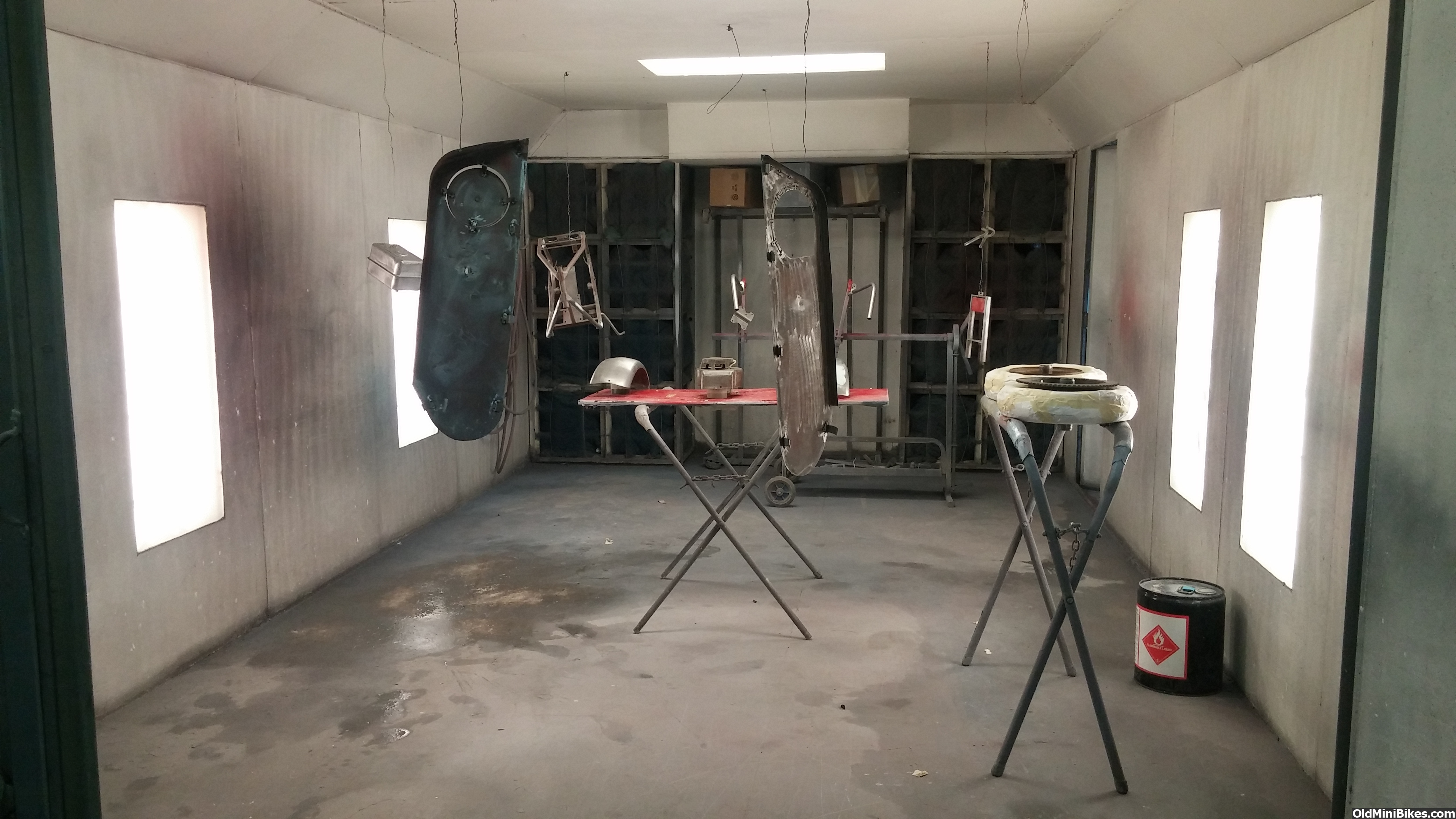

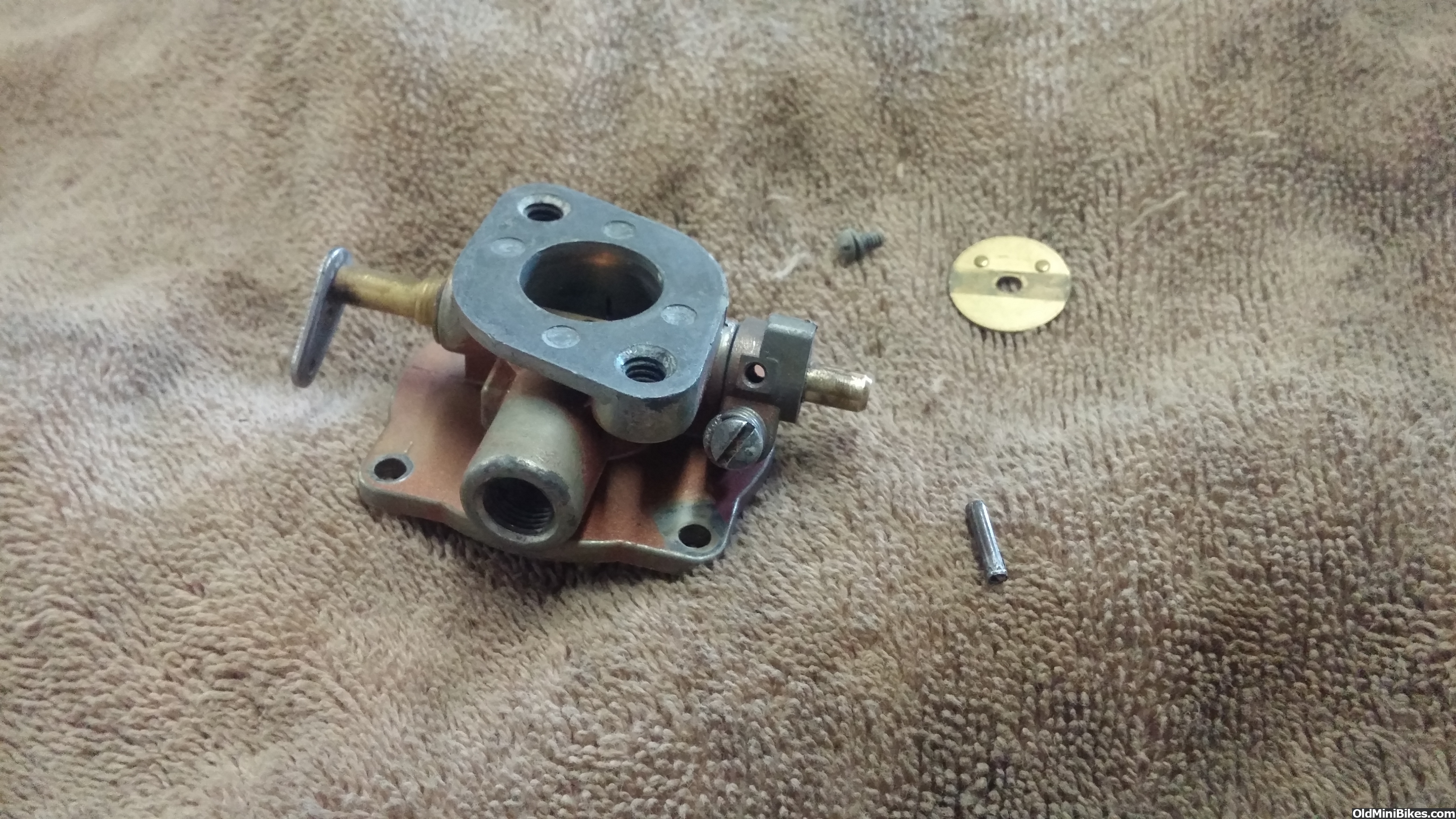

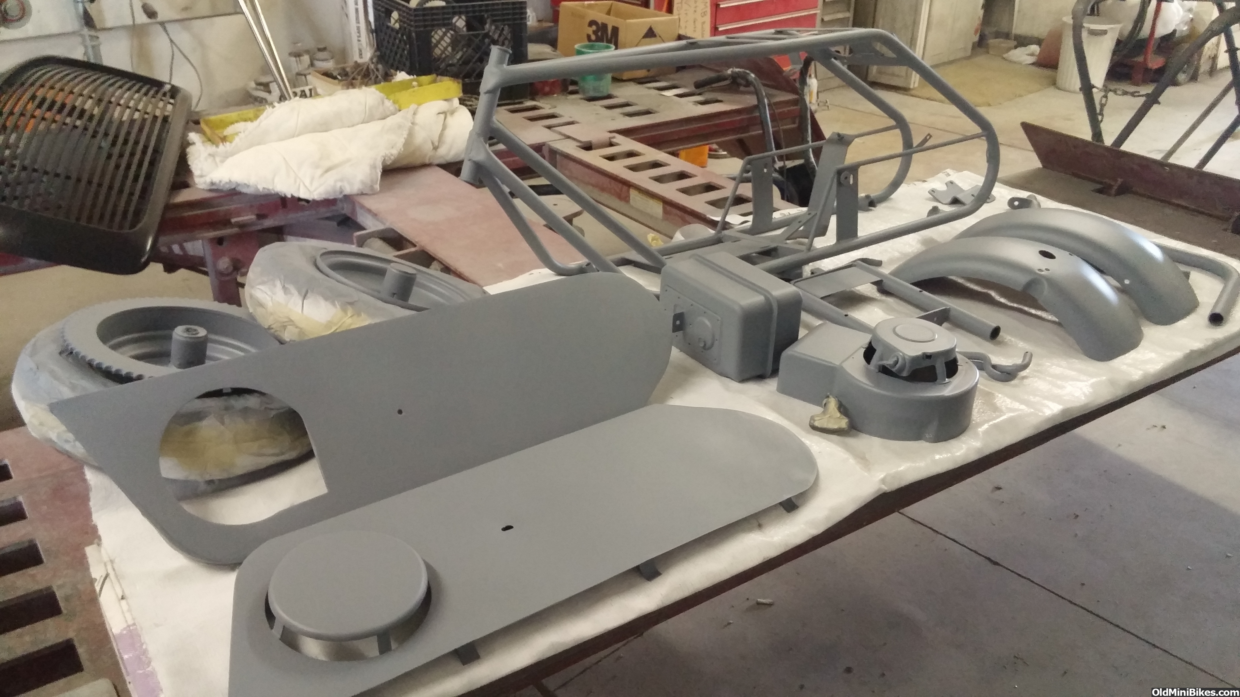

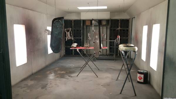

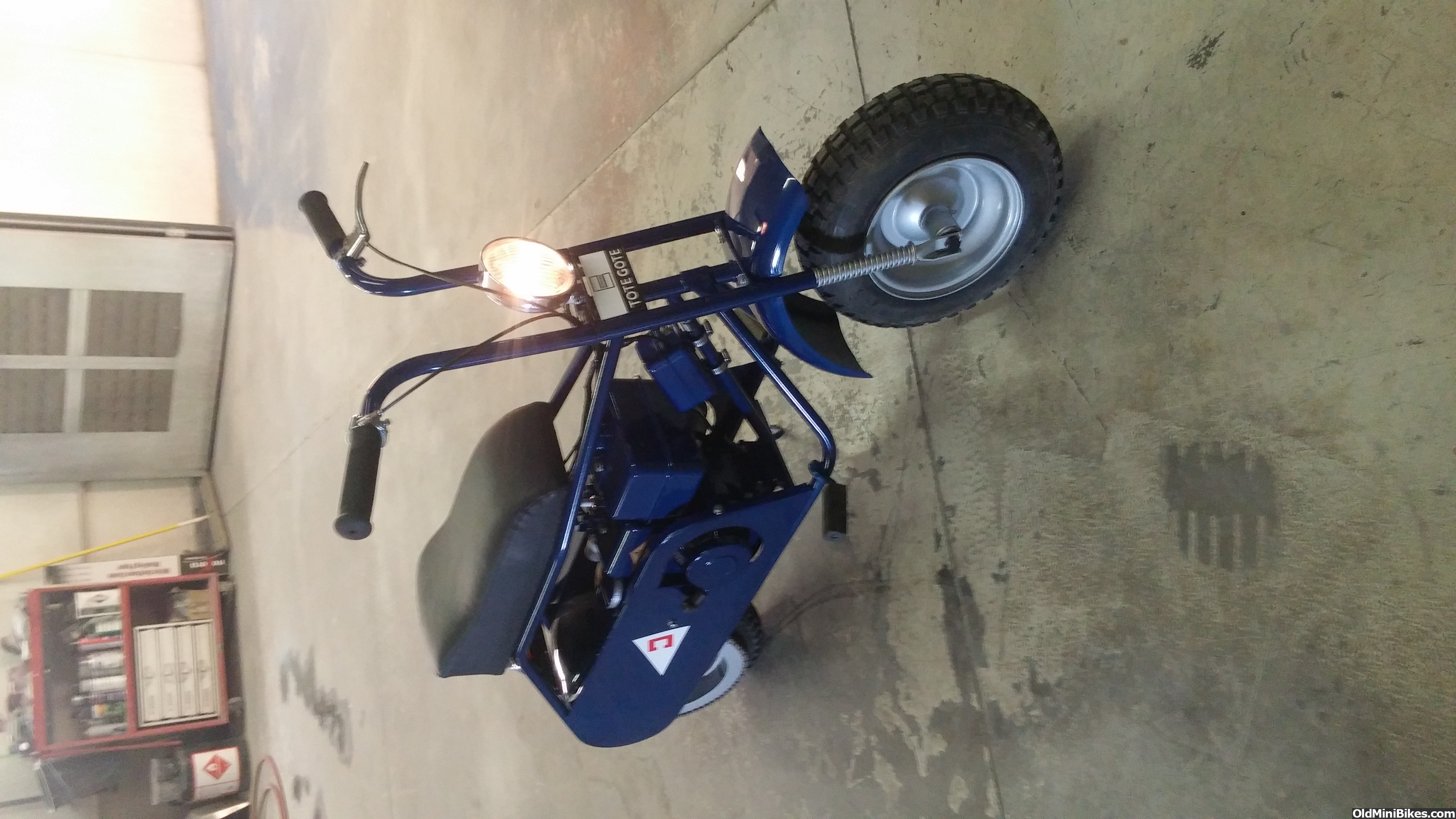

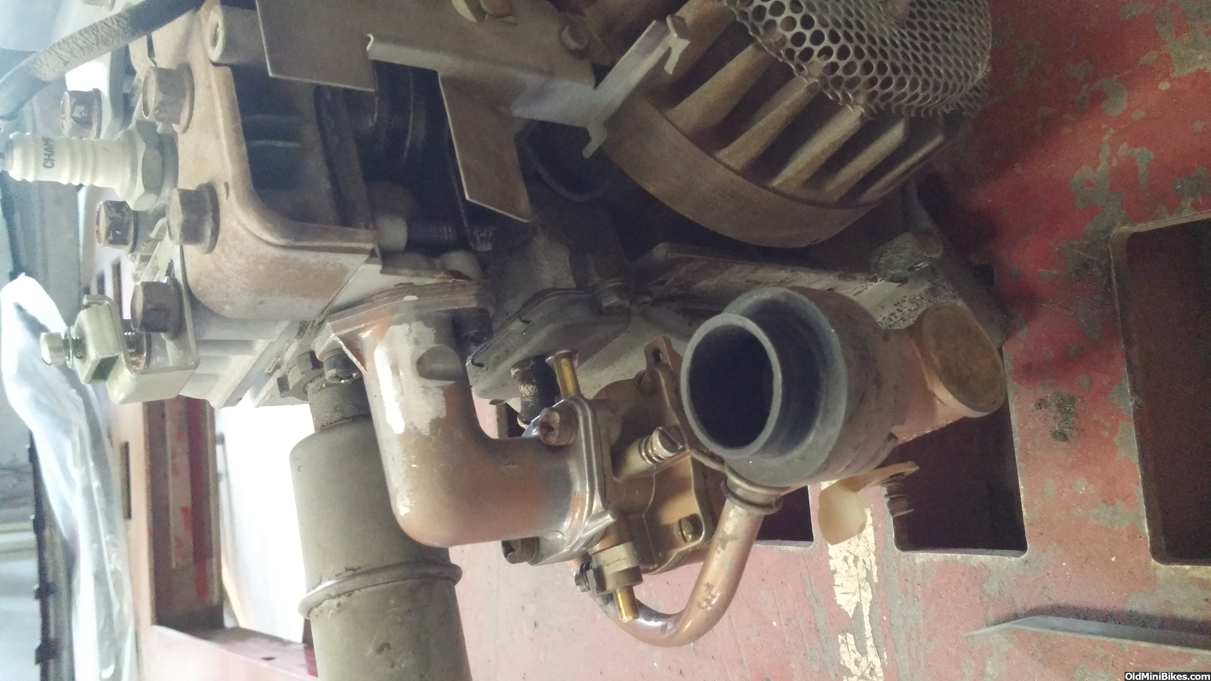

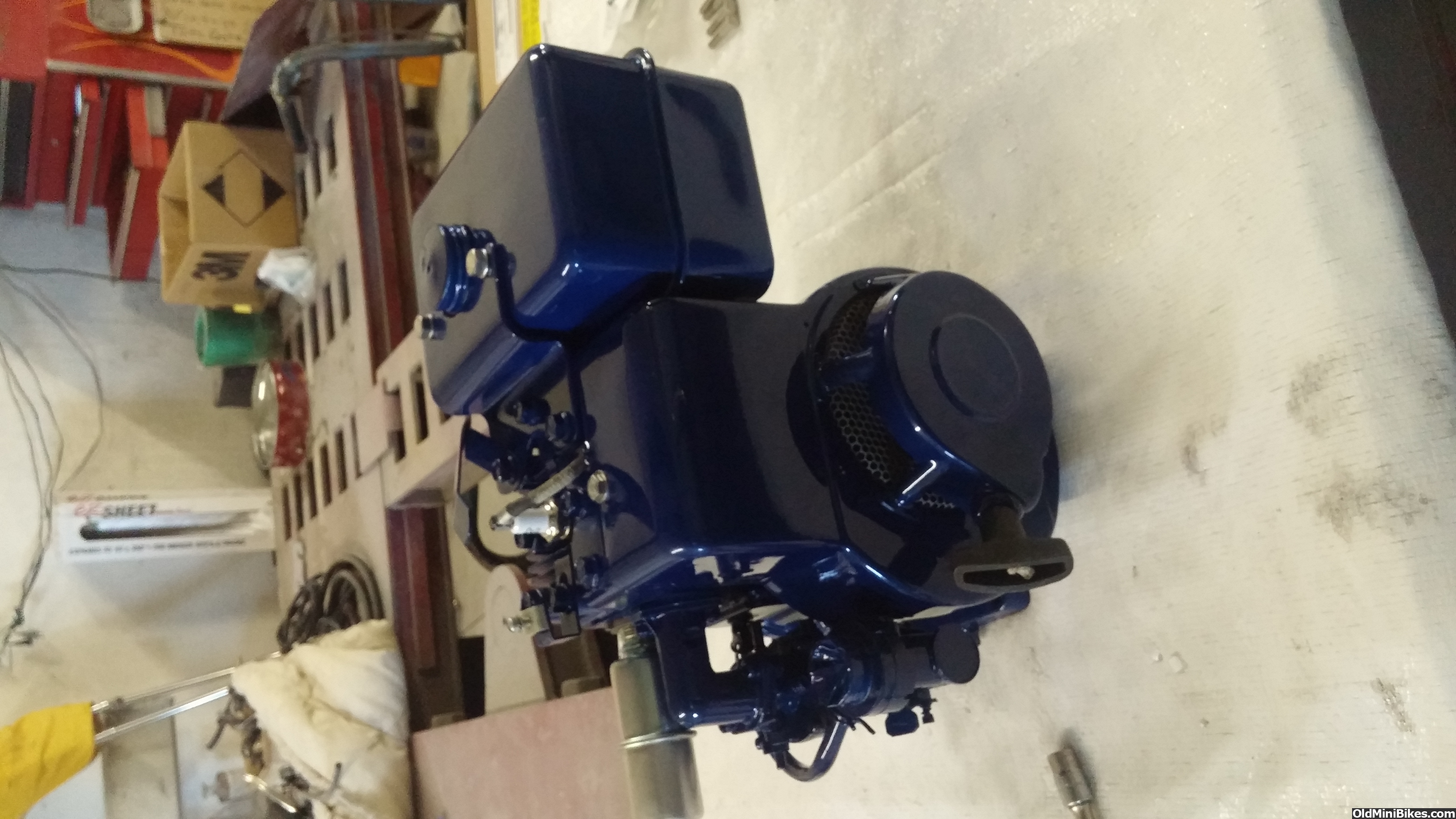

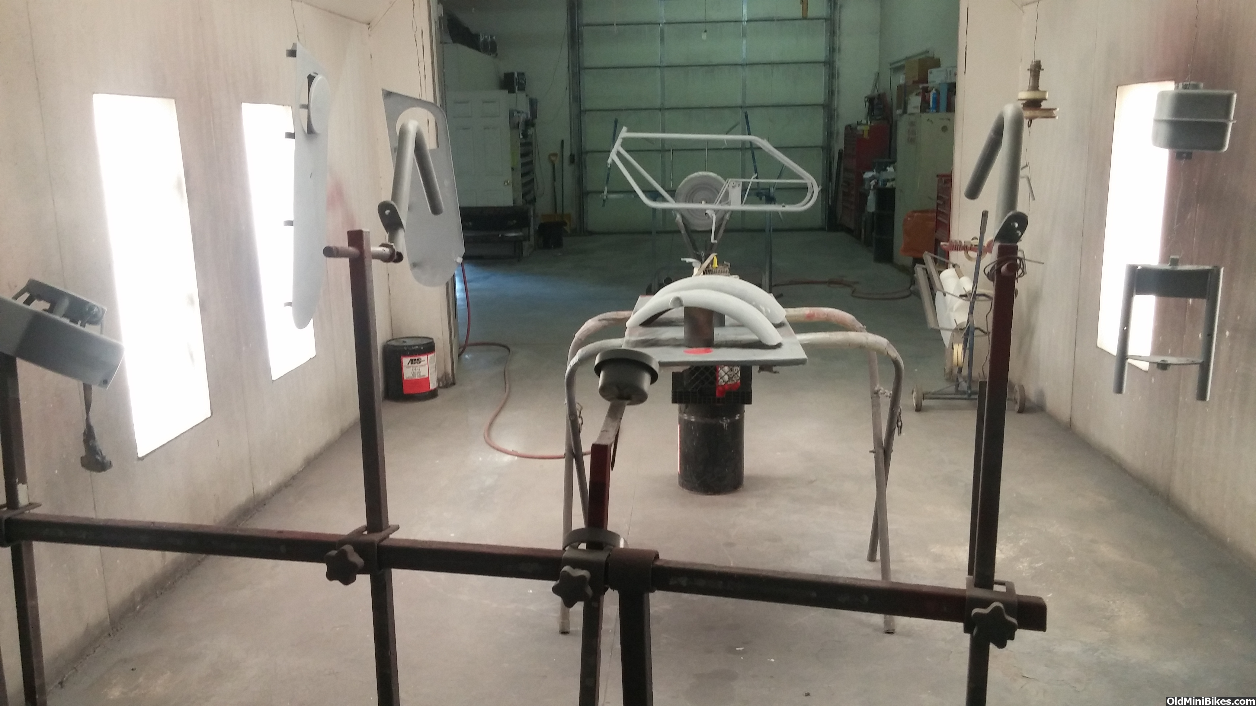

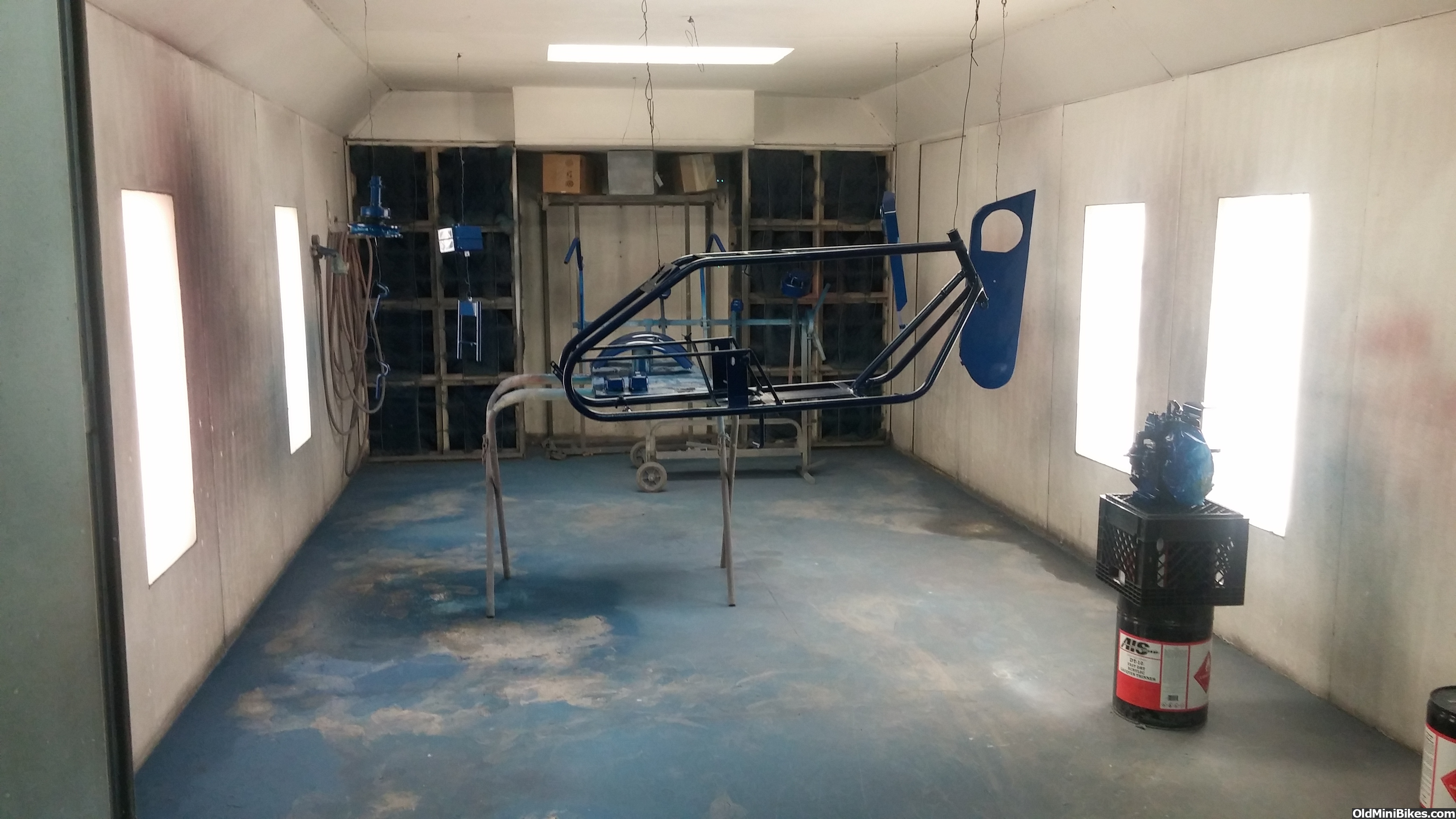

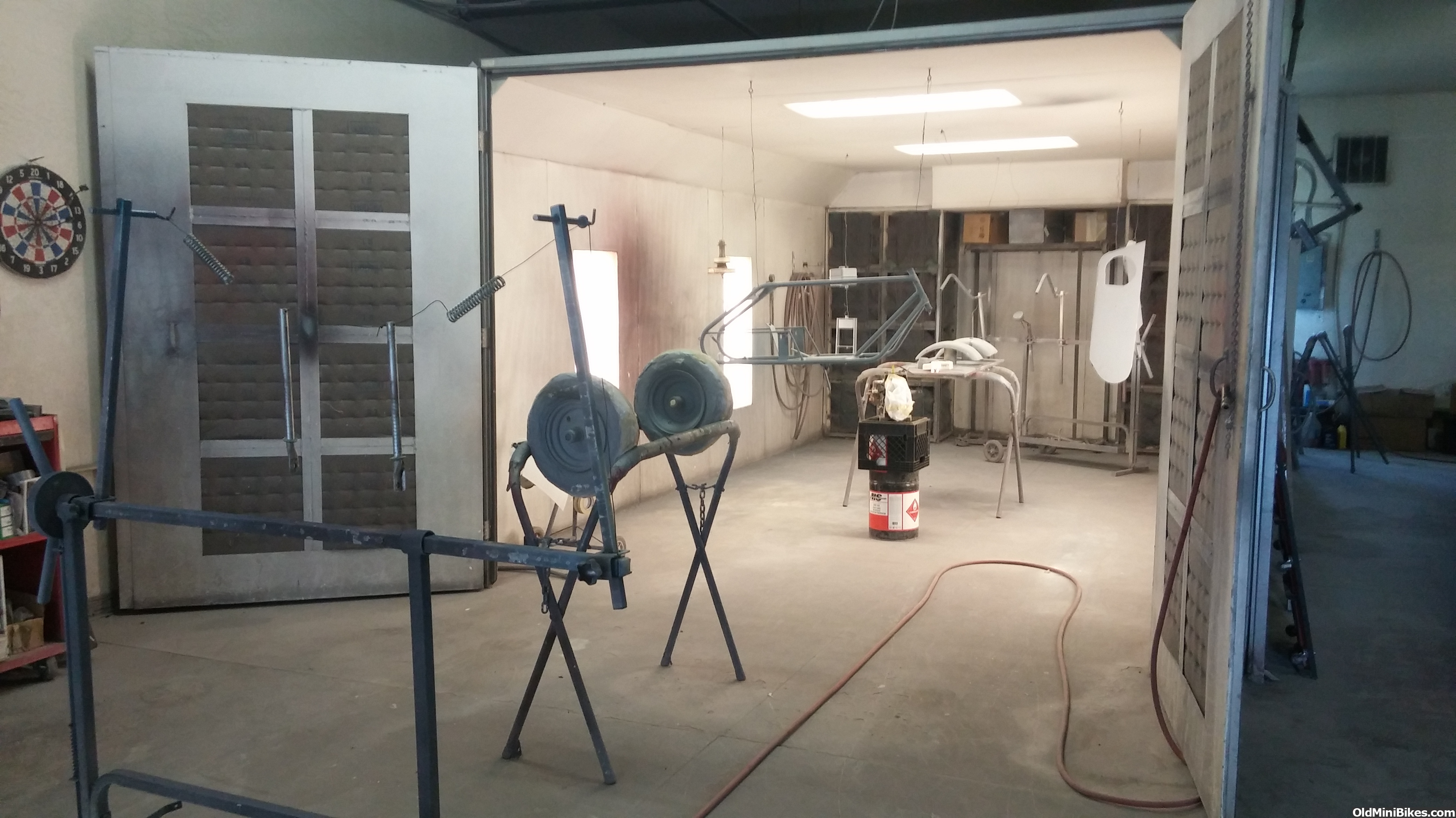

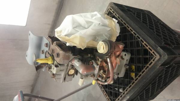

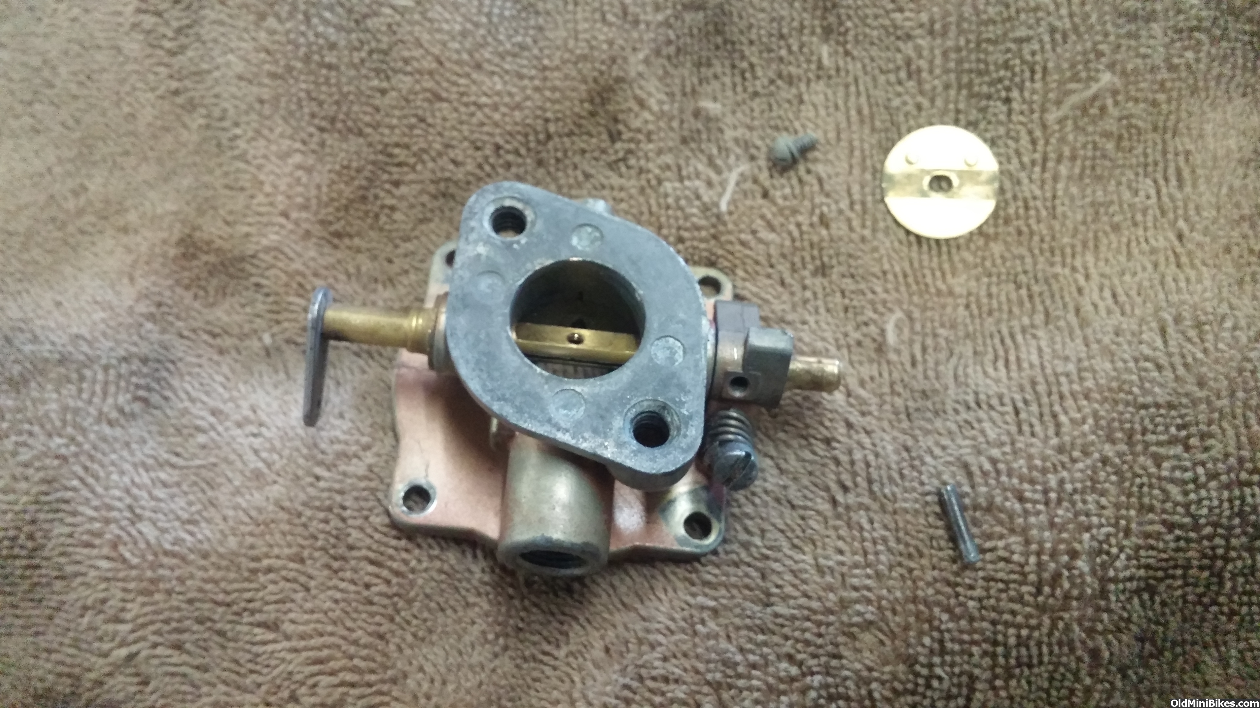

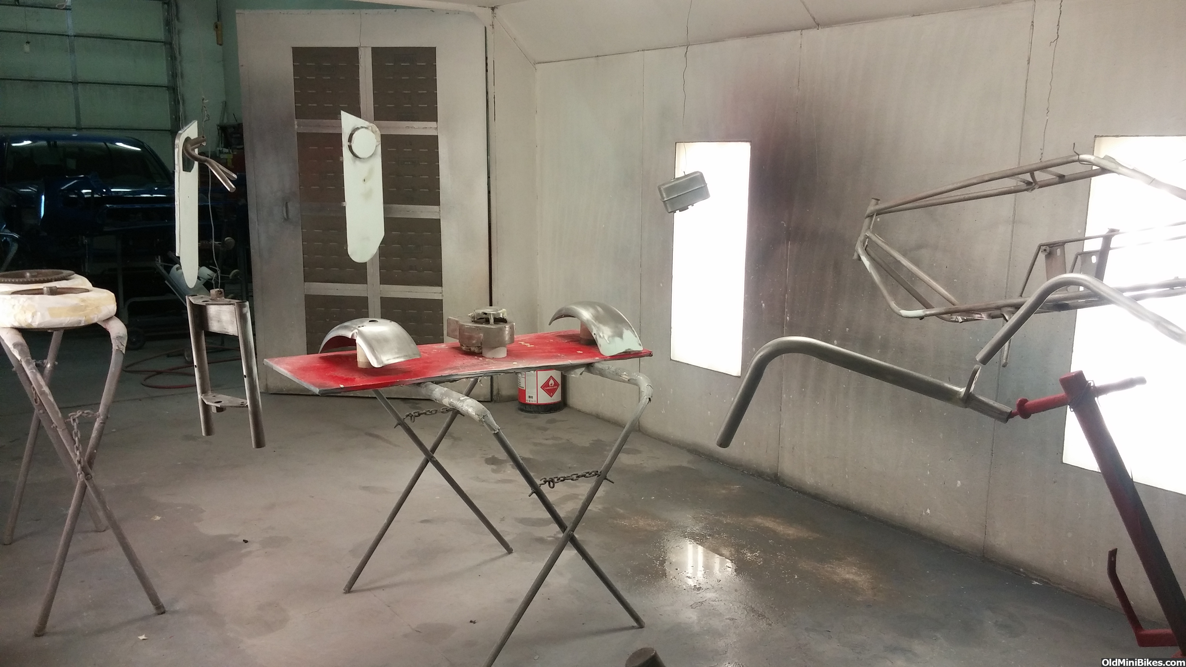

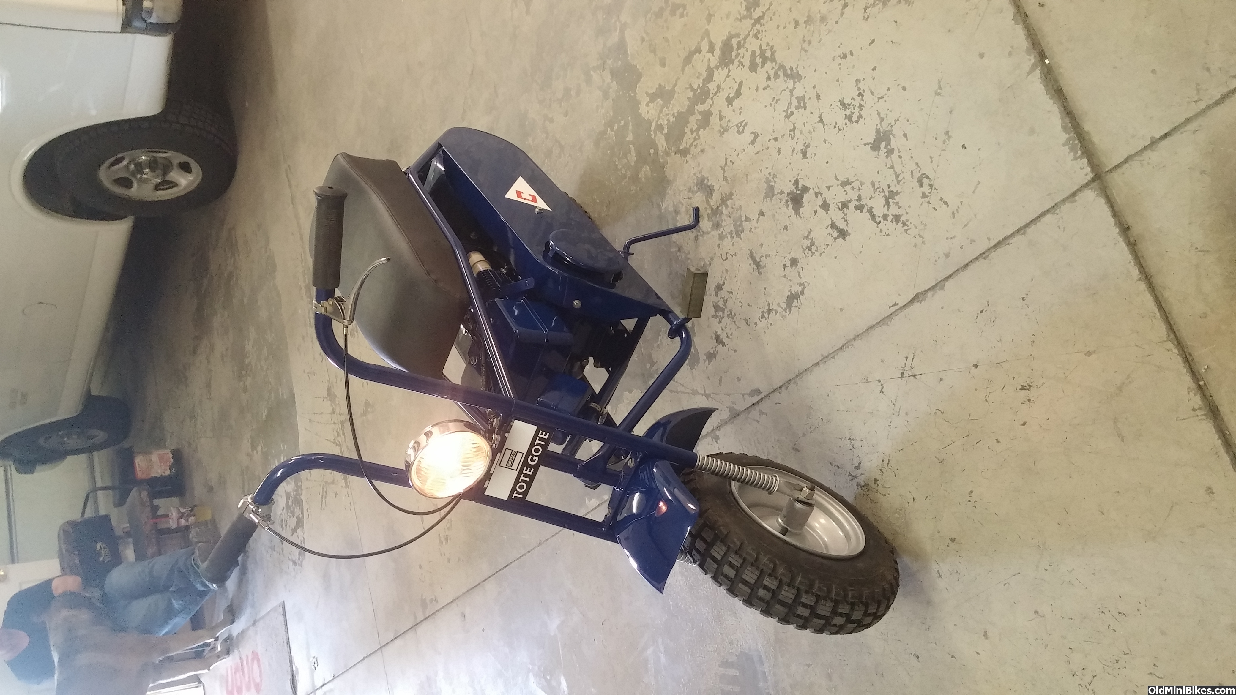

I flip the butterfly carrier in the carb so it opens being pulled up instead of down where I put the return spring. Just pull the roll pin, rotate the carrier 180 degrees and put the pin and slide butterfly back in the way it goes. Makes for easier rigging...also went threw and checked and cleaned everything on the engine. Prepped out and hung all the parts and applied the blue pearl and silver paint.
