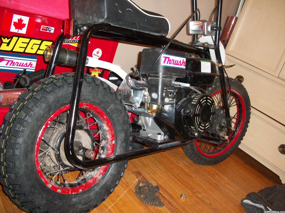

I used the VHT Flame Proof 2000 degree "rattlecan" for my header. Did a similar process as Raskin and I had great results. I also used header wrap later so the paint is stained now but still in good condition. If I remember, I will post a picture later tonight after work... I also painted a stock clone muffler white. I didn't prime it first so it started rusting after a year or so but never flaked.
