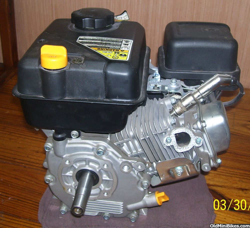

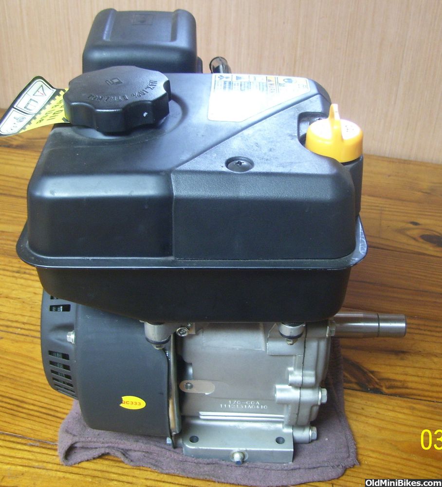

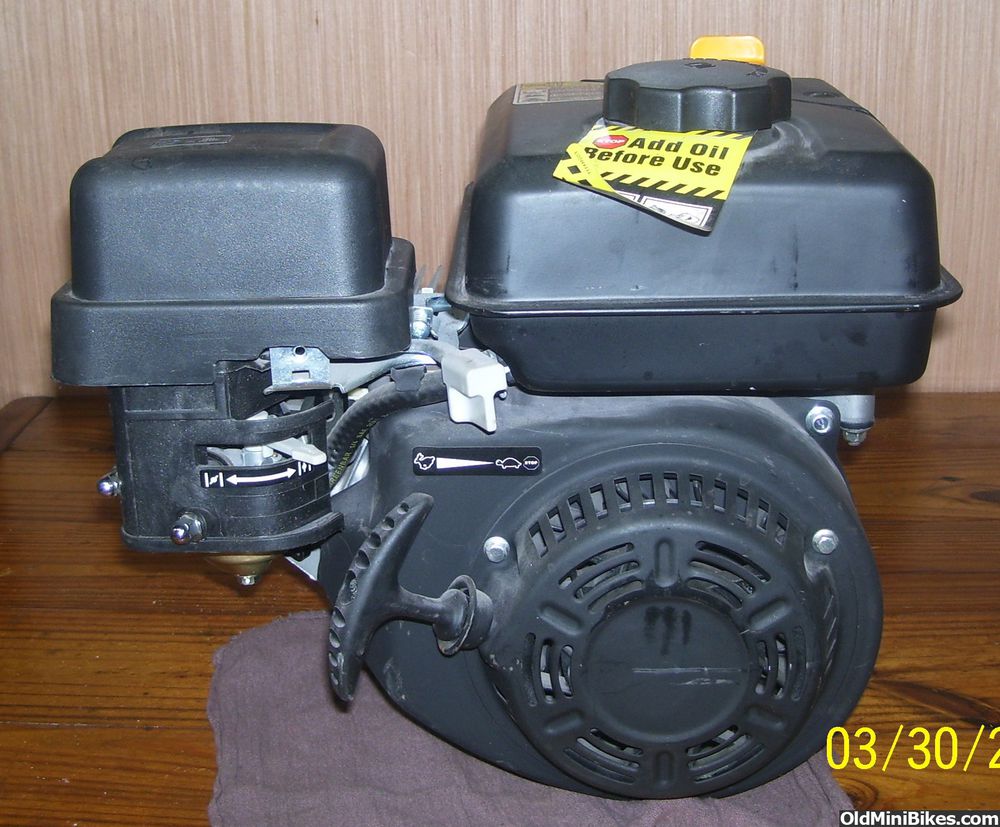

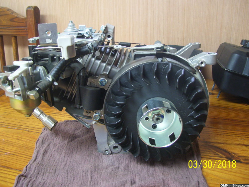

Here's what it looks like from the factory.
No fuel cut off lever ^^^^ only the choke.

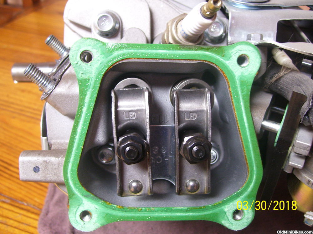

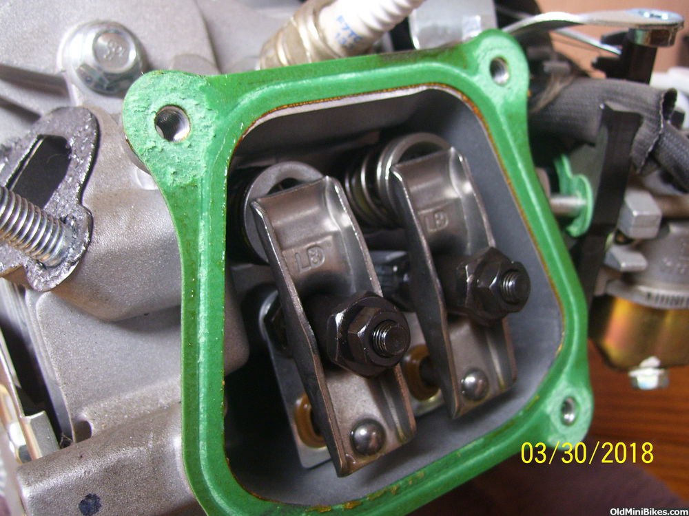

Notice the valve cover shape.
Crankshaft has to go or be turned down to a 3/4'' shaft .
No low oil sensor inside or out .

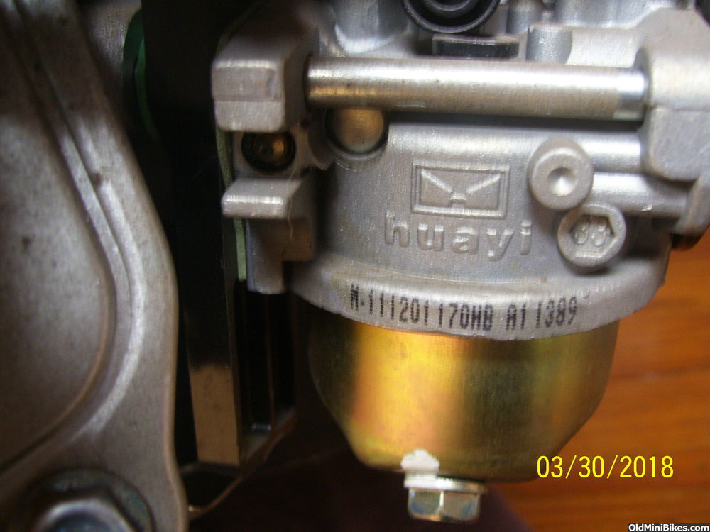

Huayi carb , still probably a .615 venturi , but I'll measure if I decide to use it .

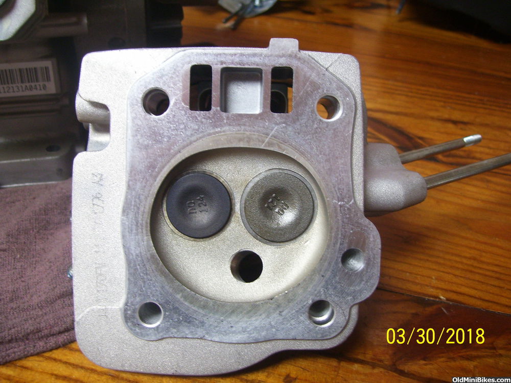

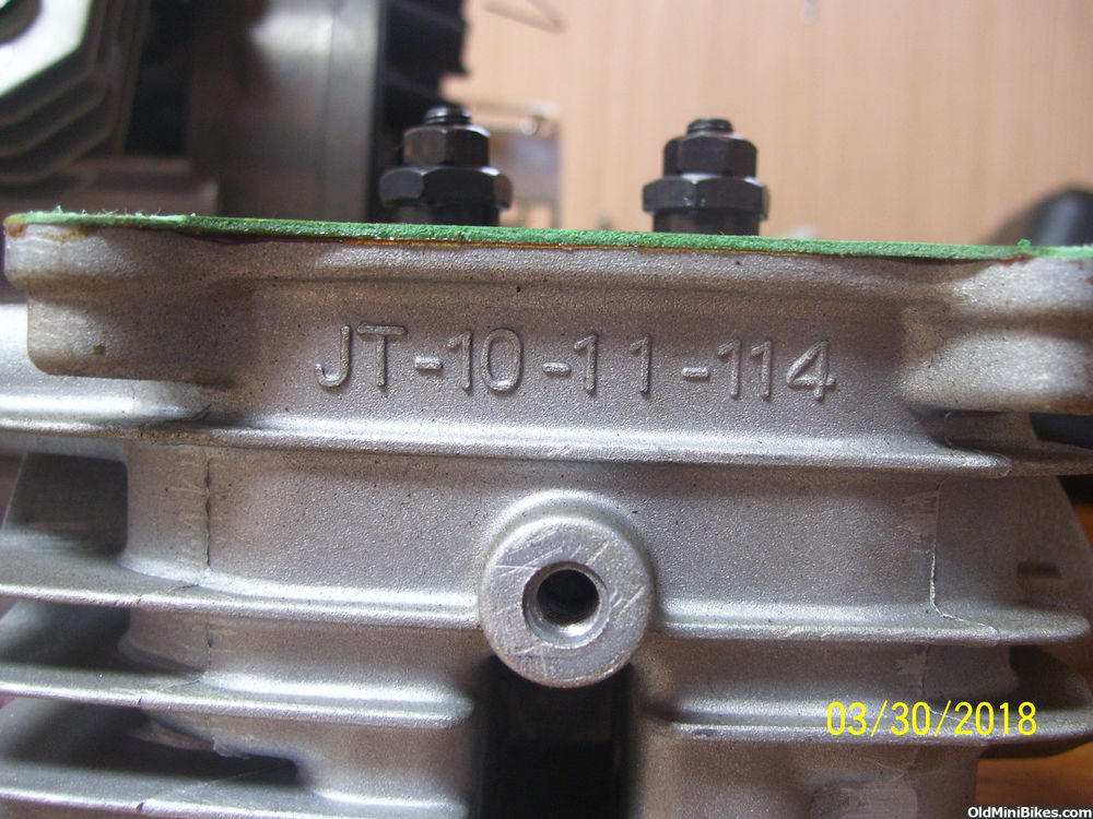

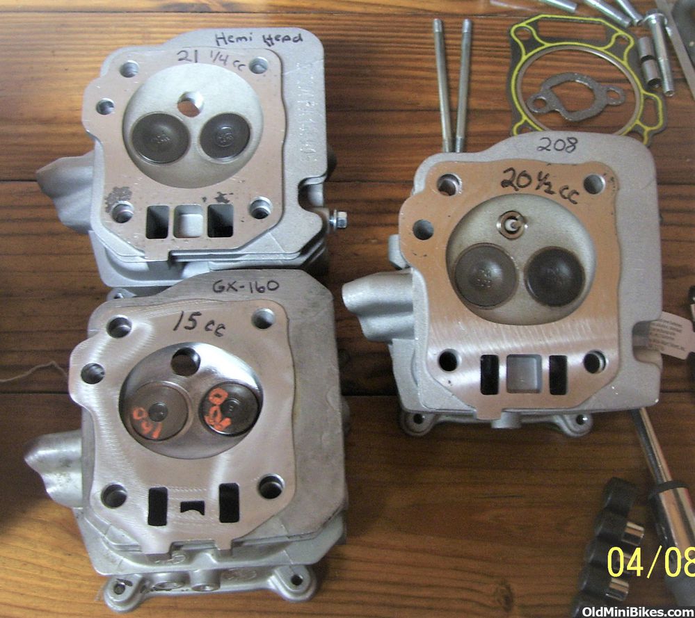

Head numbers .
#2
_.JPG[/img][/url]
27mm intake valve and a 25mm exhaust valve ...looks like about a 22cc chamber.

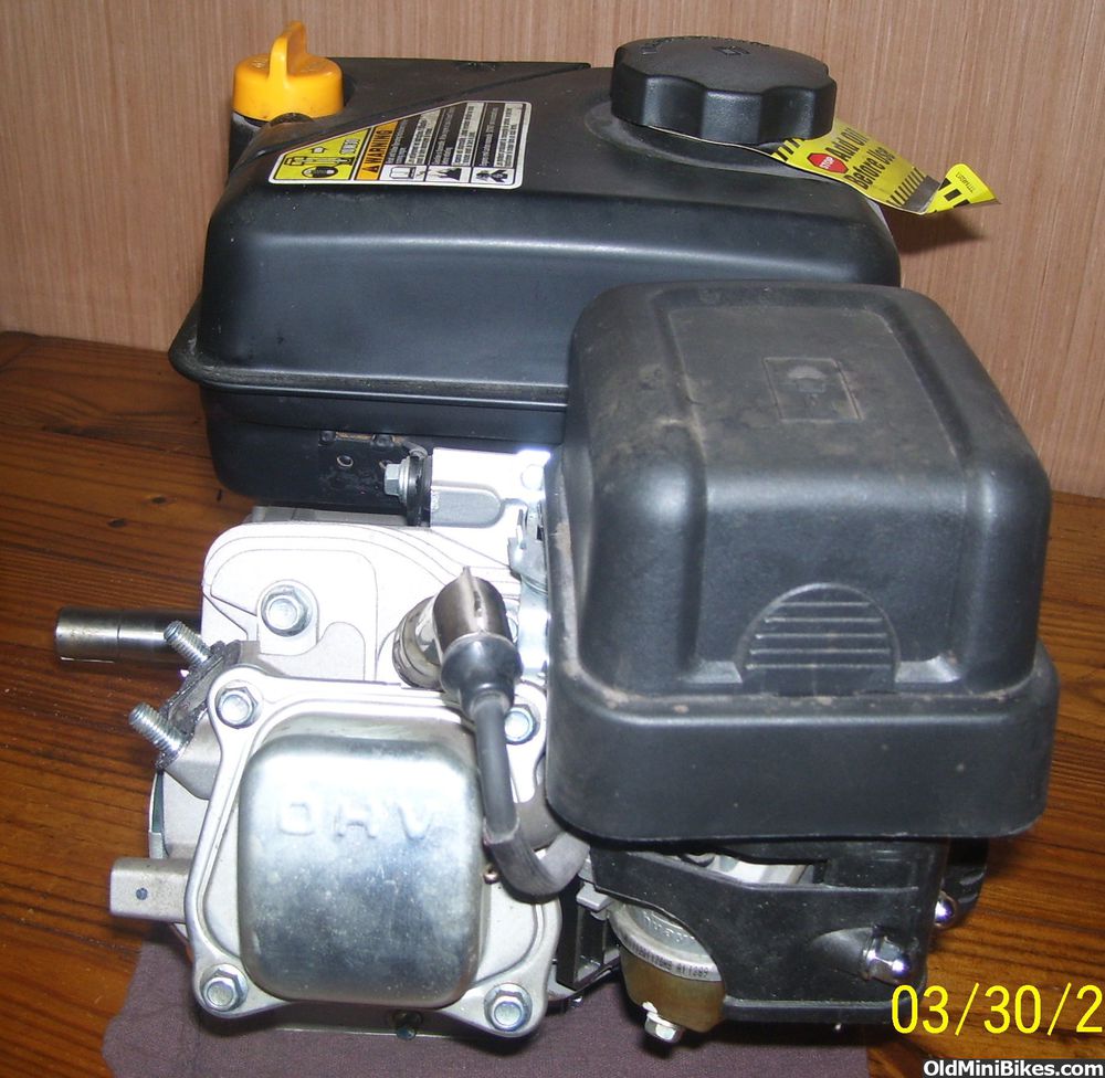

Side shot of the engine and the carb, no fuel shut off valve.

Interesting rockers. I'm surprised the valves are so big from factory. They should be perfect.:thumbsup:
Yea rockers are totally different from what I'm use to seeing in a clone/predator engine, and was kinda surprised that the valves were this size . Not sure yet if I'll use this head though ...but we'll see.

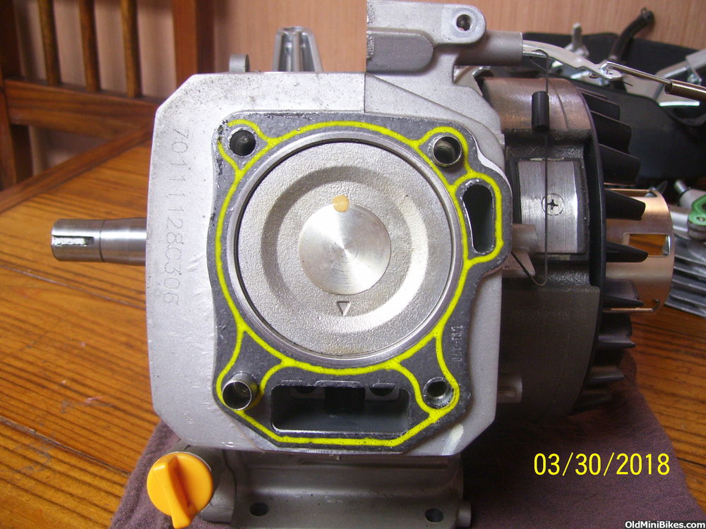

Some numbers from these original parts.
Bore is : ( 70mm or 2.753)
Stroke is: (2.128)
Rod length is : (3.305)
Rod journal : (1.180)
Wrist pin is :.(.715)
Piston in hole : (.020)

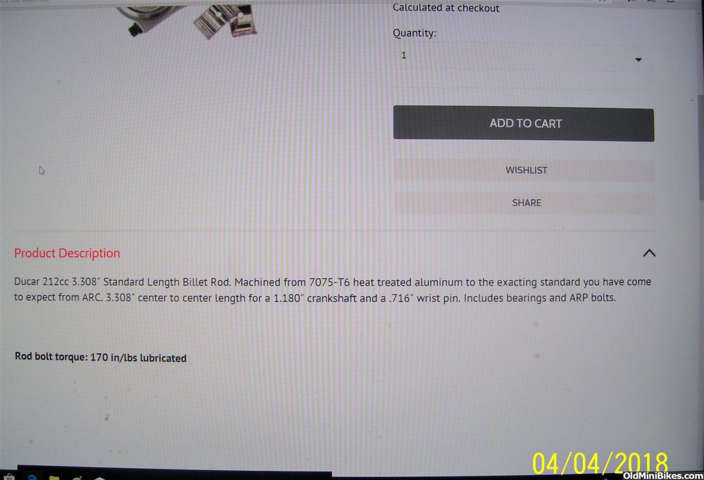

Looks like the good folks at ARC Racing does make a rod for this engine . I'm a little surprised with the crank / rod journal being a 1.180 and the wrist pin being a .715 . But still good to know that they have it if needed.

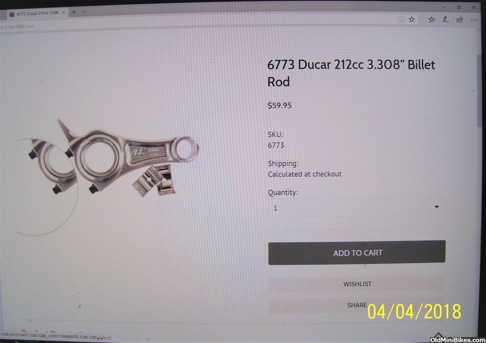

we have the rod too
https://www.OldMiniBikes.com/6773-ducar-212cc-3-303-billet-rod

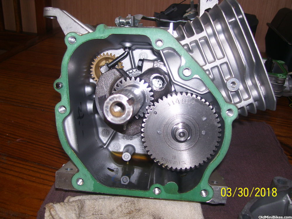

on a side note, does that stock crank have a GX200/Clone taper on the flywheel side? [MENTION=47323]OND[/MENTION]
Thanks Eric , and yea I will buy the rod from the OldMiniBikes warehouse and maybe a crank to , waiting on a piston to come in .
I checked OldMiniBikes warehouse first for the piston and it showed to be out of stock. ( I tried )

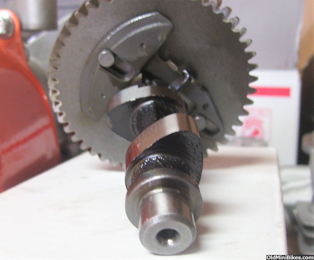

I will check the taper on the OEM shaft this weekend and let you know . I know the camshaft is going to be for a Predator and not the Clone/Hemi engines. Side journals on cam measure .556

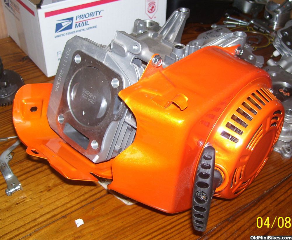

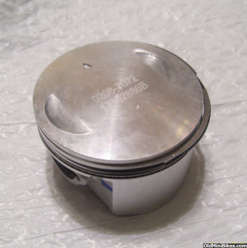

Here is the piston I'm going to use on this build, it came in today. Hemi head flat top with two .050 deep valve reliefs ...stock diameter piston. Now I can get some measurements for a crank shaft and billet rod .
#13
Using the new piston and a max stroke clone crank (measures 2.129)I had on hand I was able to measure out the piston in the hole and ended up with .046.
I'll order a .020 over size ARC clone rod this week , that will leave me .026 in the hole. Will also order a .010 Predator head gasket to .
Got three heads on hand and not sure which one I'll use yet...Hemi head, 208 head and a 14cc GX160 head.

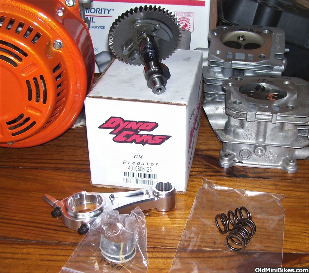

Got some parts ordered tonight cam, rod and valve springs from the OldMiniBikes warehouse, Eric [MENTION=31879]CarPlayLB[/MENTION] let me know when the .010 Predator head gaskets come in ?
#17

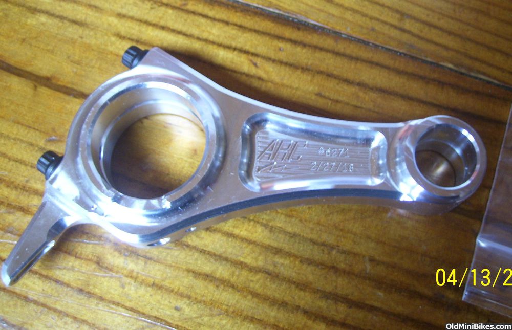

I Love my Mail Lady ! :thumbsup: More parts came in from the OldMiniBikes Warehouse today , Thanks Guys ! I love the "FREE" shipping. OK on with the new parts .
ARC Billet rod #6271 Honda/Clone 3.323 in length...or .020 longer than the stock clone rod of 3.303. Wrist pin measures .709.
Dyno Cam CM grind 265/265 lift cut on a Predator core .

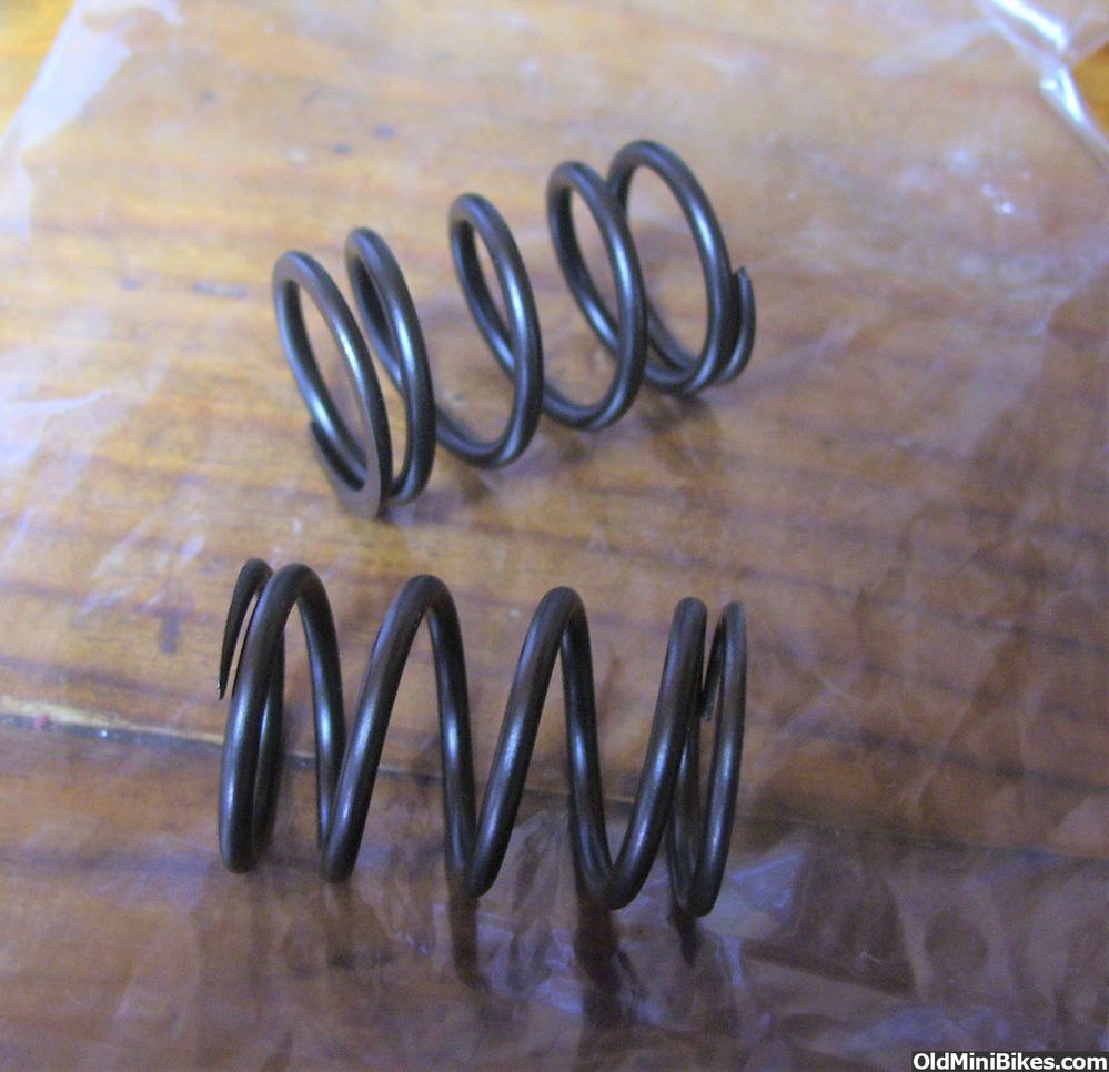

22# Springs from the OldMiniBikes Warehouse . Still might go bigger on the springs yet , but Dyno cams recommend these springs for this cam.
