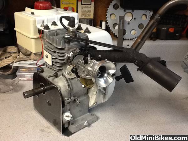

I used to have pictures of some simple supports I made.
They are still here posted someplace, but I can not find them because the OldMiniBikes has moved them and locked them. ( without my permission they seem to feel they are the owner of my intellectual property ).
So search and if you stumble on my stuff feel free to re post it and ask what I did to reduce the block flex and failure risk.

Blocksupports

Interesting.....would that fit a predator?

This is harder to explain than do, wish I could find my photos
I have no idea where the OldMiniBikes has put my intellectual property.
So good luck.....
Truth be told if I had my way I would delete every picture I ever posted here now.
Get some aluminum plate and start pounding.
Anyplace you can make a brace simple add a brace, this is not rocket science.
