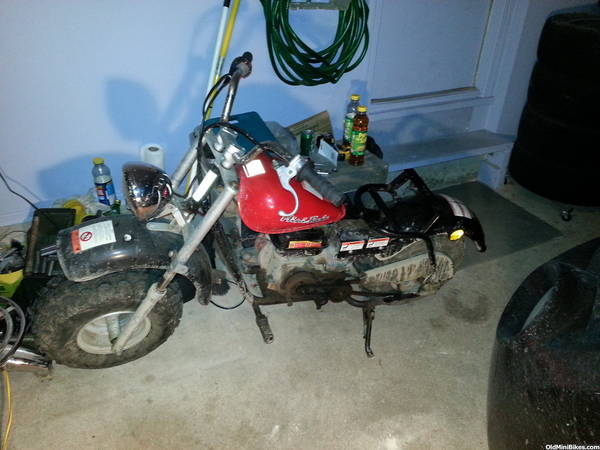

Here's shot of it just after I got it home....

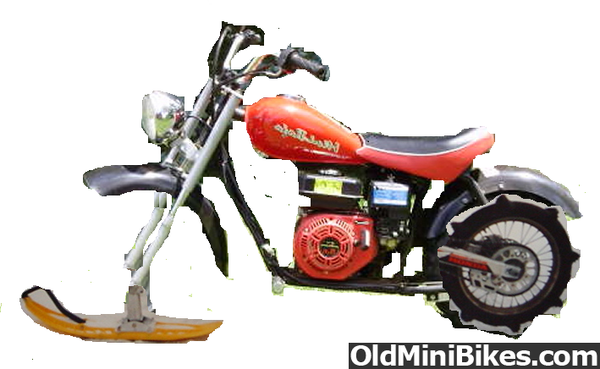

and this is a horrible mockup of what it I want to do...

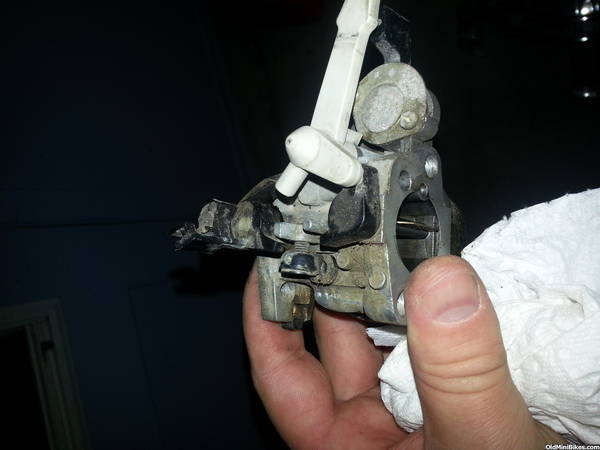

Just to give you an idea how dirty the outside of the carb is ..

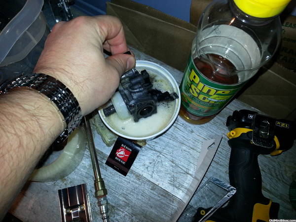

Always clean your carb, before you clean your carb ;) The pine sol soak...
I also drained the gas from the tank, it was a dark apple juice color.
#13
A day to a couple of days, it's a wicked degreaser and doesn't hurt rubber and it's not bad for the environment if you're an eco freak... Saw the idea on ADVRIDER a while back.

I like the concept but I would question on how well one paddled tire is going to push you. I just dont think its going to be enough to get good traction.
#15
Well I'm going off experience with a motocross with studded knobbies in the snow. Worked very well but the front tire sank, which was ok because ground clearance was much higher than a Baja. I'm thinking a ski in the front will help that plus the wider tire with spikes and paddles should work.. kinda like this ..
[YOUTUBE]Paddle tire in snow 3 - YouTube[/YOUTUBE]
#16
i think you should be fine with a fat paddle tire or very grippy fat tire. Like the super broncs have . they do well in the snow. sticking with one wheel eliminates alot of problems and moving parts with a track or tandem rear. plus the fact that it will be all home engineerd . like you said alot of the reason most bikes dont work well in the snow is because the front end digs in and bogs you down. if you can make a ski that works well and doesnt skid out on turns thats probrobly the way to go

Now is the time I tell you that the Pine Sol worked great, right? Wrong.. It appears to have eaten away at the rubber... there's a heavy black coating on everything. Pics to follow....
SIGH...
Pricing out all the seals, I decided to buy a new carb for 18$ and keep this as a spare.

I have ridden my baja in a few snow storms, 6 inches or less and it moves fine, after that it is exactly like mentioned, front tire sinking and rear tire just spinning trying to push the weight forward
I would think a ski setup on the front and a paddle tread on the rear would help it a lot, considered the ski setup a few times for mine then decided for the amount I snow ride it simply wasn't worth the bother
Looking forward to seeing what you come up with and how the testing goes
