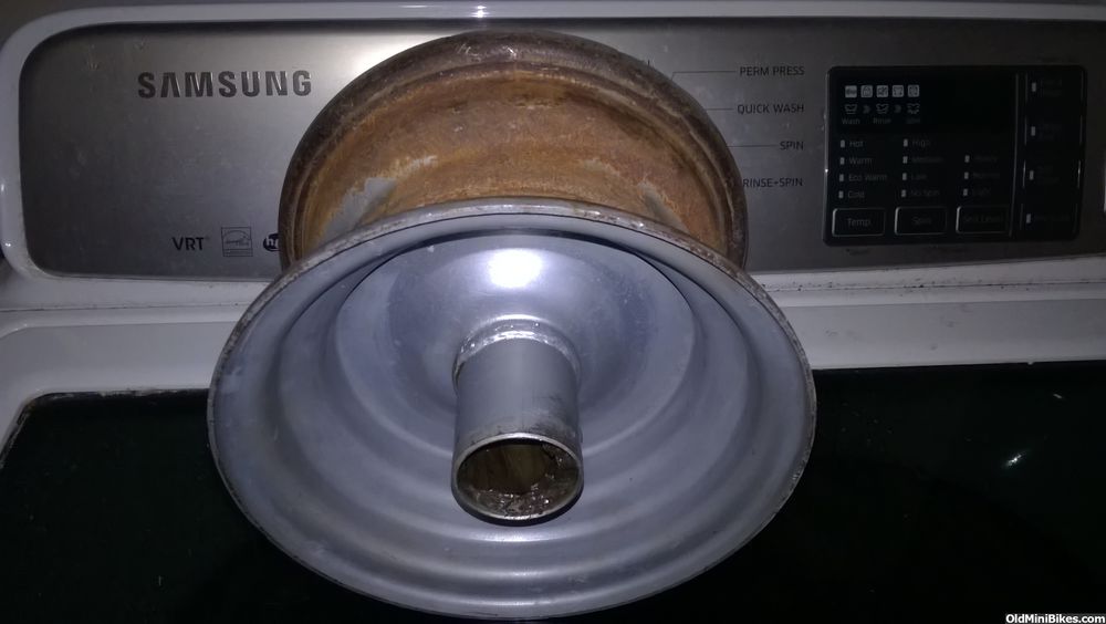

I did pick up a front wheel from Markus & will be cleaning it up, painting it white, and popping in new bearings:

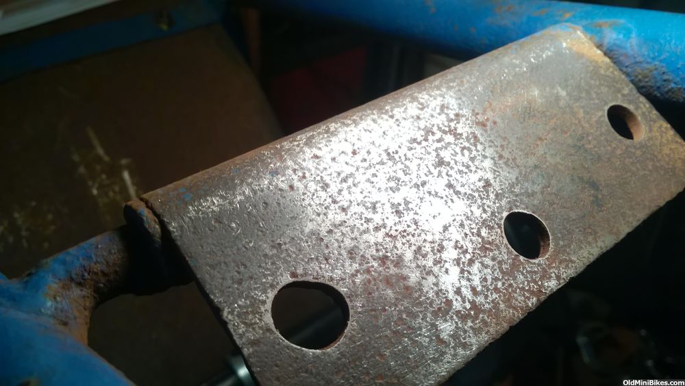

Beyond this, I have been trying to find the serial number on this thing. I do realize the s/n isn't really useful, but I was hoping to find it. The bike is heavily pitted all over, including on the seat bracket. Because of this, I am curious if anyone could point me to exactly where the number should be on the seat bracket. I believe I found some light remnants of the number, but would like to confirm:
-Rob
#29
Thanks Doc! Any idea how many digits these should have?

#31
Cool, that's all I can see as well. I wanted to validate the number before it gets painted, since the paint will completely fill in the numbers.
