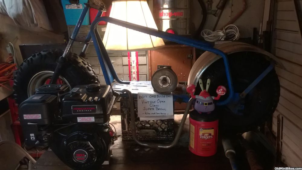

My entry for this year is a Heald Super Bronc...VT-..something. It's a bit beat up and the forks and front wheel are from something else, but this makes it a good candidate for the Vintage Open class. The stuffed toy represents what I hope will be a budget-minded build this time!

Thanks everyone- this should be a fun build. Started off with the basic mock up; due to the frame's shape, I had to remove the air cleaner, muffler, and fuel tank from the 301 for it to slide in:
The jackshaft assembly on this is from a VT5, which is apparently a much smaller bike. As such, the jackshaft is either going to have to be widened or a new one made. I'd rather not cut up the part, so my idea is to use the part as a pattern and make a new one. We'll see.

Been working on this on and off the last few weeks. Acquired the parts I need to make a jackshaft and have been making good progress there. I was going to use a stock setup, but found that the predator engine takes up a lot of space in that part of the bike, necessitating a custom solution.
Now, this bike is a bit more hacked than I initially thought- for example, it appears the fork is made from ATC shocks with minibike crowns booger-welded directly to them. I may have to find a different fork, but we will see.

Yes this was the first thing I noticed when I looked at your first picture. The wheel appears to be a Honda or Yamaha. The Honda wheel would be an ATC200X by the looks of it.
I think I remember reading that you can still buy the forks from Ron Kimball at Power Tec. It may have been an old post as I have read tons of post about these bikes since I got hurt and have been confined to the recliner.... I have not spoken to him yet but it is something I need to do. All you can do is ask....

Your frame is a VT7. Good luck on the build. ATC front end will ride nicer and be more forgiving on you.
#17
The backbone of his frame is a straight slant down and back, whereas a VT8 or 10 is flat for a bit from the front, then takes off down to the rear.
Rob, I mave have a fork setup that will work for you if you are interested, I believe it is from a VT 3 or 5? They are definitely Heald and have had new uppers welded on but a decent job done. The uppers were from another heald bike. I'll try to find a pic today of them...
