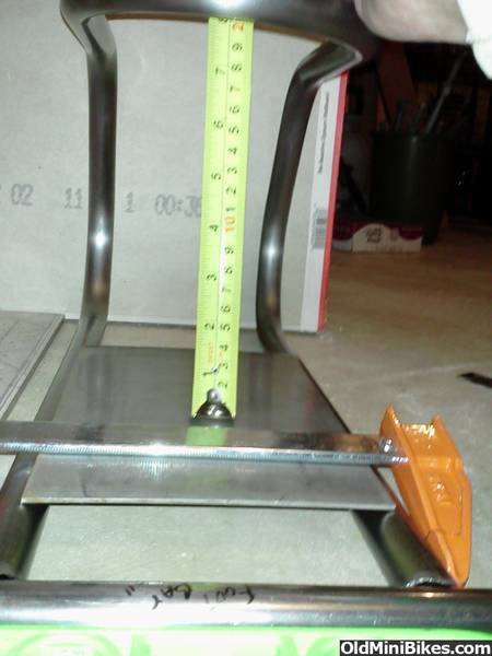

I read like a ditz sometimes, was paging back through the thread and saw the shot of the tape on the inner frame. HOLY smokes this is smaller than I thought:doah: 190mm thats barely enough room for a 6 pack of beer.
