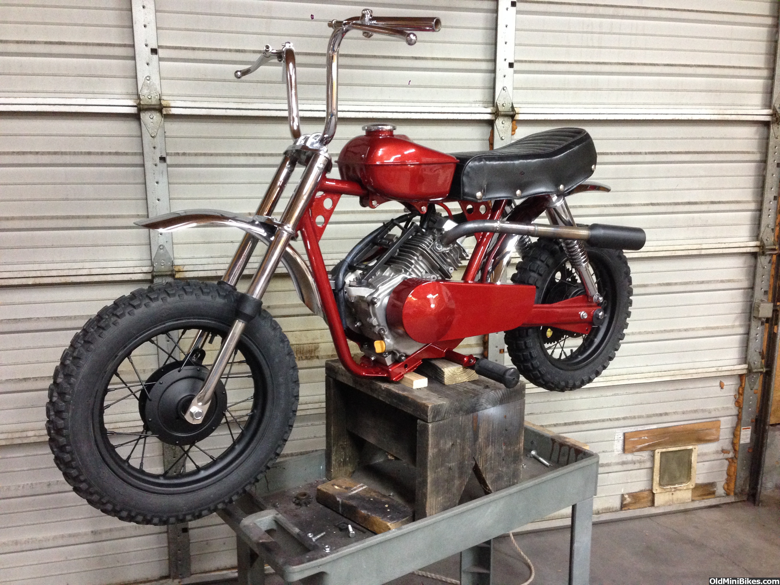

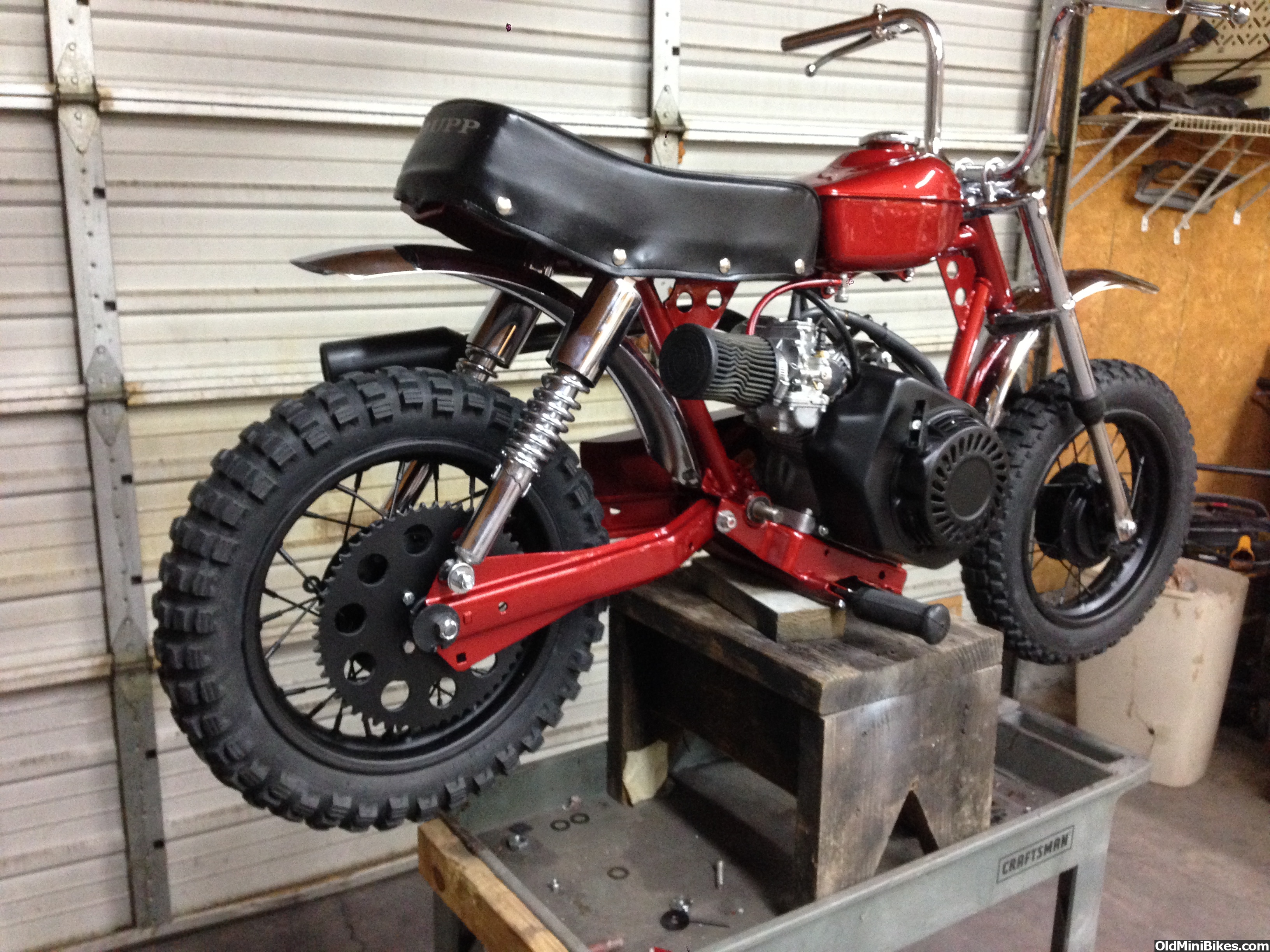

predator 212cc
rtc-6 cylinder head with 27mm intake 25mm exhaust valves
stock automotive style retainers
26lb valve springs with .060 shims on intake and exhaust sides
stock rods
stock rockers
billet rod +.020"
hemi flat top piston
.010" head gasket
ngk spark plug
billet flywheel 32 degree timing
black mamba camshaft
stock rejetted carb
header
what would give me the most bang for the buck? I'm thinking an oko flatside 24mm carb might be the best bang for my buck... anyone run a 24mm flatside? any suggestions for jetting? Thank you guys :laugh::thumbsup:
