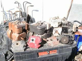

These four 5hp Briggs are bearing sidecase engines.
The engine behind the red loose sidecover is an IC engine.
....All 7 of the covers look about the same to me.

Yeah.. look at the ones in Macs pic... The bushing engines have an aluminum nub that sticks OUT of the block.. The bearing plates, the crank shaft end is recessed down in a little ways, because it's resting in a bearing, deeper inside the motor..

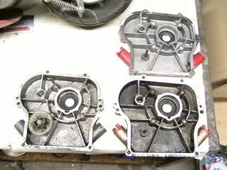

Most commonly the dual bearing 5hp I/C briggs left the factory with a small bearing sidecover. The Large bearing sidecover was used for single bearing engines.
........Ahhh, but how do I know if these below are, or are not IC dual bearing engine sidecovers?
#13
Most of the I/C duals were painted red or grey so the top sidecover is most likely for an I/C. Before the Large Bearing sidecovers came out, the single bearing engines were small bearing sidecovers.
Anyways, all three of those look to be small bearing sidecovers.:shrug:
