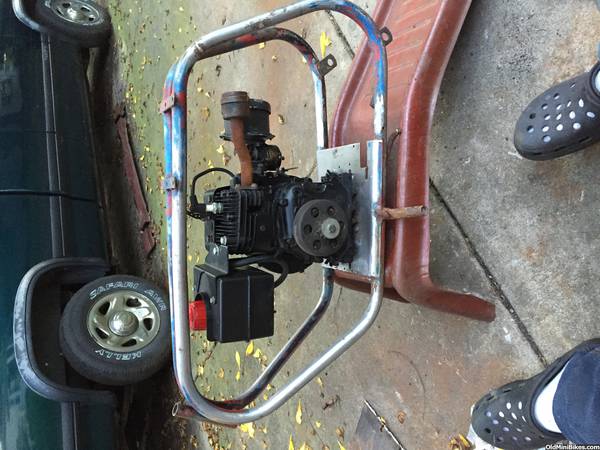

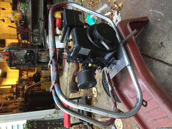

I picked this bike up back in August and I have finally started working on it the past month or so. When I got the bike you can see what kind of shape it was in. It had a non running '59 briggs 2 1/2 hp engine and conduit in place of the rear shocks. It also had a chunk of the frame on the lower right side that was completely rotted away. It was missing the jackshaft and the rear wheel was flipped around so the sprocket was on the wrong side. I fixed the frame right away and started accumulating the missing parts to get the bike up and running.I had a '62 Briggs 4hp so I decided to use that motor for now. The last pic is where I left off with the build until this past month.
