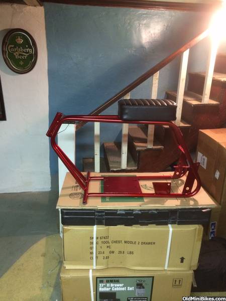

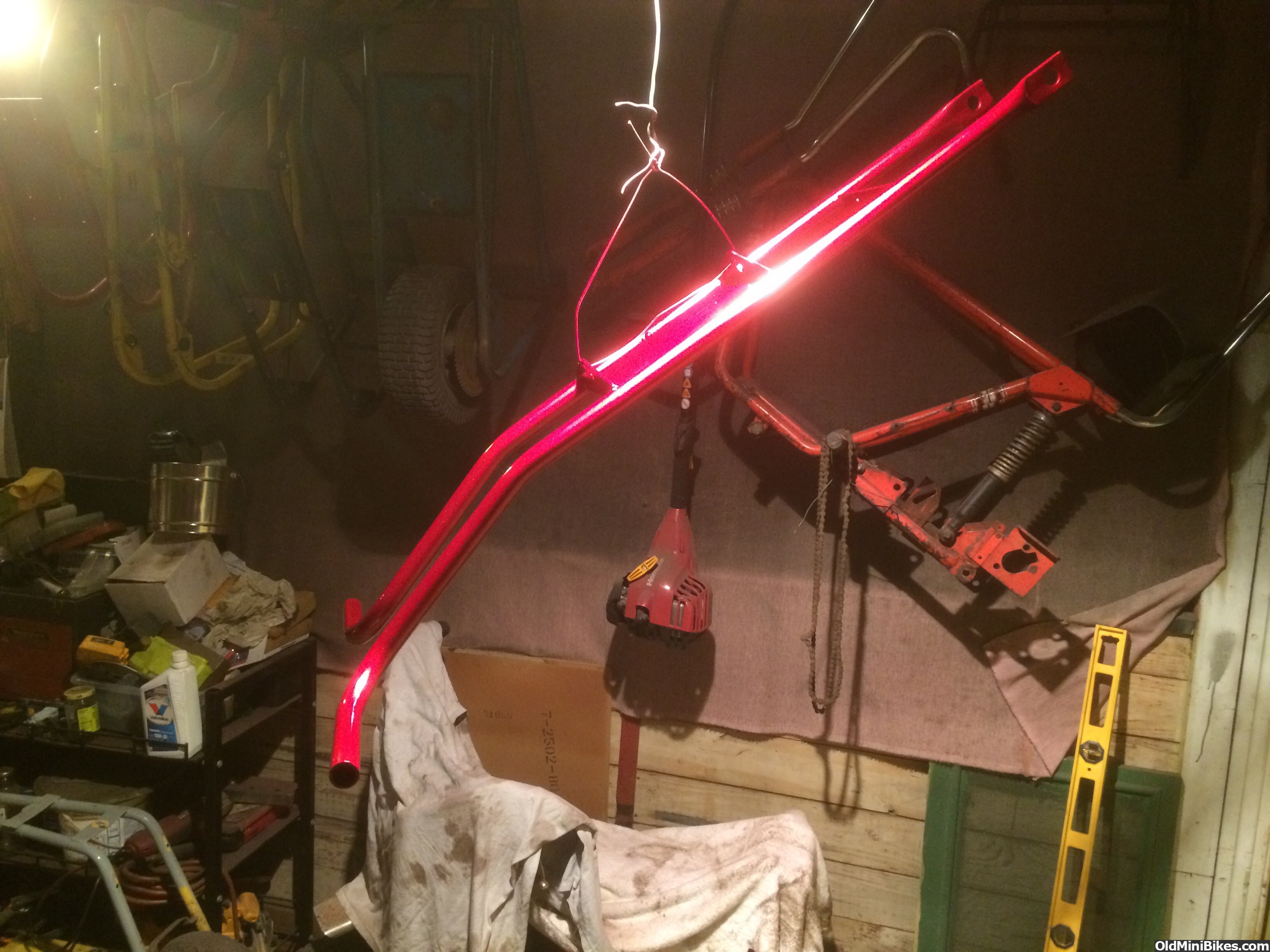

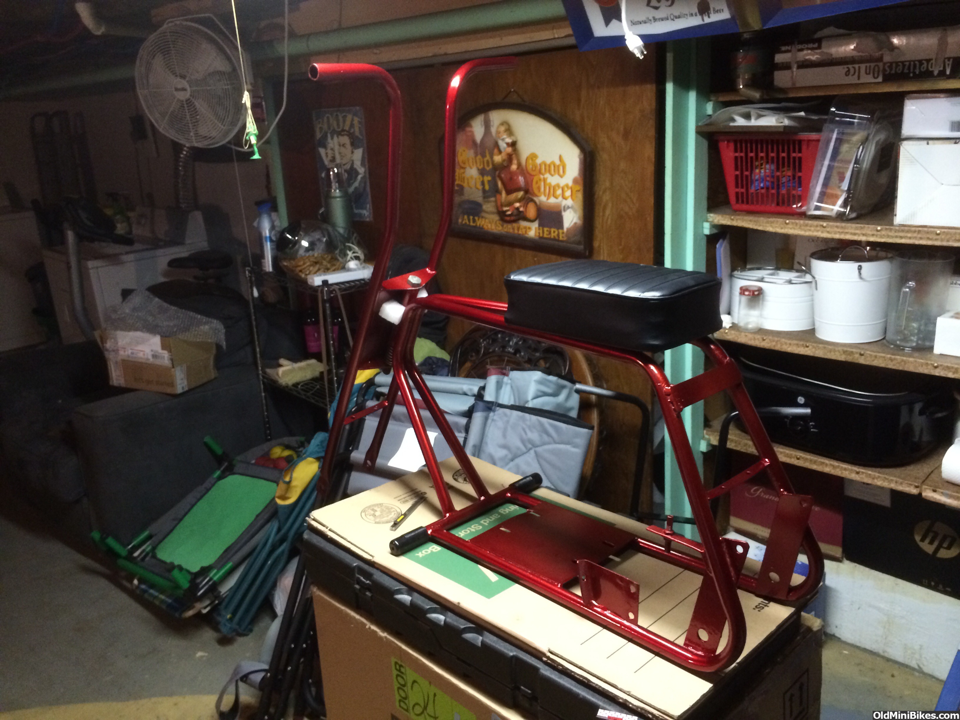

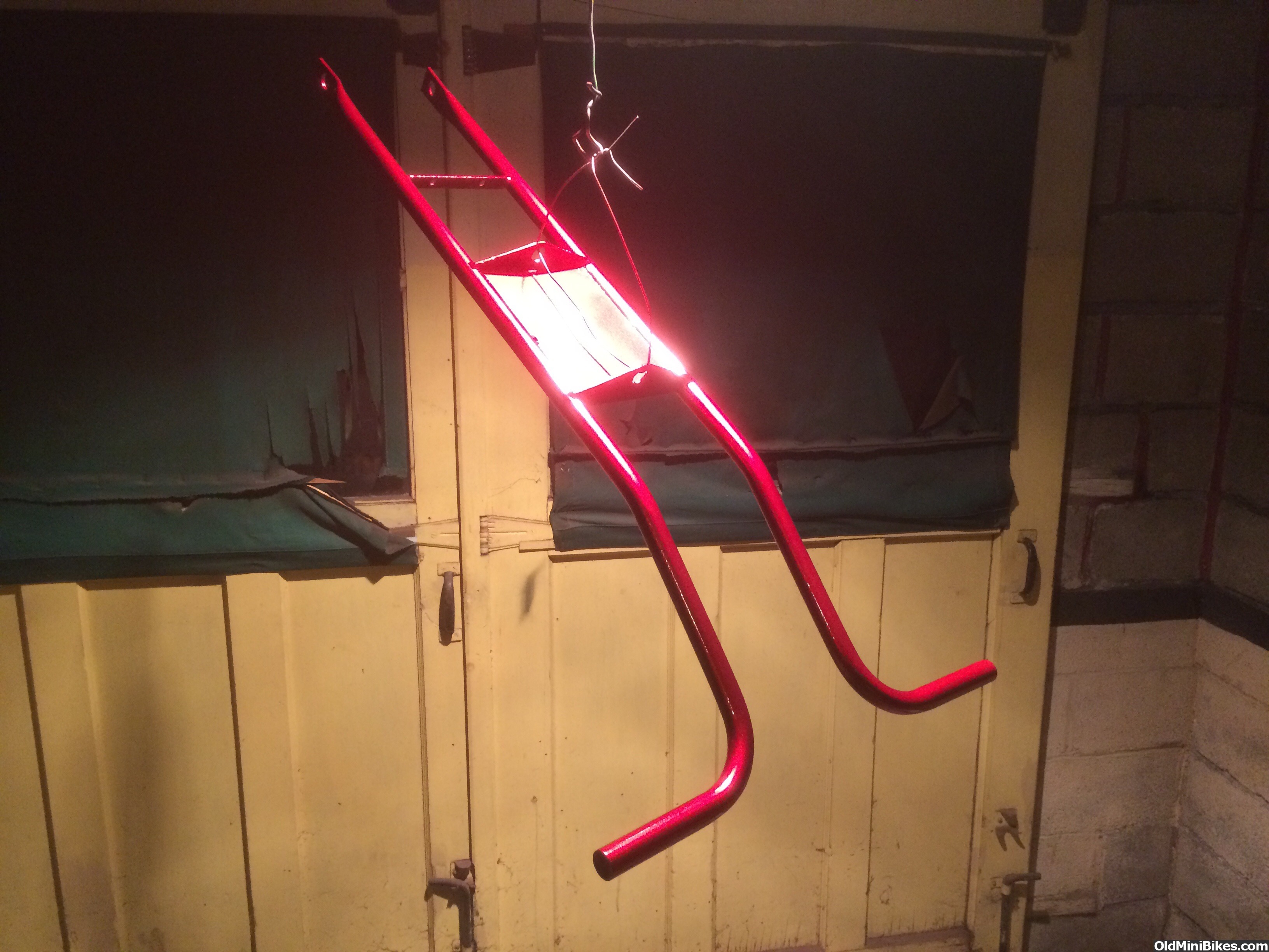

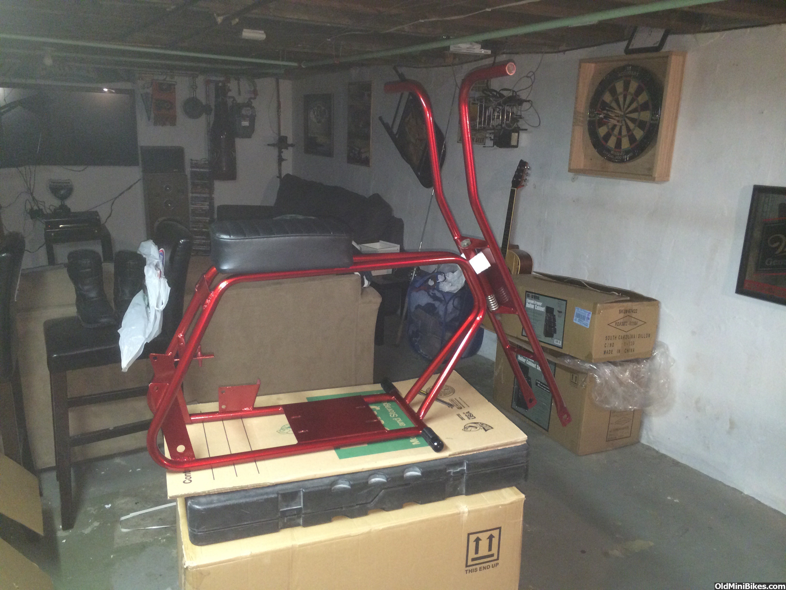

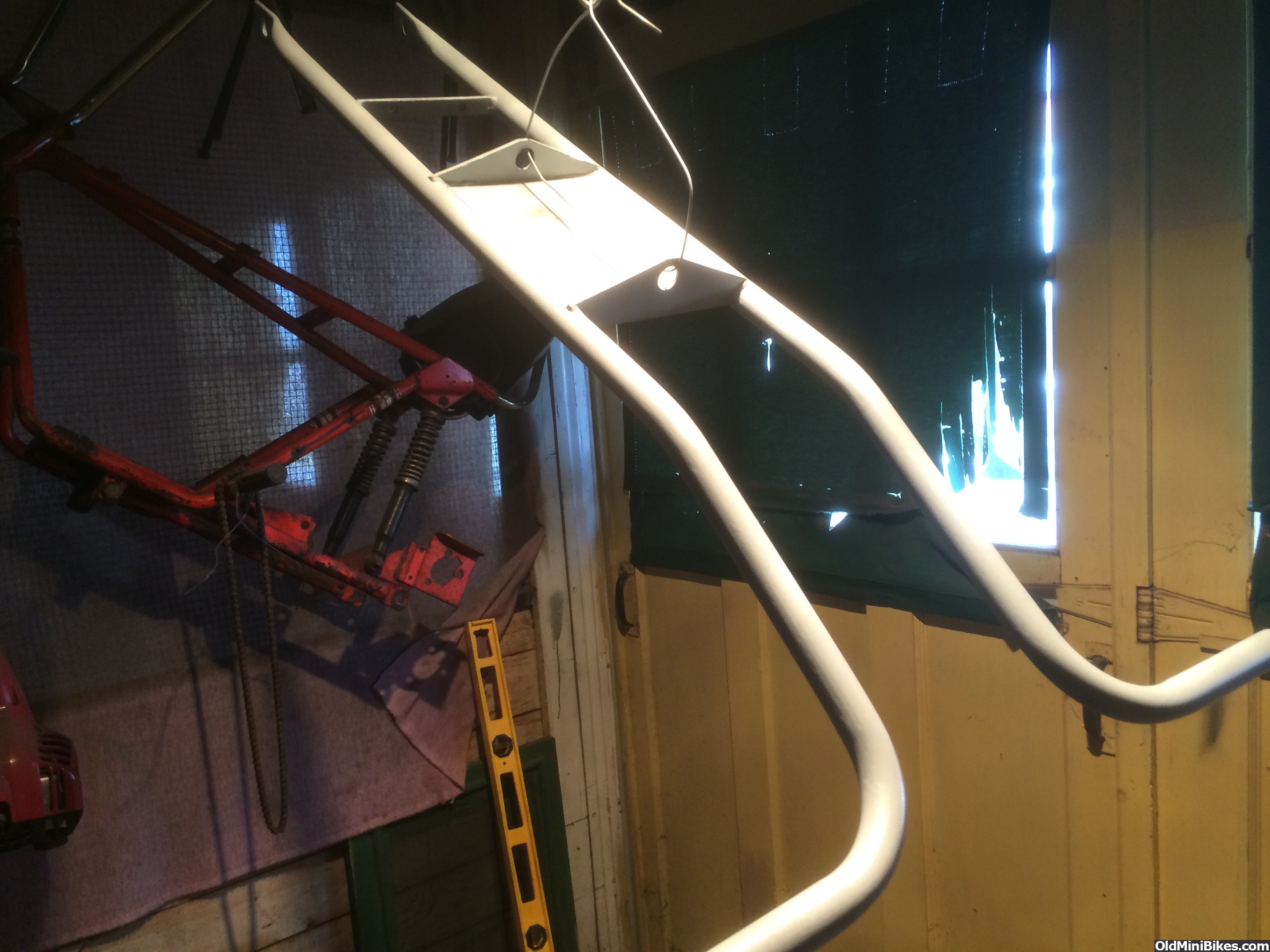

Spent Friday night in the garage till 3am then Saturday night till 2 and all day Sunday. Managed to get the forks stripped, cleaned and up on the hook. Put 3 coats of self etching down sanded. 3 coats of filler down and sanded. 3 coats of sealer and then a can and a half of metallic red paint. Which ended up being 3 coats. Finished it of with 2 coats of clear. Ya I know I'm weird like that.
The pictures do it no justice bc these forks look amazing. The red really pops when you put the clear on it.
All that's left to do is out it all together.
