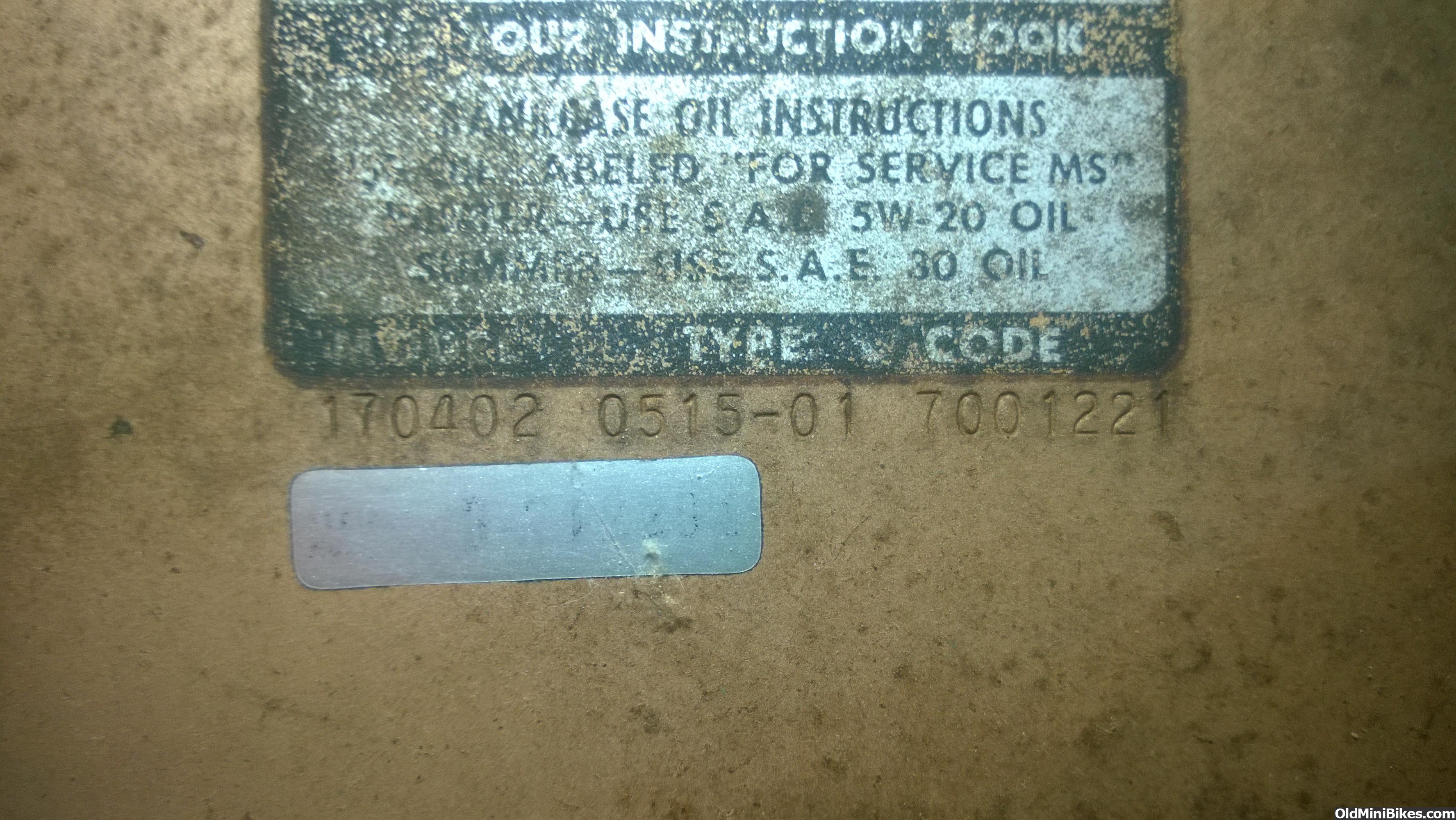

Hello all, I started looking at an old Briggs engine I have, which has no spark. I tried to find a diagram and parts list, and any information. I came up blank. The number stamped on the engine is 170402 0515-01 7001221. Does anyone know anything about this engine or where can I get some info on it ? Thank you in advance.
