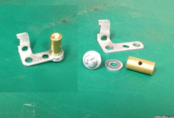

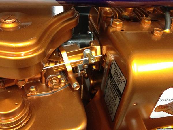

I made a metal lever that installs the throttle cable at the back side of the motor using the existing clamp and screw. I call it the R67 rear throttle lever. :smile: Use a hardware store 90 degree angle.
File the notch in an angle and round off so it doesn't bind with the other lever. You can also bend the angle more to reduce any binding. Round the corners to match the other levers.
