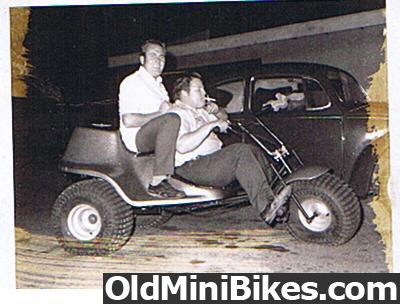

So I'm trying to figure out the dimensions. Looking at the pics on here and using tire widths as a measuring guide the Trisports seem to be 40-50" wide at the rear. Don't know about length. Can anybody give some ideas on dimensions that would work? While I'm at it I have also been chewing on making this a tandem two seater with the two seats fairly close together requiring the back seater to sit legs open to accommodate the driver seat which would be very close to keep the overall length down as much as possible. If speeds are kept at the 20-25 mph range on open pastures would this be OK or is it best to leave these style trikes as a one-seater?
