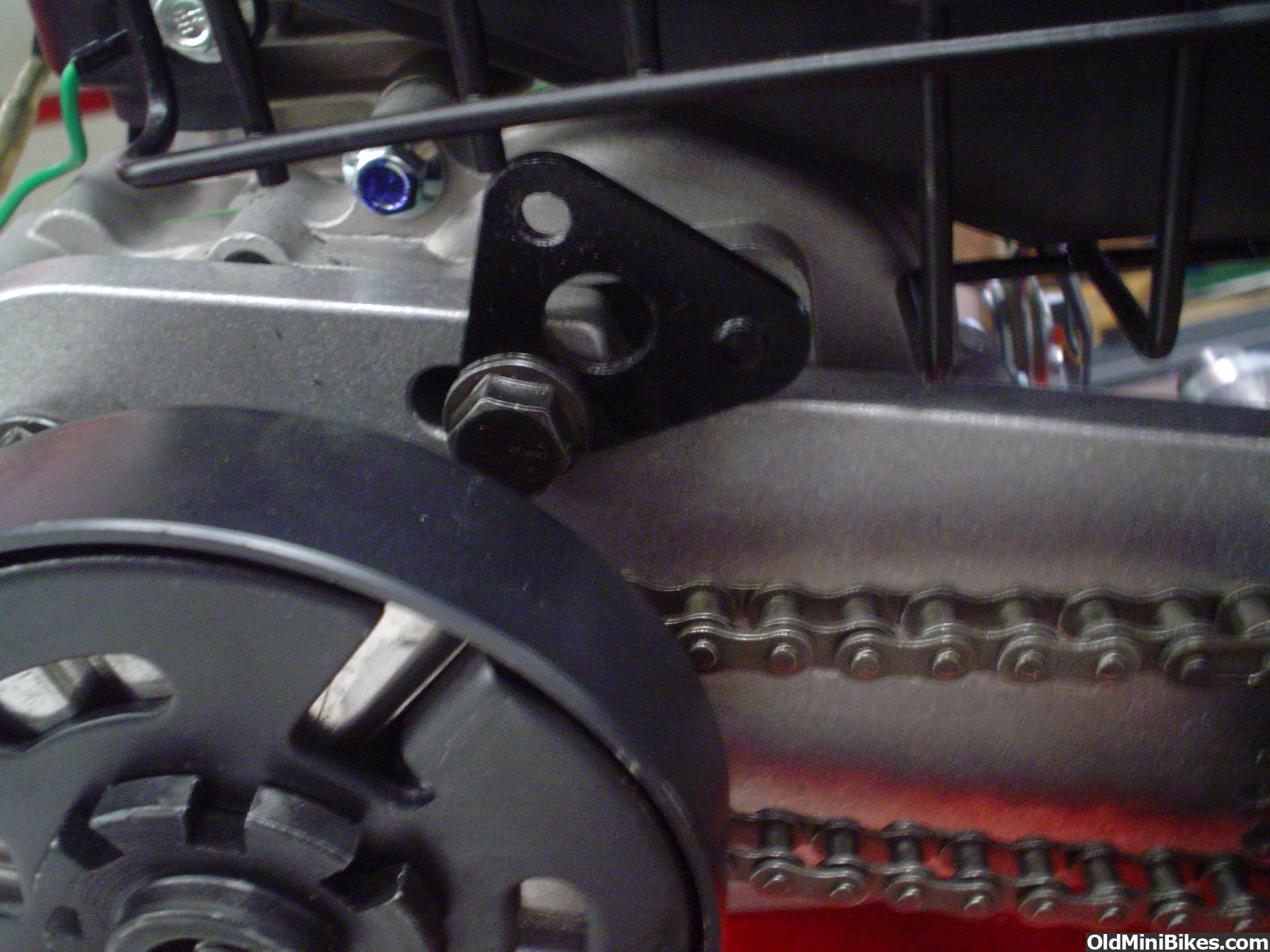

BUT the 2 that are running are pretty sweet. I am really impressed with the engines. I am in the "Lowcountry" of South Carolina and there are little or no hills. The performance was OK here with no jack shaft. We camp upstate a lot so I knew the JS's were needed. Now that I have one installed I am confident that the JS will add life to the 2.8. I also agree with a poster (I forget who it was) that stated that this jack shaft would be a great fix for project bikes that wanted to use the Harbor Freight 2.5 Lifan engine for the little ones.
It is almost like they should have renamed the "new style" Doodlebug something else and kept both frame styles. The new style fits my 8 year old perfect, but it was a little compressed for my tall gangley 11 year old so he has the "old style". My 8 yr old weighs 60 and my 11 yr old is 100. The js conversion got them both excited and ready for hills, plus it was a great mechanical engineering lesson having them fight to loosen bolts and figure out how to put it all together again.
