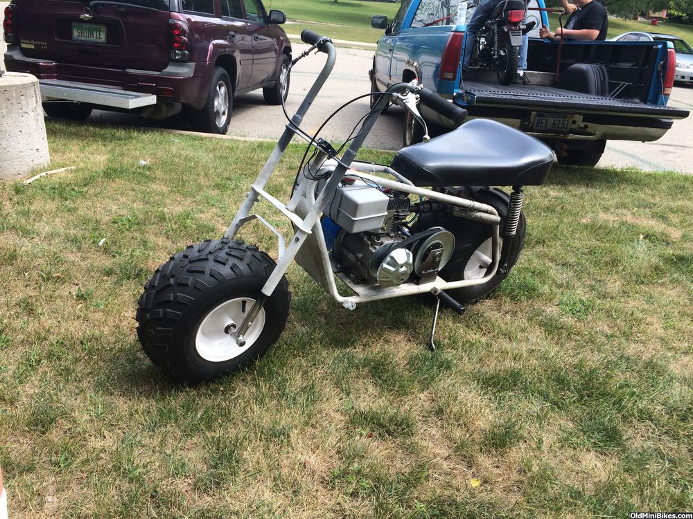

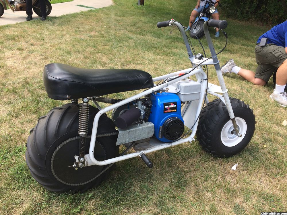

3-27-17 I picked up a Heald VT-7 with a vague idea about what I wanted ... I am still a far cry from where ever that is!
Sunday 8-6-19 was the day she was ready to hit the streets and trails!!

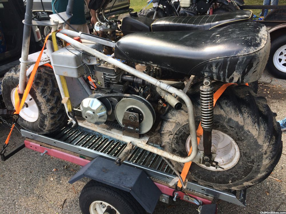

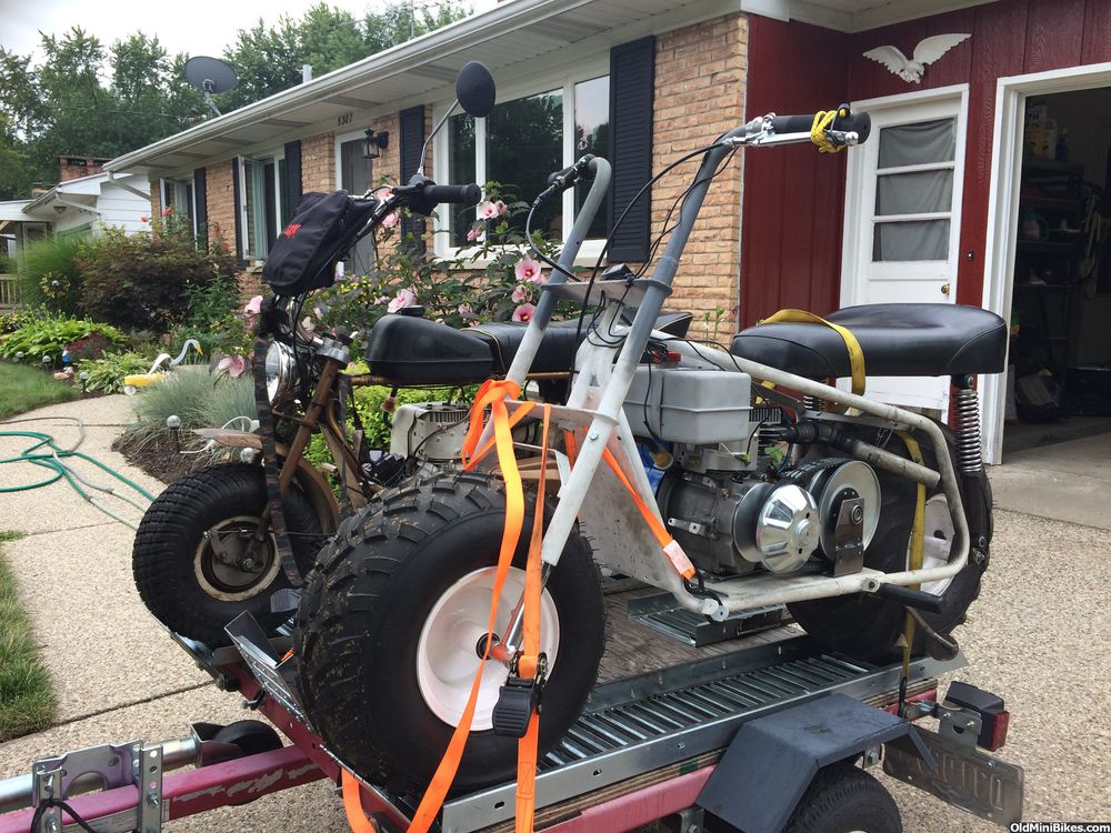

We buckled her down to the mini bike trailer and were off!

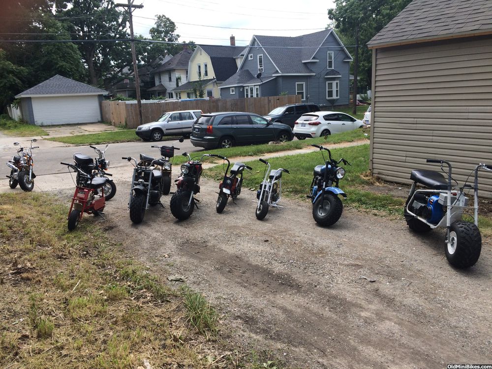

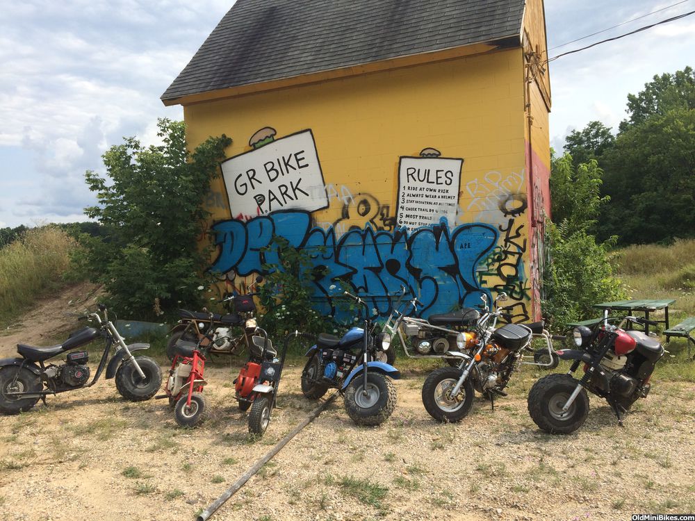

We met up with some friends at a school, drove around a bit on the surface streets and alleys ...
Then rode back to our cars for a second ...

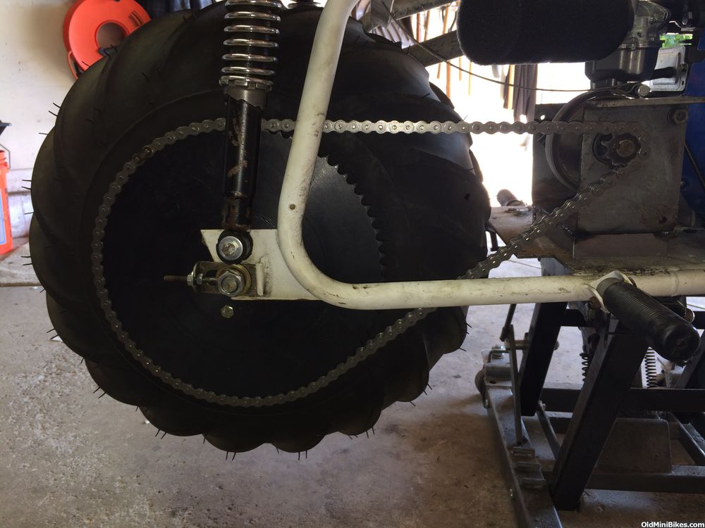

As expected the gearing isn't even close to what I want, it performs much like a VT-10 ... I won't harp on gearing or getting the motor into the 7000 RPM range .... today is just to shake her down ...

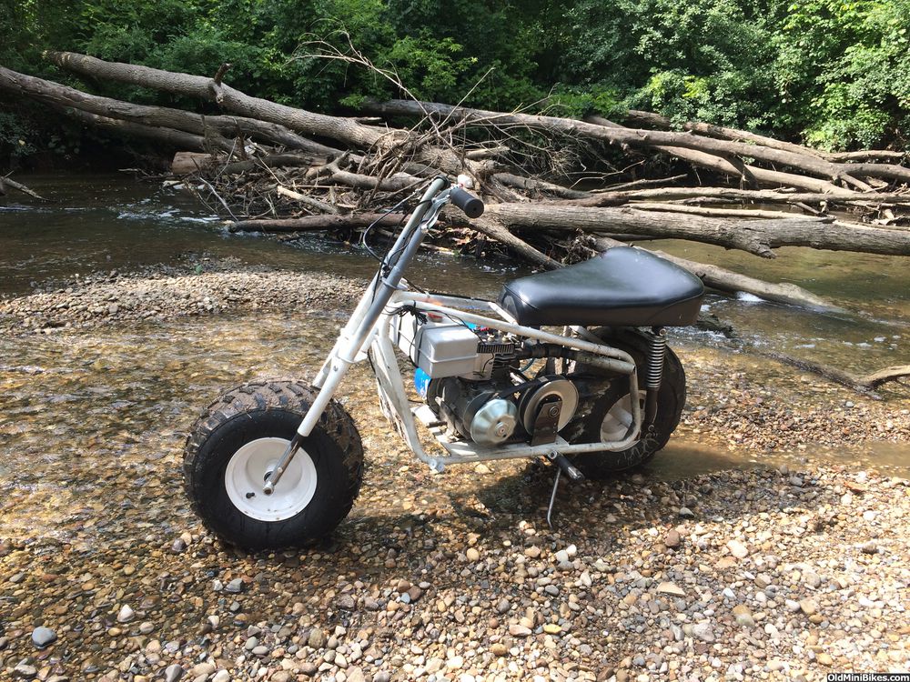

She started easily and ran what I would call flawless.
The Mikuni is very nice, smooth idle, responsive, better than a stock carb to be sure!

We found some mud ....
I chose not to put the fenders on ... that's was not a good idea!

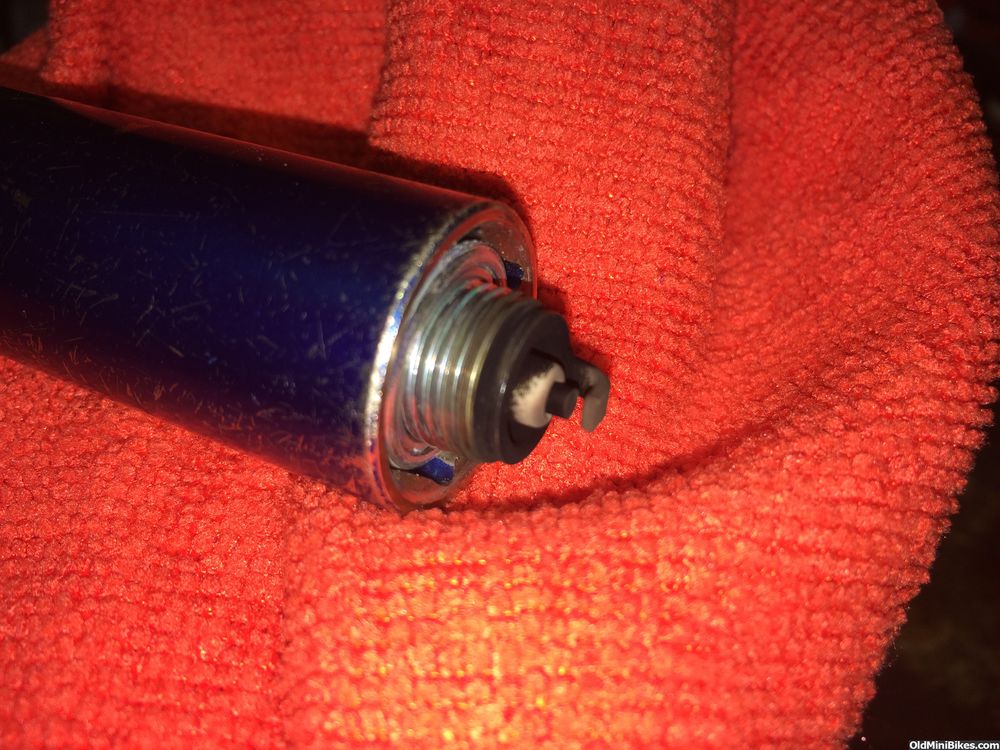

After 2-1/2 hrs the spark plug looked like this ..
She got up to 4200 RPM but was mostly maxed out at 3800 RPM.

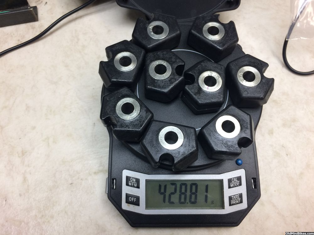

Drilling the Driven pucks made next to no difference. Engagement was about 1900/2000 RPM.
Out of the hole I was about the same as other minis in our group with the exception of the Baja with a warmed over 212 Predator ... he was faster out of the hole and had better acceleration ... but while the Baja topped out Dorothy kept pulling like a freight train ... still seems like RMP and MPH are about the same ... (4000 RPM = 40 MPH)

As she is now she is a well behaved and excellent running bike.

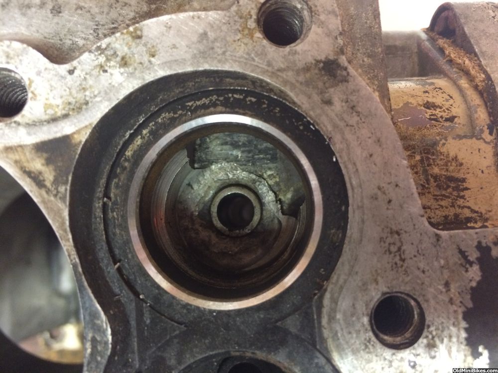

Next up on the list will be gearing and getting the stainless steel valves in the motor.
