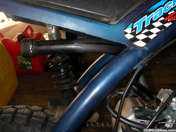

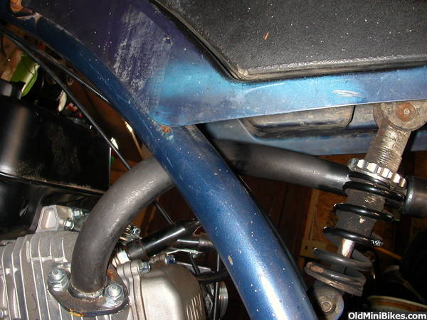

Thats what i had to do. Not having a welder, just shear desire, i used some bent tuning and a flange. Cut all the pieces and put them togetherwith hose clamps. Marked each joint with a sharpie then took it to my welder. It can be done! Prob with Murrays is the shock is in the way and most pipes go out the back, right in the middle good luck
I ended up just putting mine on the outside. I used the stock exhaust flange (cut it off), 3/4" EMT conduit elbow (I used muriatic acid to remove the zinc. VERY DANGEROUS!), and a 3/4" SST coupling from amazon for the exhaust mount. aDn2A4q.jpg
Looking at Harleys Papas header I forgot that I had to angle mine down slightly to accommodate my body weight compressing the shock slightly.
After I mounted it I rode a little and smelled melting plastic under the seat. I went back to the house made a pie cut the header and re-welded it and it cleared then. No problems then.
