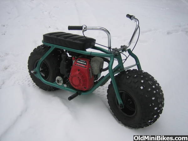

After looking through quite a few build logs I stumbled onto Jeep2003's build log of a bike he made from an old swingset! I thought it was awesome. I now had a direction to go.

Jeep2003 is checking on his tire size so I can see if I should use the same drive ratio as him, or if I need a greater ratio. I'm thinking aiming for about 9:1, but really don't know yet. The big tires may need 10:1. Anyone have experience with this?
I would like to use a brake caliper that mounts and grabs onto the sprocket. My thought is that this will help keep the rear end as narrow as possible. Are these any good? Would I be better off with a band on the clutch?
I will probably use either the 212cc engine from Harbor Freight or the 208cc engine from Northern Tool. The one from Northern is a few bucks more, but it appears to be a little higher quality. They both get good reviews, so it may just come down to price when I am ready for it.
