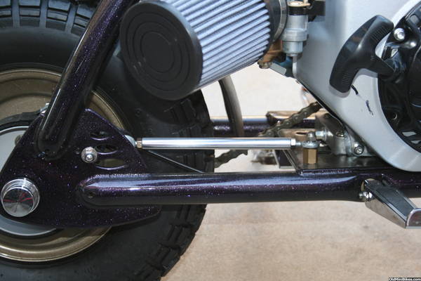

Well, I got this Murray Track II a little while ago. I had been looking for one because I had a picture in my head of what it could look like. RobertC was kind enough to let me know about this one.
First, I took it apart and cut all the brackets and stuff off the frame that I didn't need. I also cut the left rear axle plate to look like the right side. Then, I welded a section of tubing to the frame for my seat mount. I sent the frame, forks, wheels, and new sprocket off to the powdercoater. I had the wheels done in Silver and the rest done in Mirror Black. While I waited, I ordered lots of parts and got myself a 212 Predator.
I didn't get any "before" pics because it looked like every other Murray that has been rode hard. Here are some pics of the project. It runs really well, and I think, looks even better! Let me know what you think.
