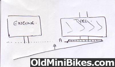

Do you have a pic showing the alignment.
Simple trick i use is a piece of fishing line, hold it against the rear sprocket at the most rear point , then move it forward till it touches the other side of the rear sprocket ( see Pic) This works better than a straight edge as you can have the clutch on the engine and line up up with the smaller sprocket.

Thanks for the tip. I followed your advice and had better luck. I did a couple of "full power" runs on the bike tonight and the chain was fine.

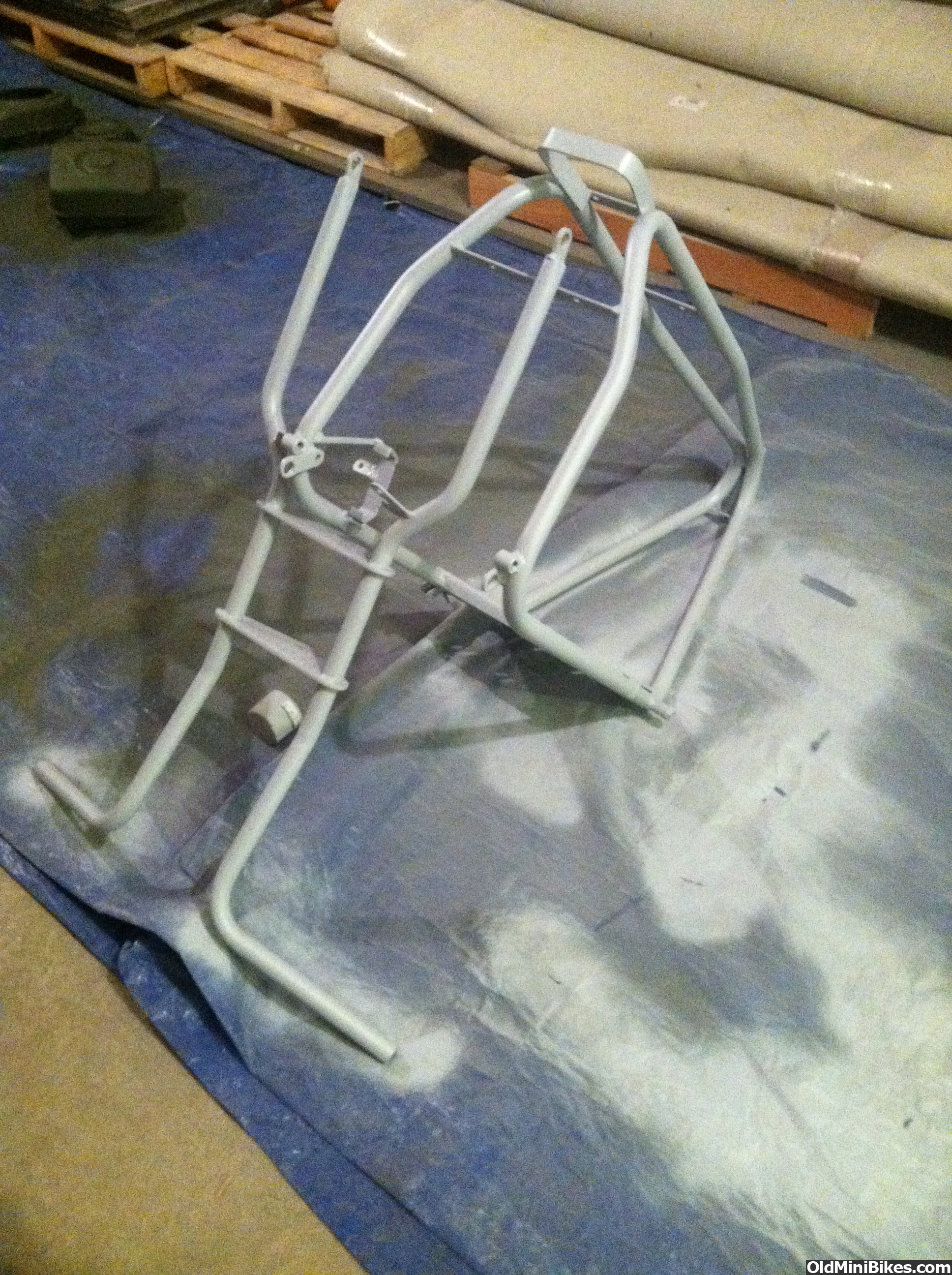

The Bad Dog project continues....

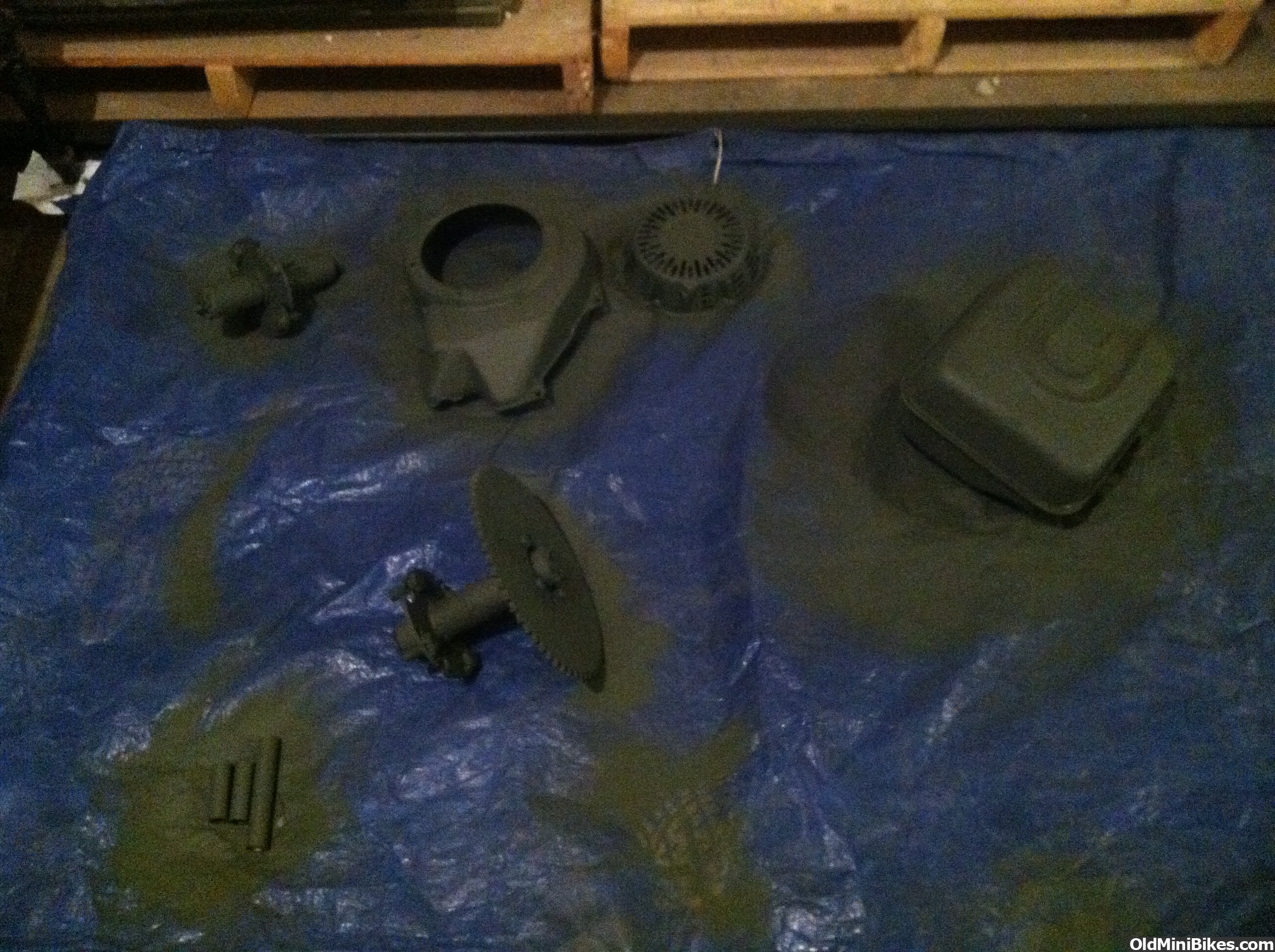

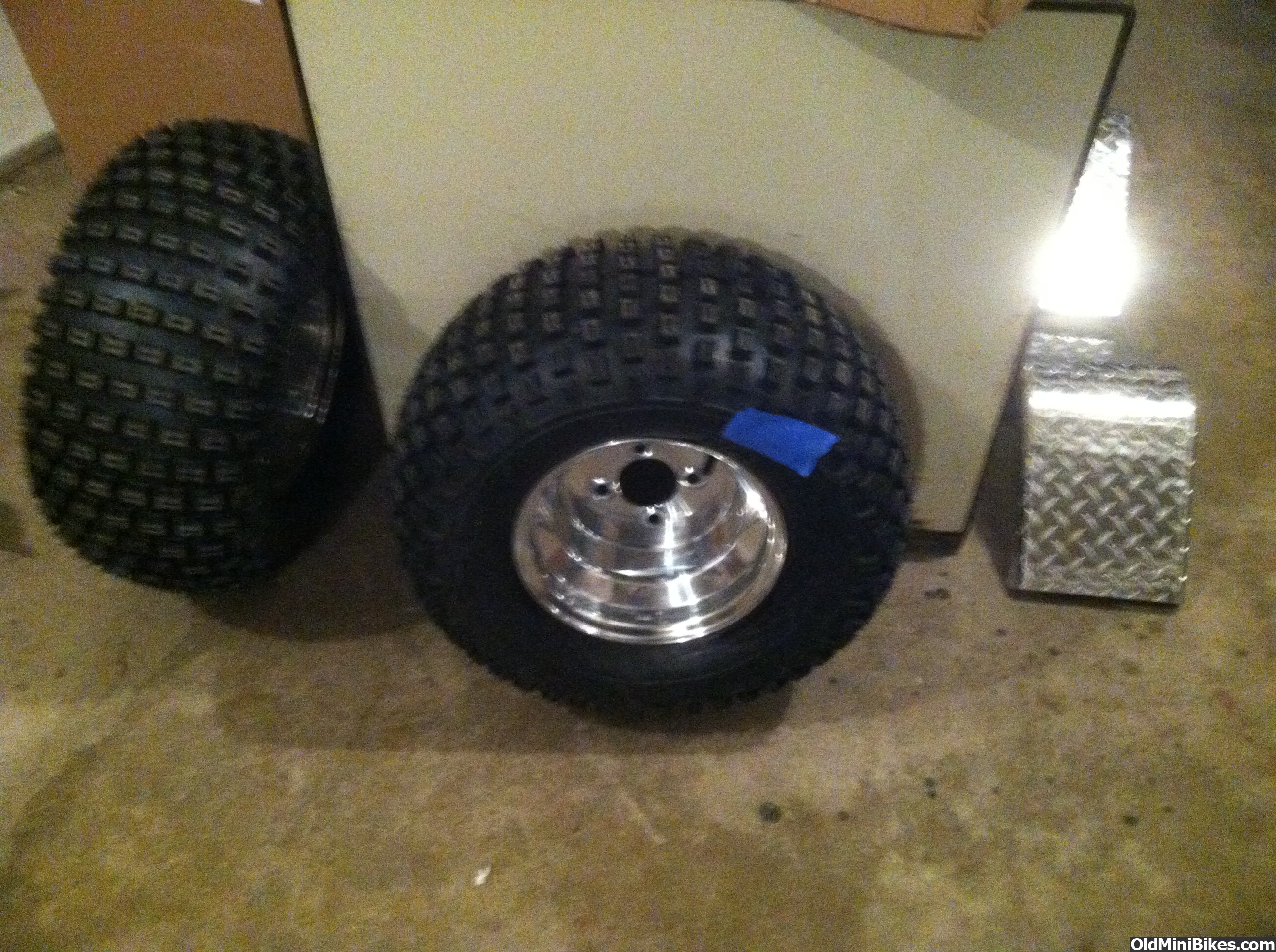

Today I had a little time so I sanded and primed the frame, painted some engine parts, and treated the aluminum wheels to Shark Skin. The Shark Skin should keep the wheels and fenders looking good. I am going for a military/utility look. The paint is an olive drab and the aluminum will be unpolished but bright.
