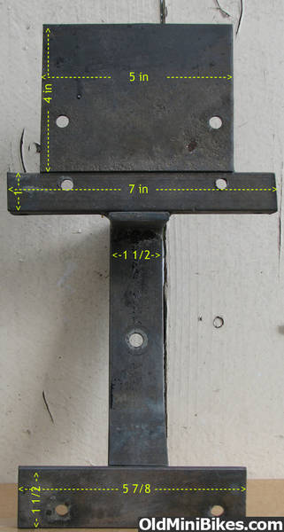

I am talking about the seat metal frame it looks wider than the challenger. I need to make that metal frame tomorrow. If its wider I don't want to copy the frame. the design looks different than the older bikes. could I get a pic, and dimensions.

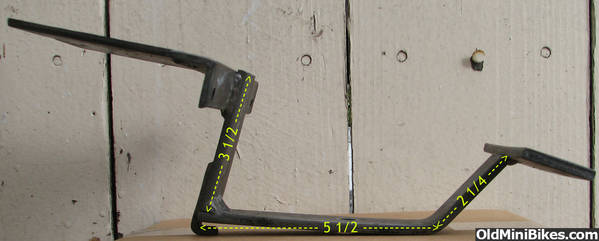

Yes the seat bracket is way different from that of the challenger I'll snap some pix tomorrow.

Holey crap figures, I have the steel for the copy of the chalenger. looks like they didnt go with the long strip on the top just a couple squares. Is it the same size steel. this is just gitting too tuff. I need a complete bike to copy.

what is the 4"x 5" plate of steel for? And how thick is the 1 1/2 steel. the challenger is easier to build. the front looks to be close to 45 degree the rear looks 110 degree. the lines on the fence helps with the radious of the bends. looks like 1/4 steel and 3/16 on the angle iron and 4x5 plate or maybe 1/8 in? Shure would be easy to copy with the piece setting on the bench.
