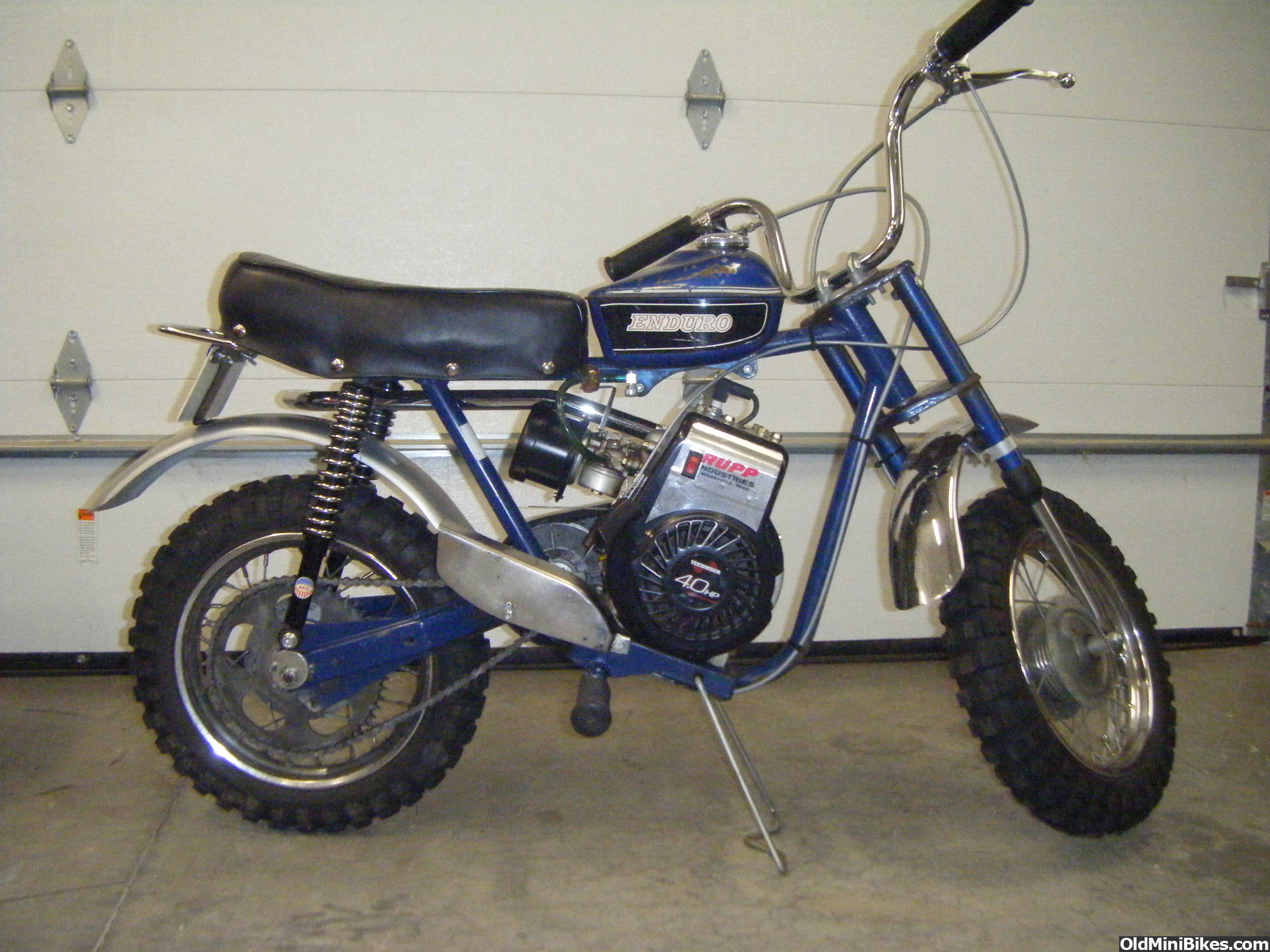

Try it with out the adapter. For 4 years now I have run my stock Powersport 4hp Tecumseh with now problems what so ever with out a angle intake. Starts easy and rides fine.

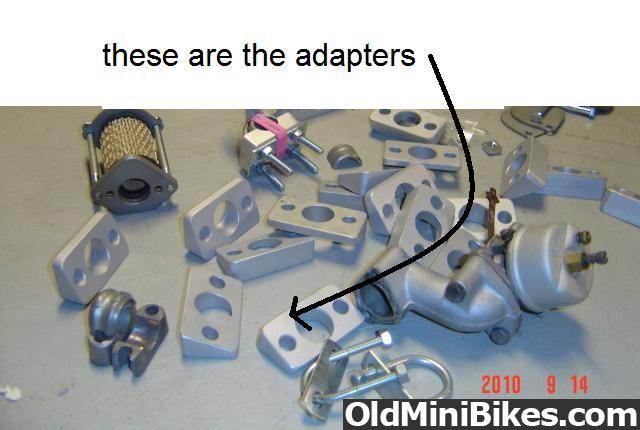

the guy's name is Hamlin57. he sells an 20 degree aluminum adapter to level out the carb. It helped me. I couldn't get my carb to stop leaking. I tried everything. A little trick is to take off the bowl and put a screwdriver in the little tab on the float and open it up so the float is hanging down a bit and not level. sorta like this \ not this __ this way the gas will close the float sooner, and it wont fill up with gas. A shut off valve help a lot too!
Good information - I've shot Hamlin57 a PM hoping to see what these intake adapters are about. May not need it if I have the same good fortune as minibikedude, but I'll check it out if he writes back.

I have one of those slant intake adaptors, But, I still run that engine the way it came. Because people will tell you it won't work that way. So it my way of proofing them wrong.
I rode that bike for 2 days in hilly wooded trails last Labor day and it never missed a beat and I,m 250lbs rider on it. Carburetor is also level when going up hills too. Does good at Windber too on the trails.
So, I guess what I,m saying is. Try it out and you maybe surprised how it runs and if you get a slant adt. try it out for comparison.

furyus, try it the way it comes like minibikedude says. you never know you might luck out and the thing wont leak! But Rupp put a slanted intake or a diaphram carb on their bikes for a reason when they were building them! no? Another guy on the list Charlie D. is redoing a Rupp Scrambler I think. He was having a problem with the leaking and I hooked him up with the adapter dude. I haven't heard from him in a while. Maybe I'll send him a pm and see if the adapter helped him at all!
If you decide to go with a slanted intake don't make the mistake and buy one that fits the 4.0 hp Tecumsehs because it won't fit the 3.5 hp Tecumsehs.
