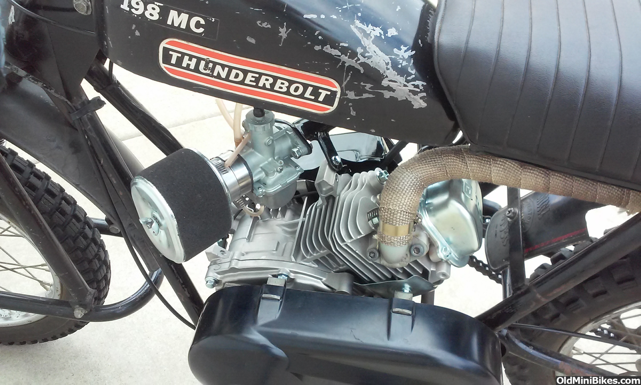

bryan, your making it to hard on your self. if your going to just use the engine for riding around on your minibike? i personally would only go .050 on the head and black mamba cam and stay with the 1.1 rockers(maybe if the money allows, go with rollers) now if i am right that cam has a .275 lift? if you add 1.3 rockers that puts you way over .300+ lift. i personally don't see how your setup will benefit the way your engine his setup and for what use your going to use it for. also you may start to run into valve to piston clearance problems? wait until you mill that head and have it installed on top of that flat top piston and you still have to pull it over with the rope. not impossible to still pull it,but you will feel it and you will really feel it when it kicks back on you...
if you do go with a 22mm Mikuni, i would have at least a 120 jet to start out and a 12.5 pilot(stock) you may have to go with a 15 pilot,but you won't know until you have it running. also you might be bumping the jet higher. for example 122.5 or higher(look at the plug,it will tell you what to do)
also one other thing when you have that engine running. you can forget about trying to idle around at very low speeds. your going to find out that it's going be on it or off it. but its alot of fun cracking the throttle wide open...........:scooter:
patent pending intake......:rolleyes:
