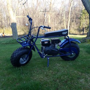

Hello,
I have a Coleman mini bike with a gx200, and I'm looking to take it to the next step.
What I have:
-Intake, Exhaust, & Carb re-jet
-Billet Flywheel with 8 Degree Advance
-18lb Valve Springs
-Stock Governor
I just ordered a 14cc head for the thing, but I would also like to run...
