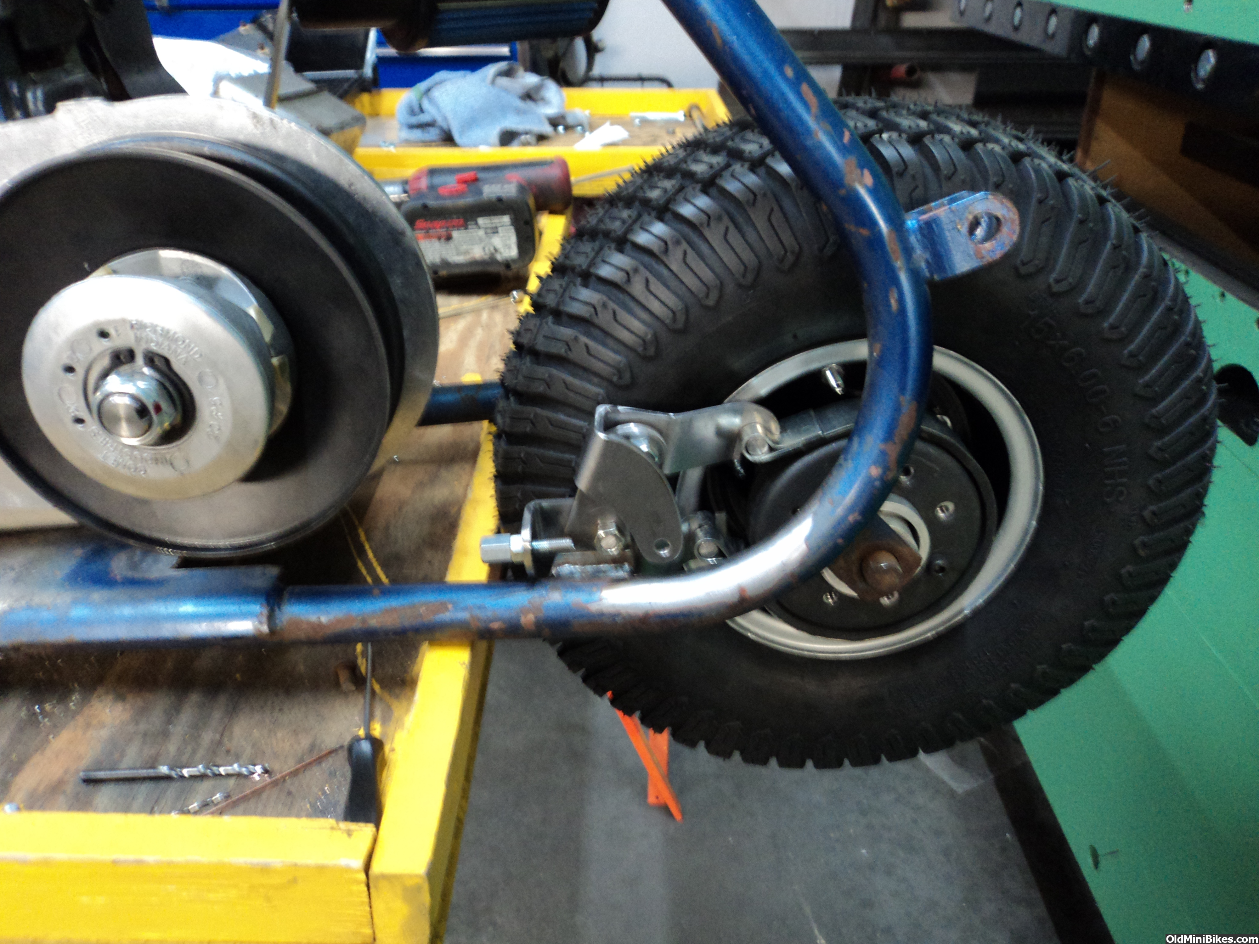

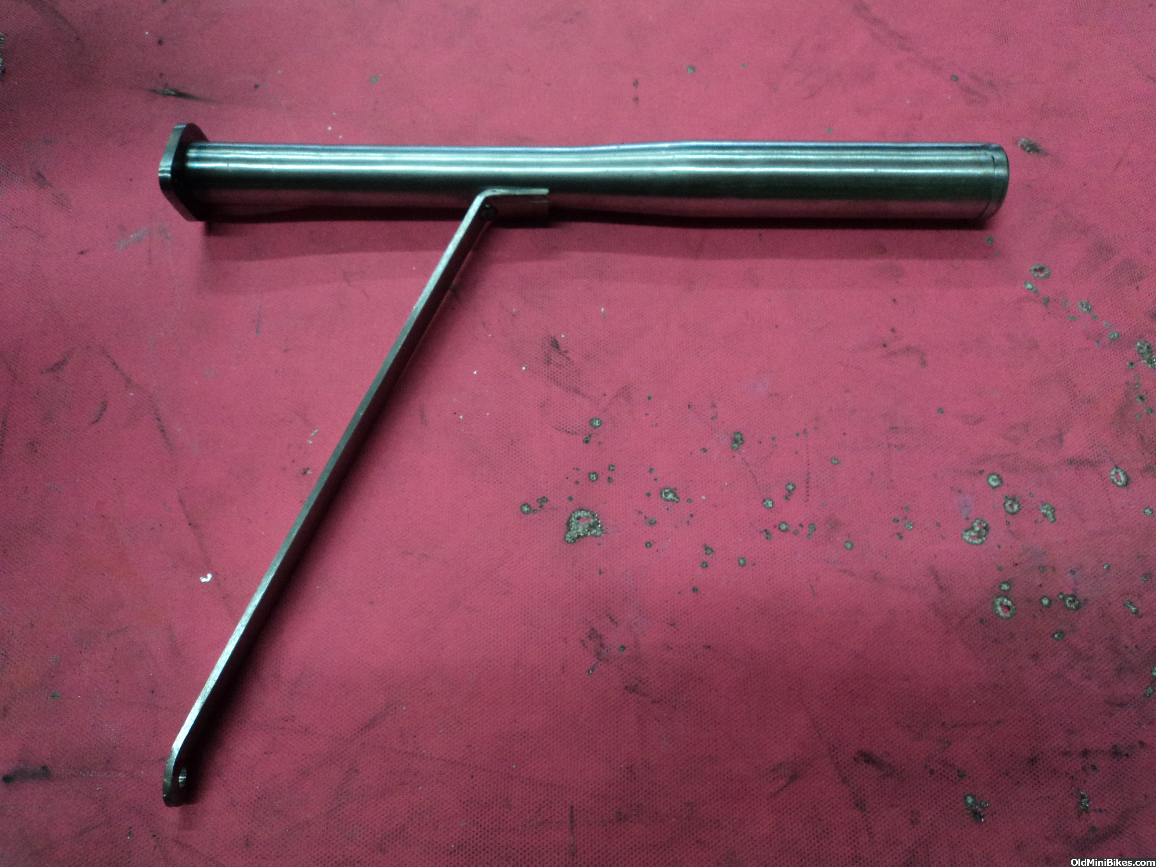

I was thinking how is he going to setup band behind the sprocket... Well now I know! Awesome design & fab skills.
#24
I was thinking the same thing .... And I am damn impressed !!! I guess a hot rod needs a functional brake ..lol

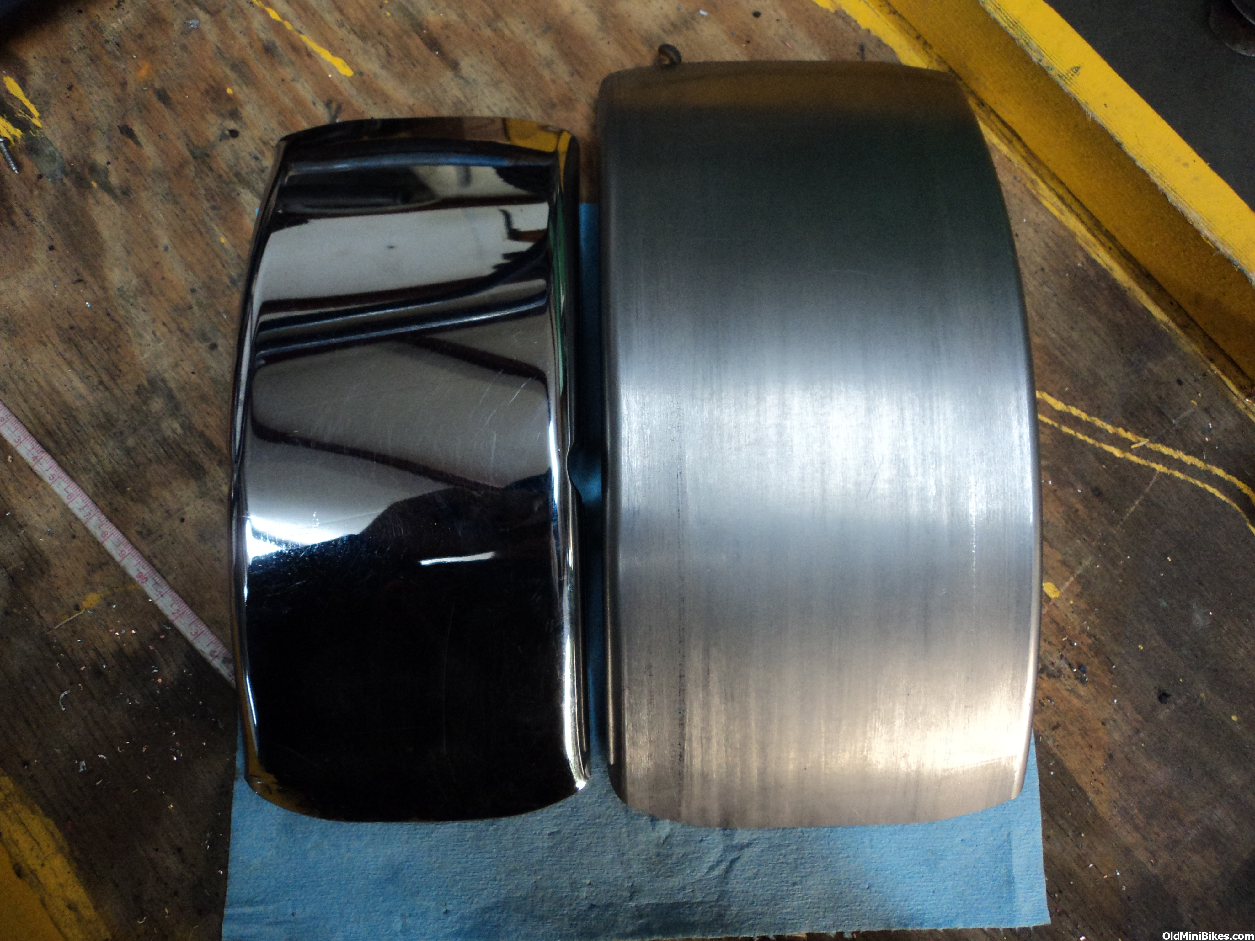

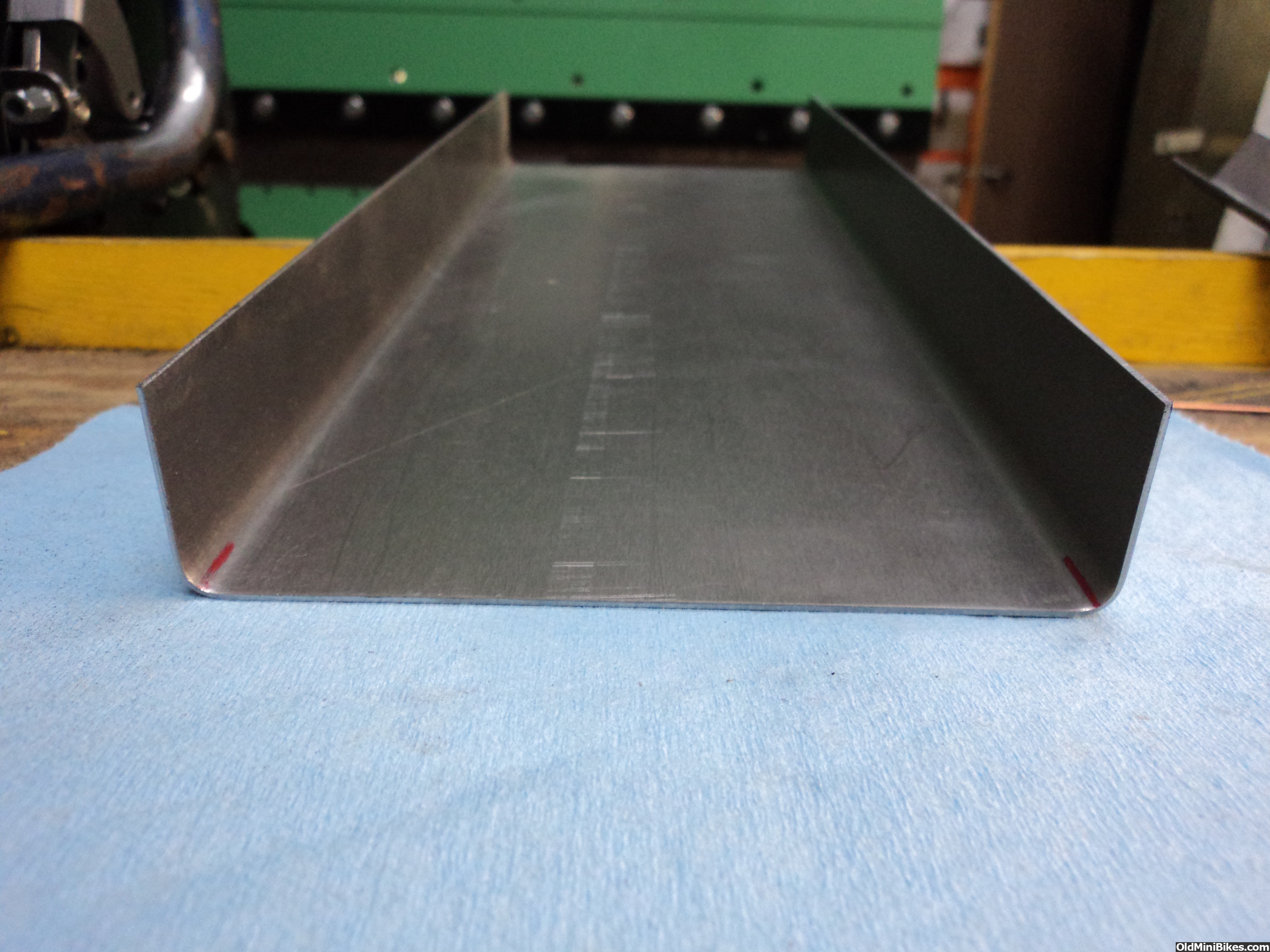

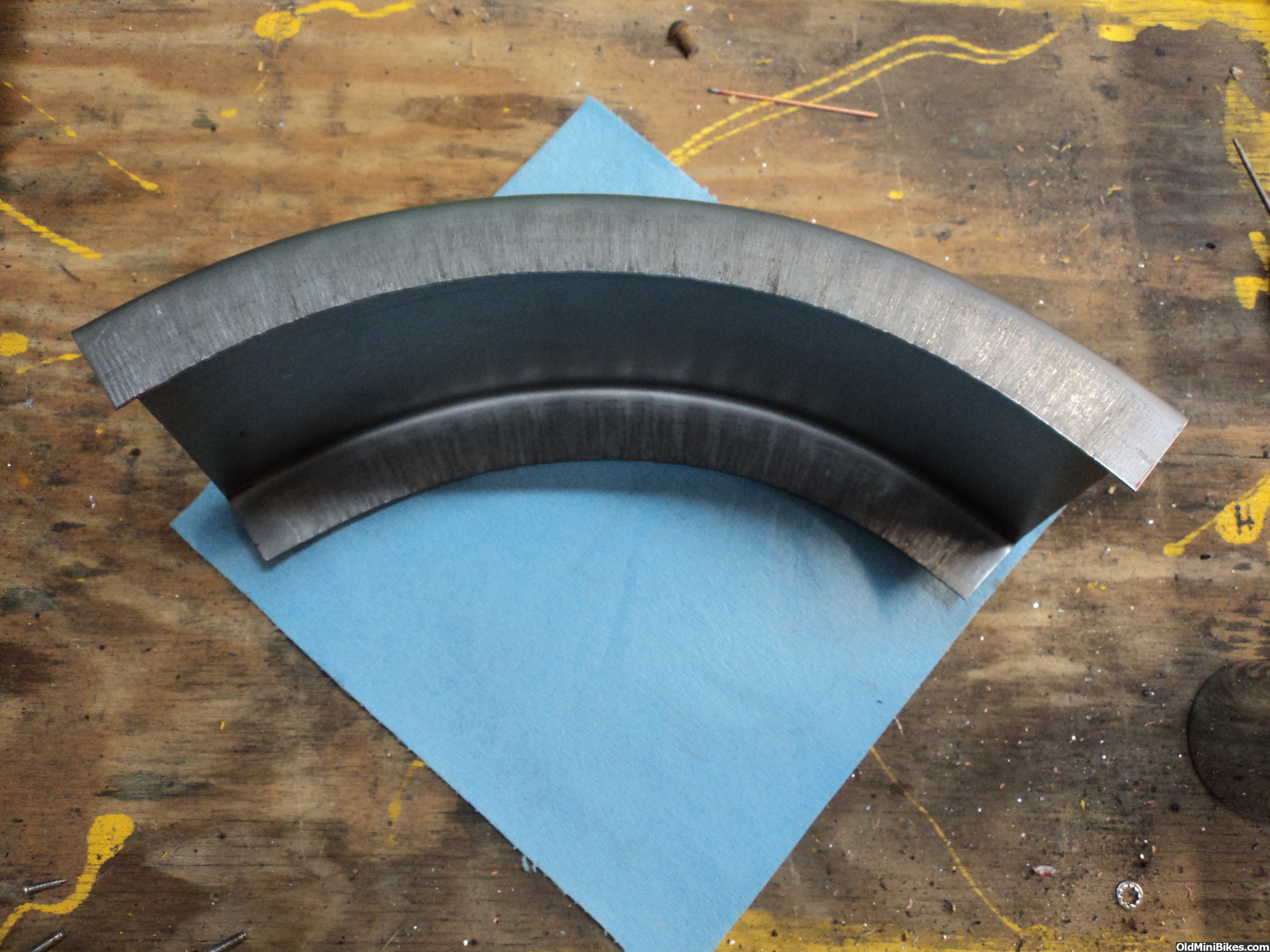

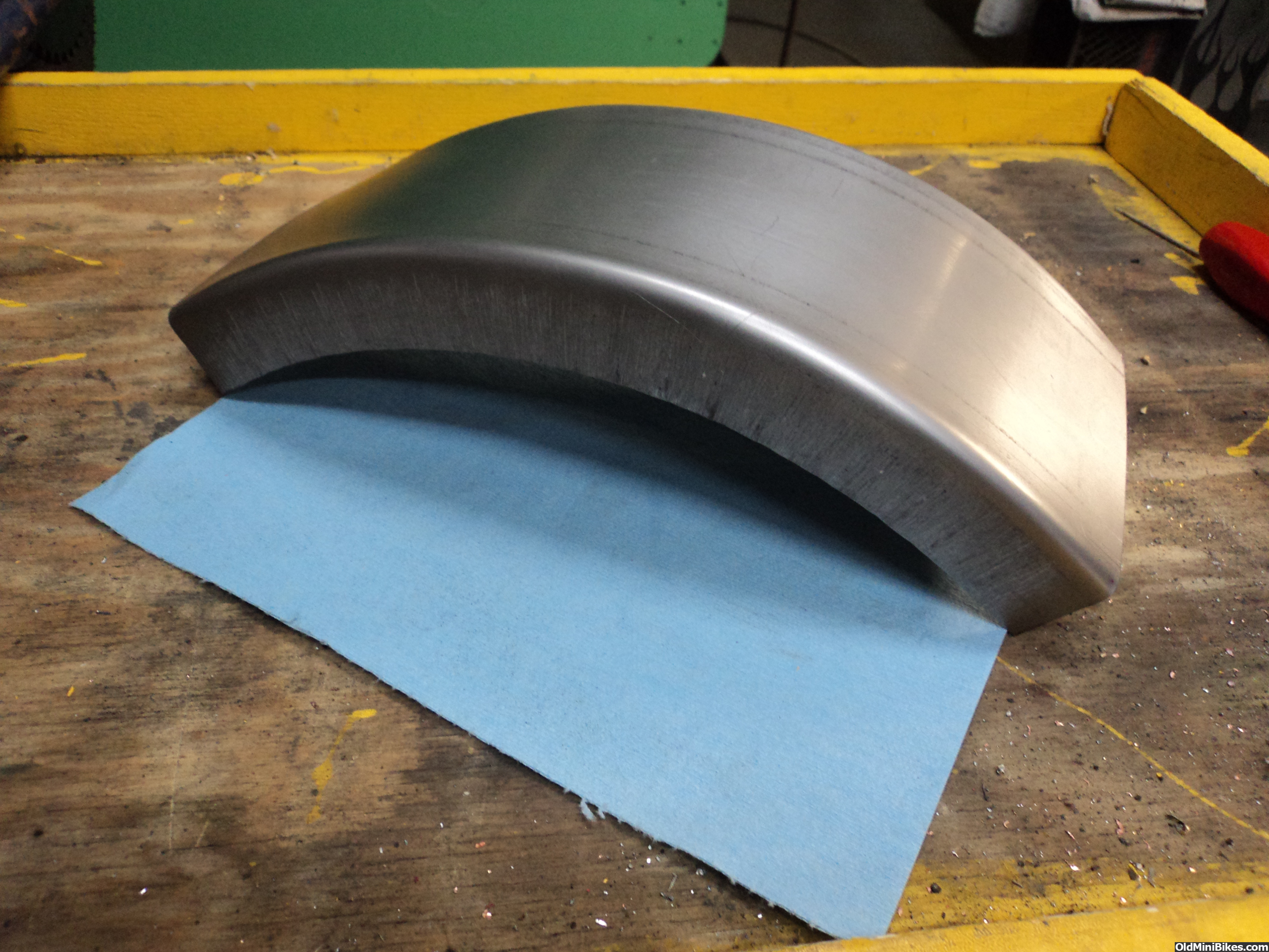

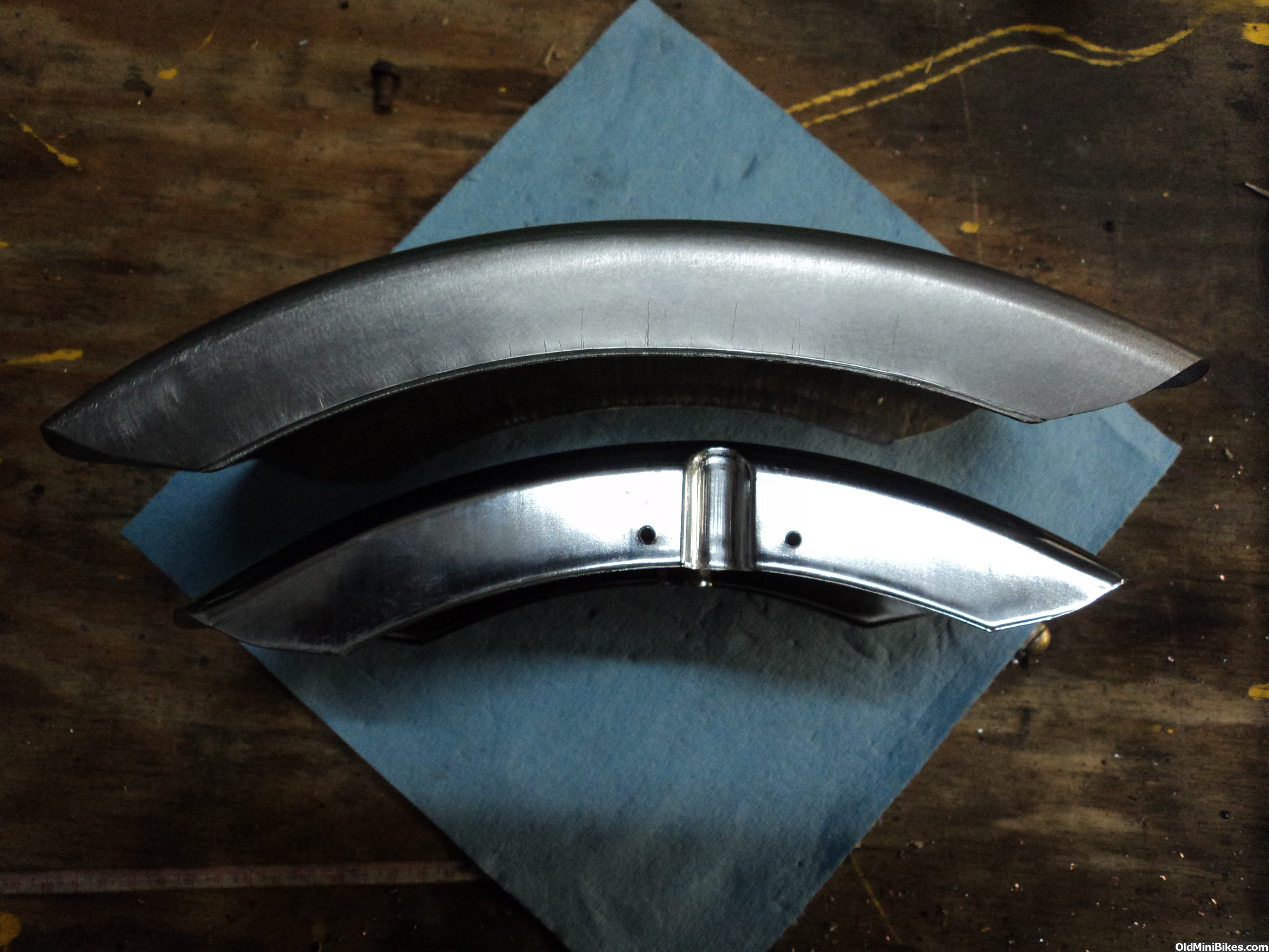

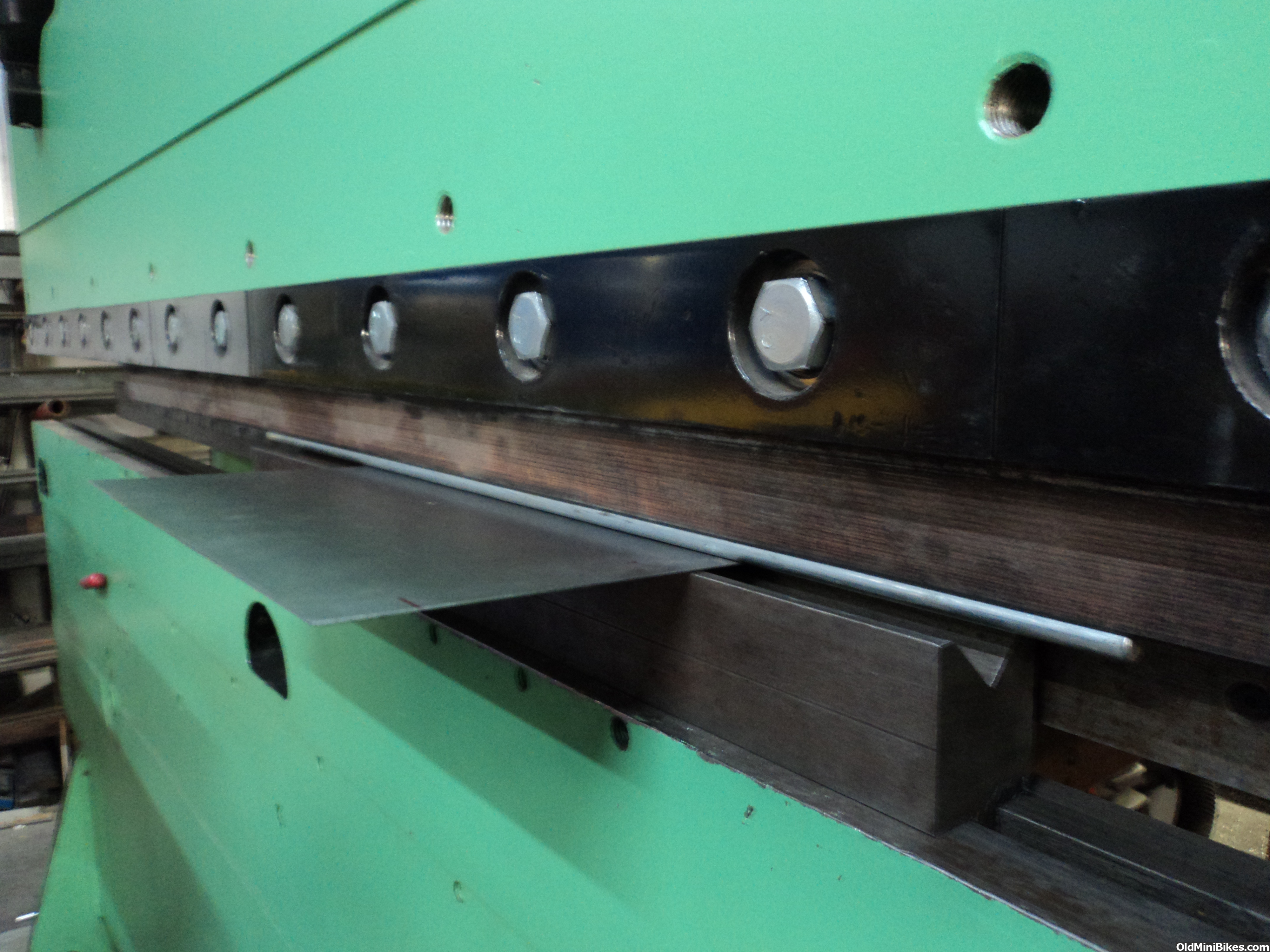

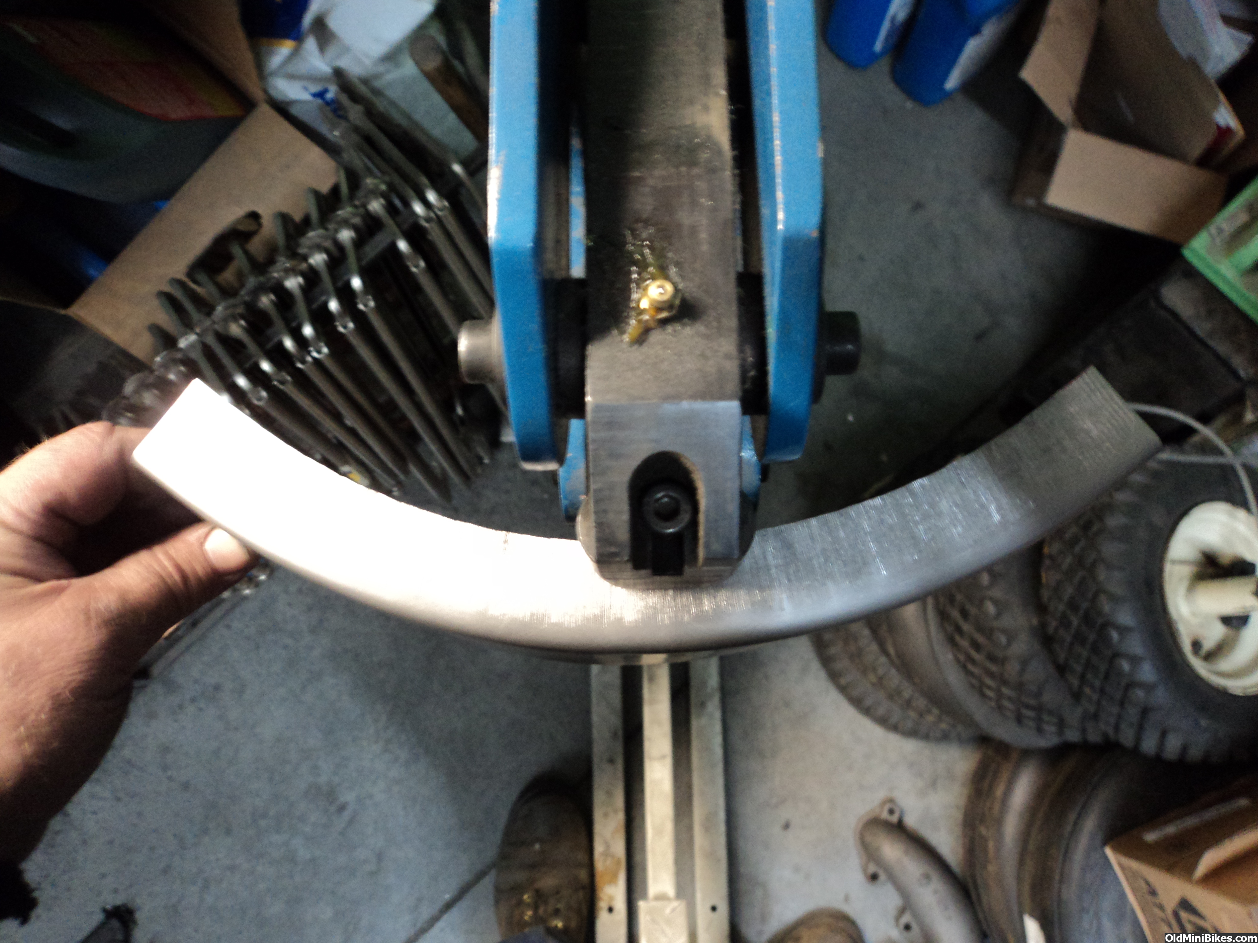

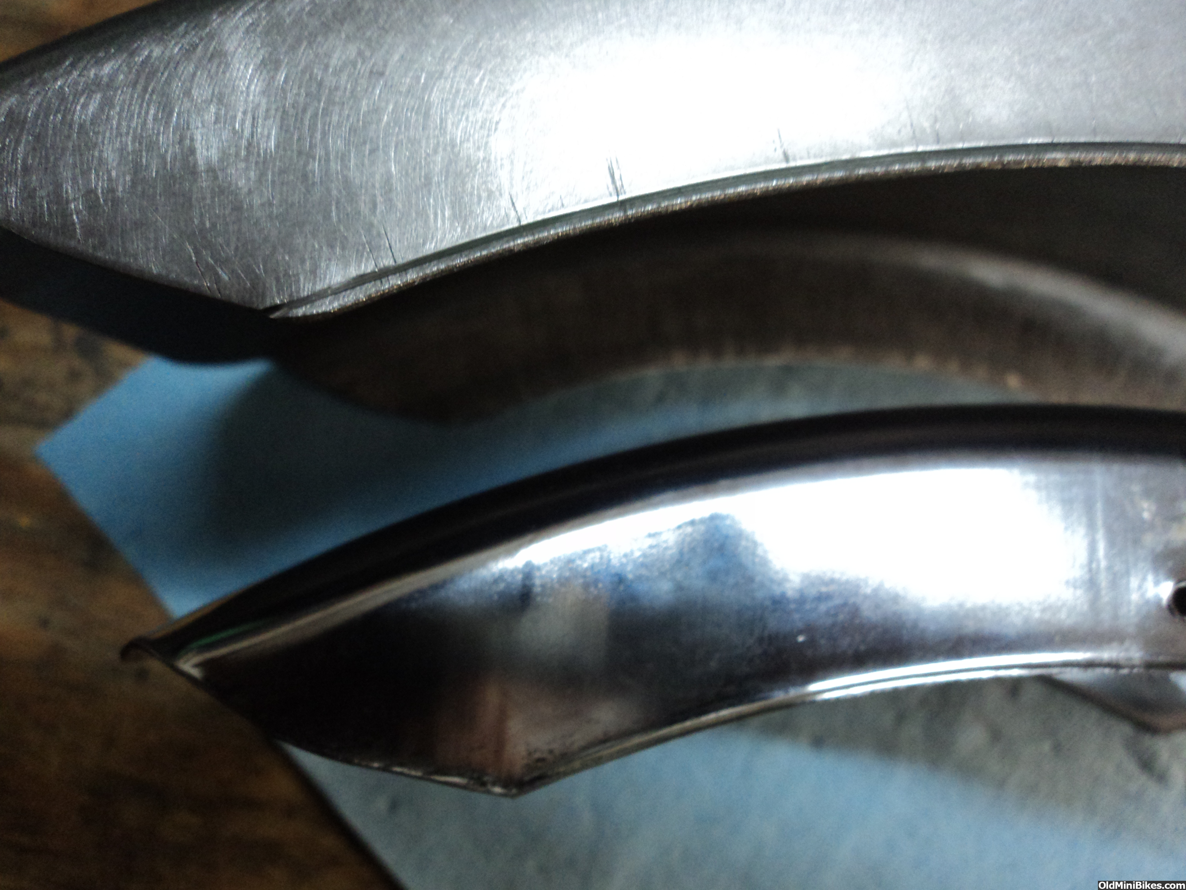

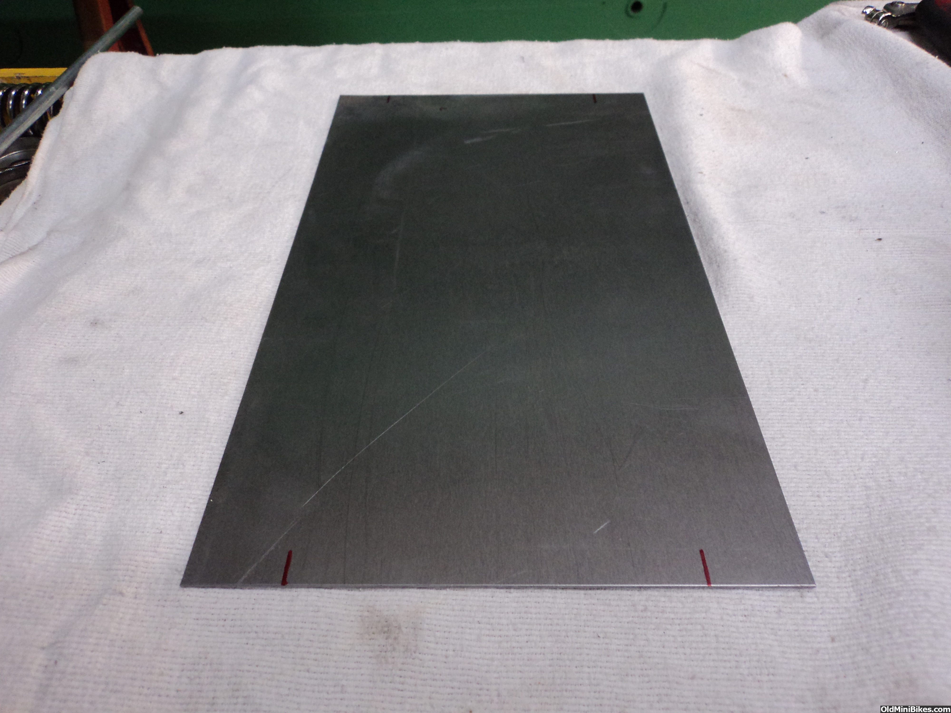

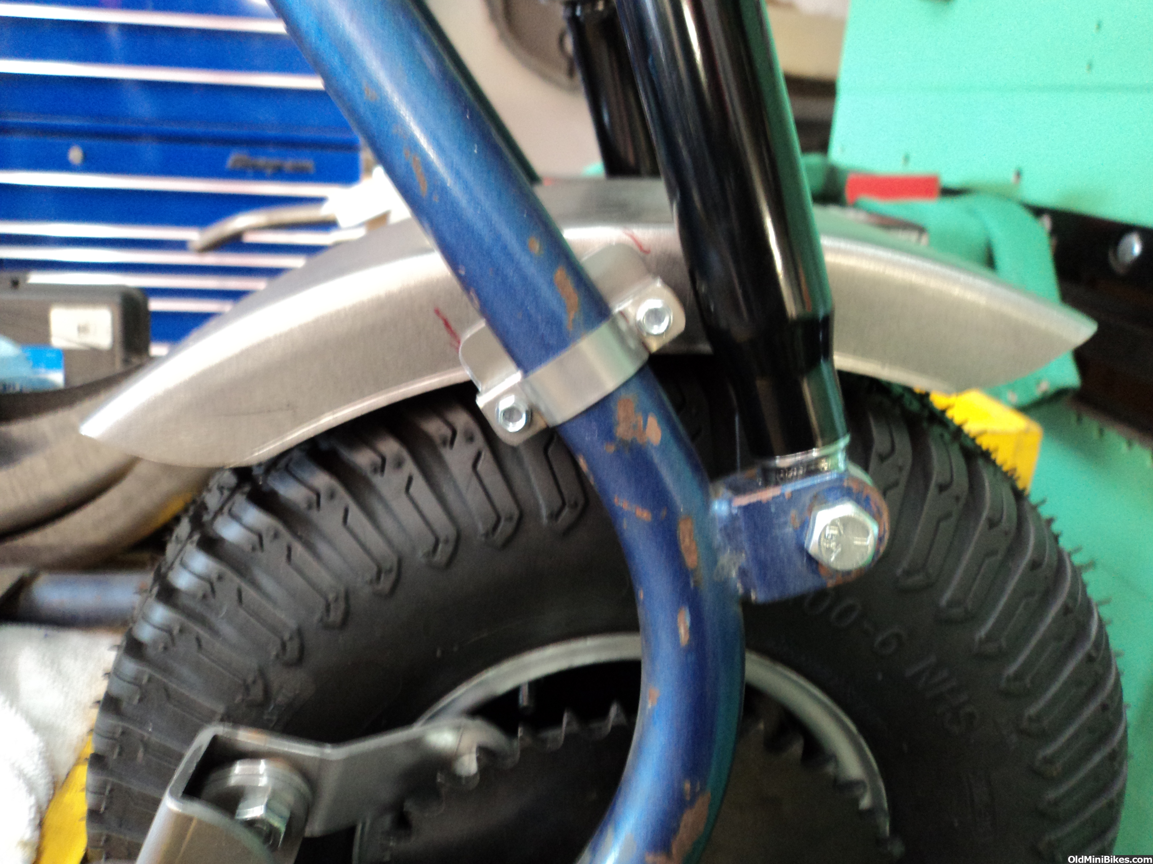

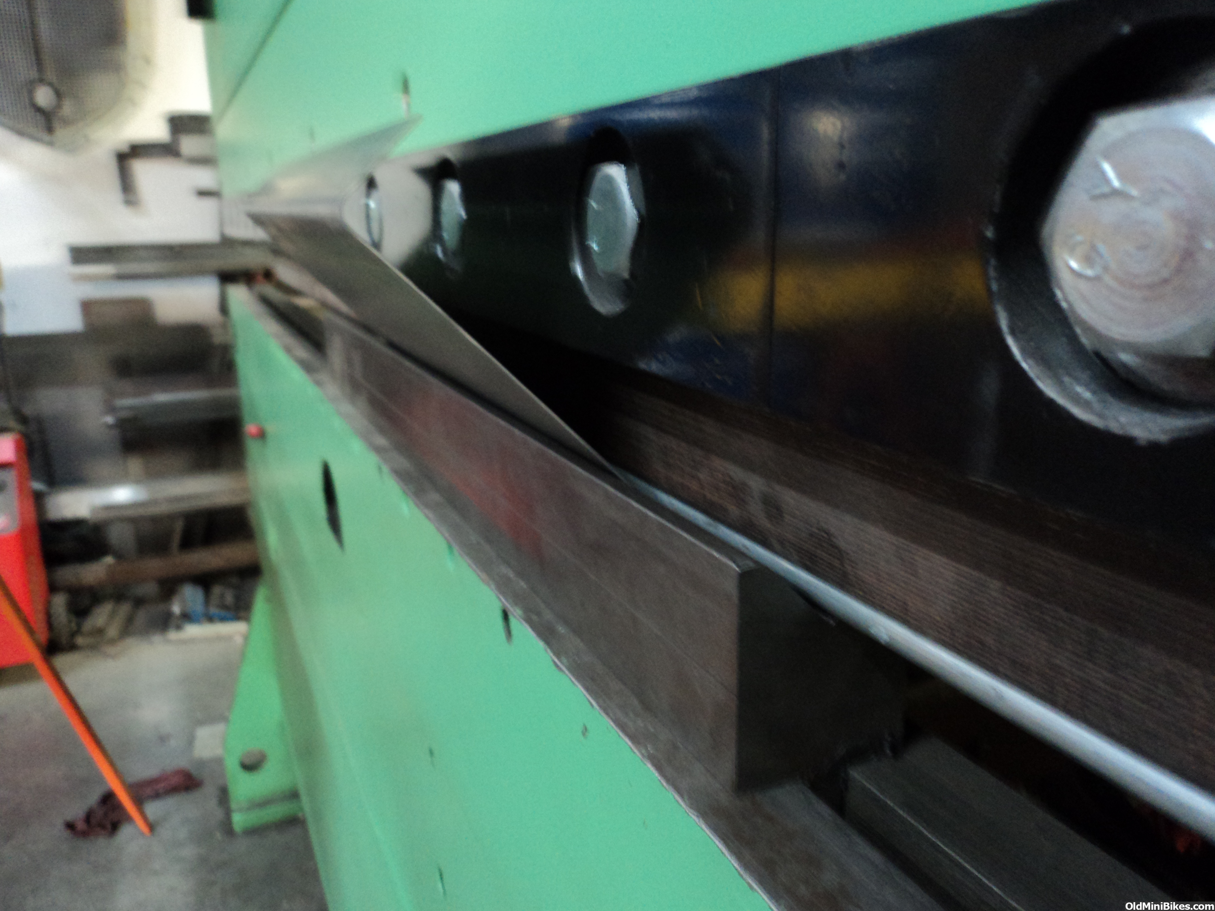

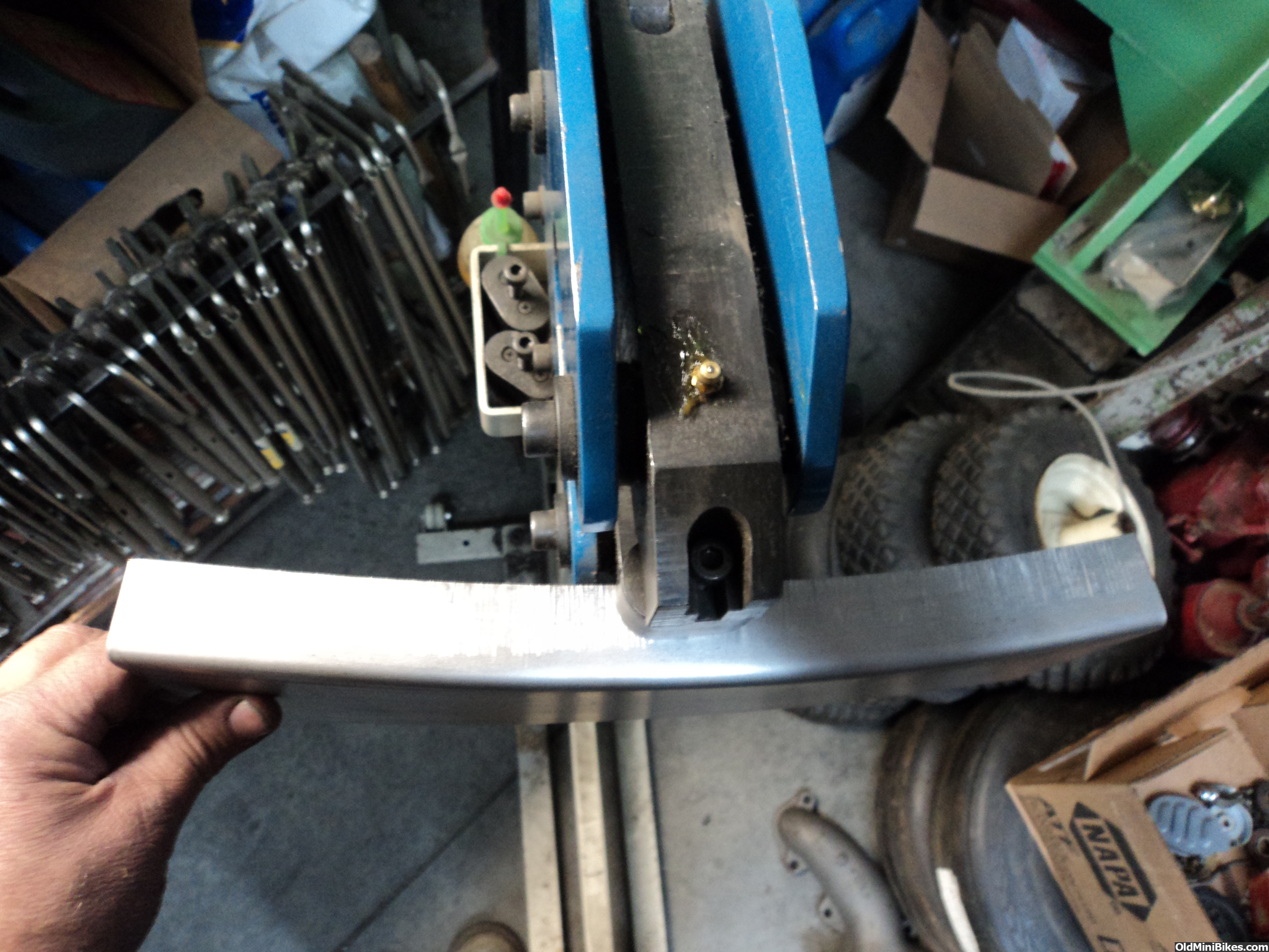

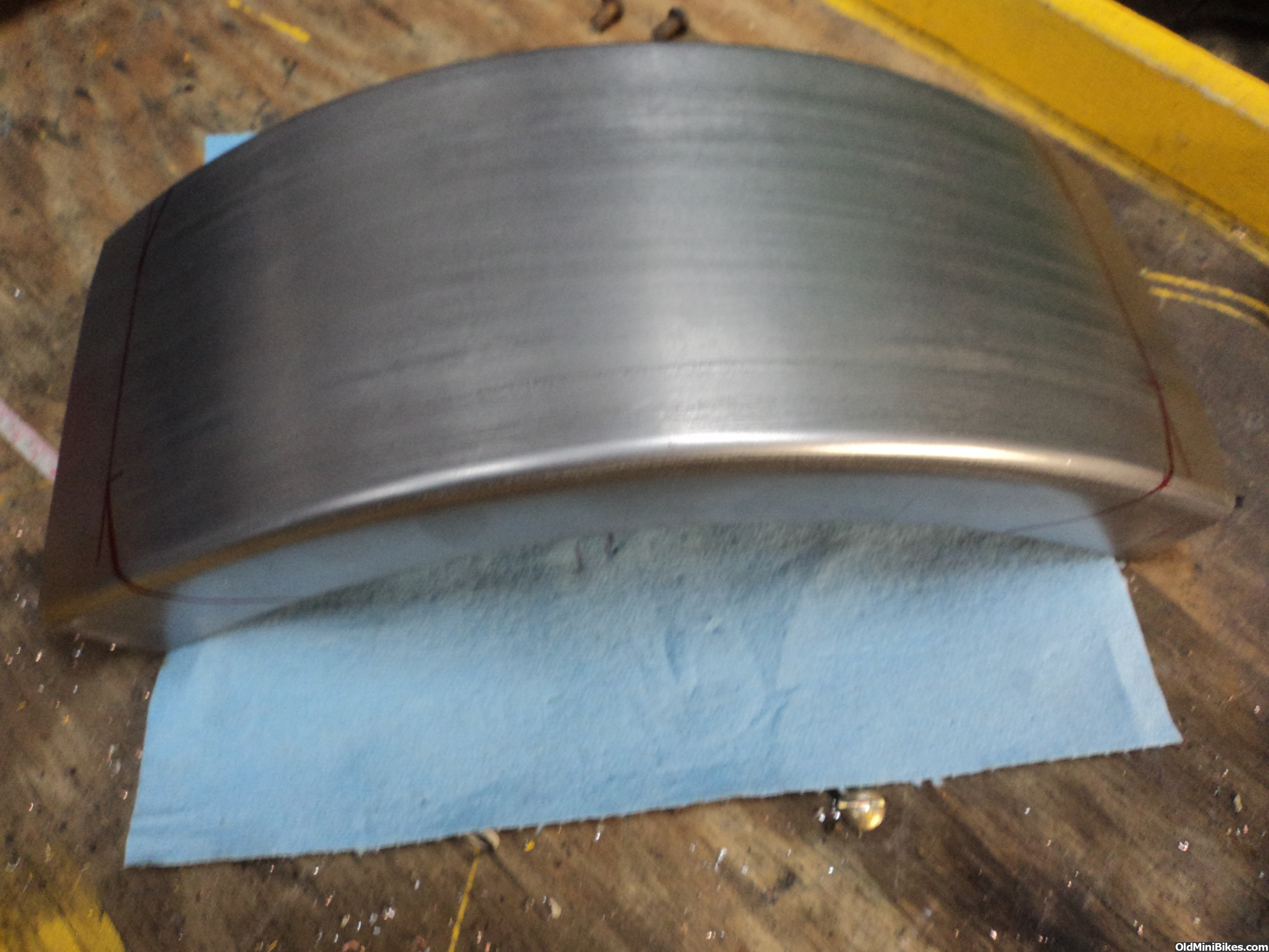

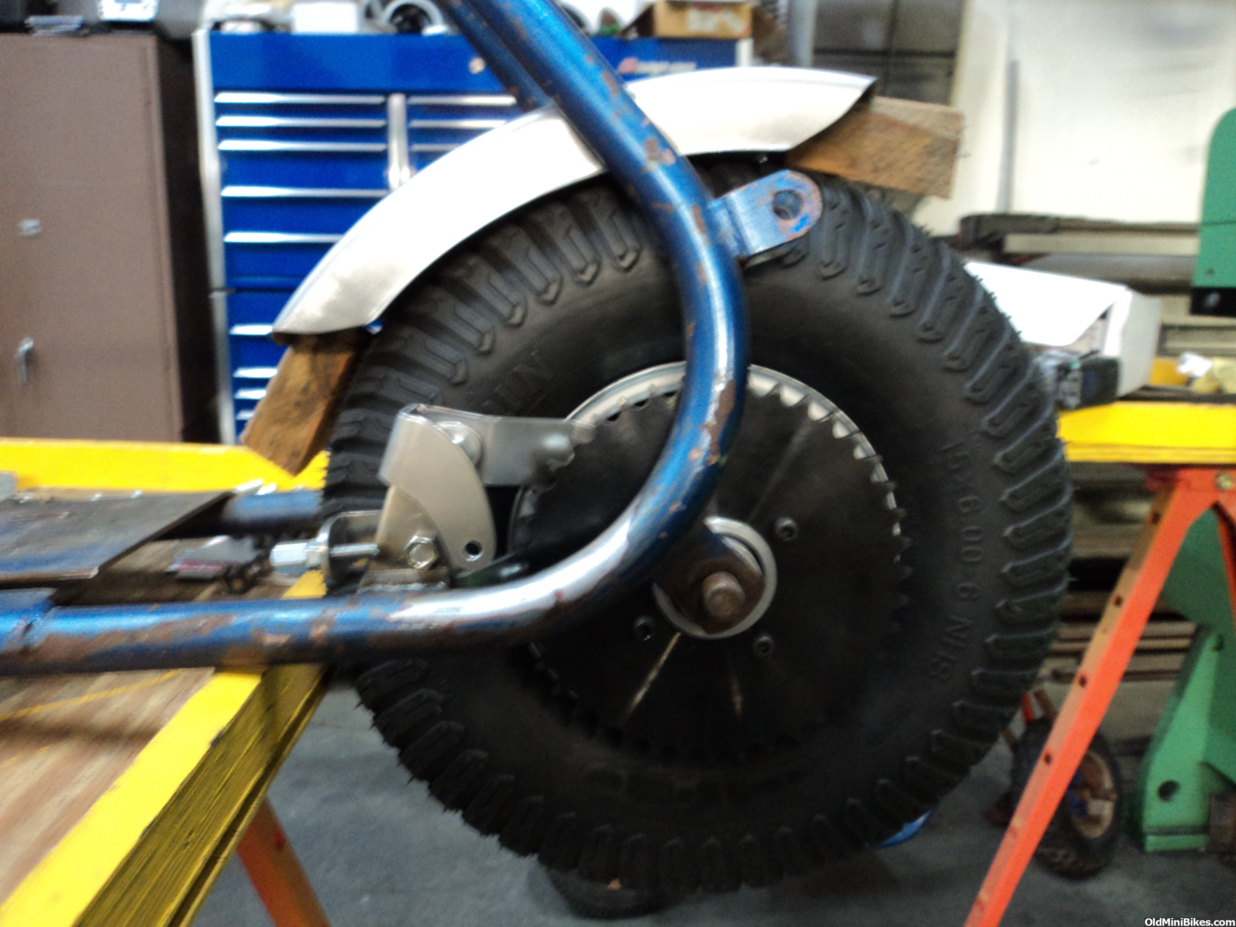

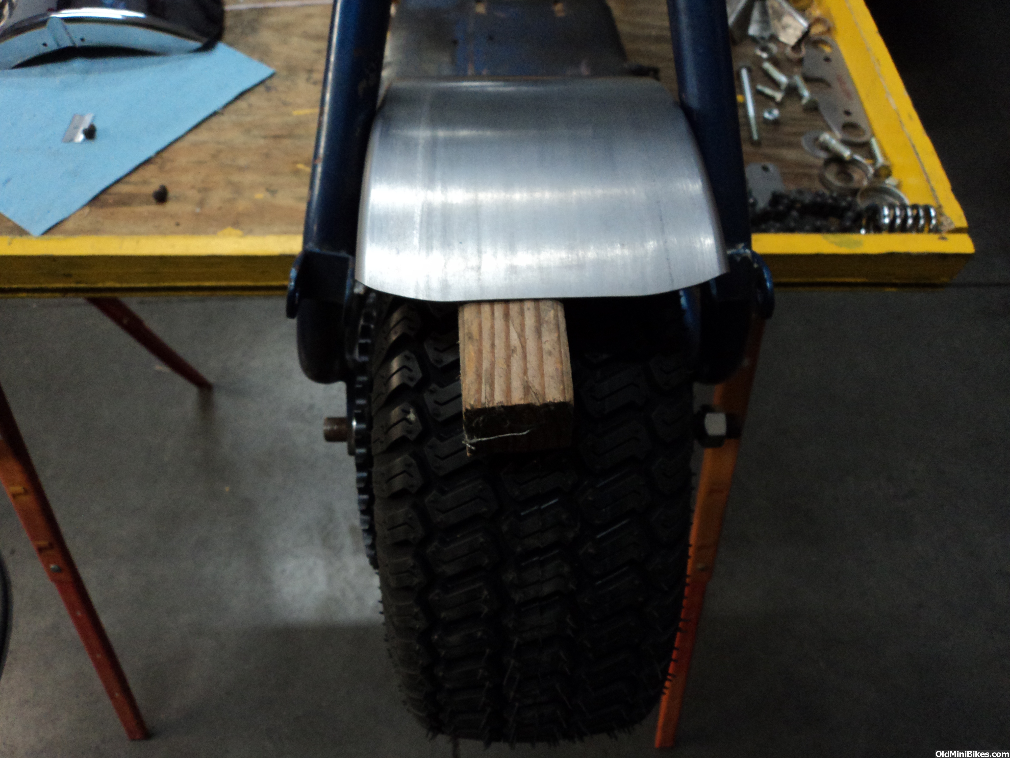

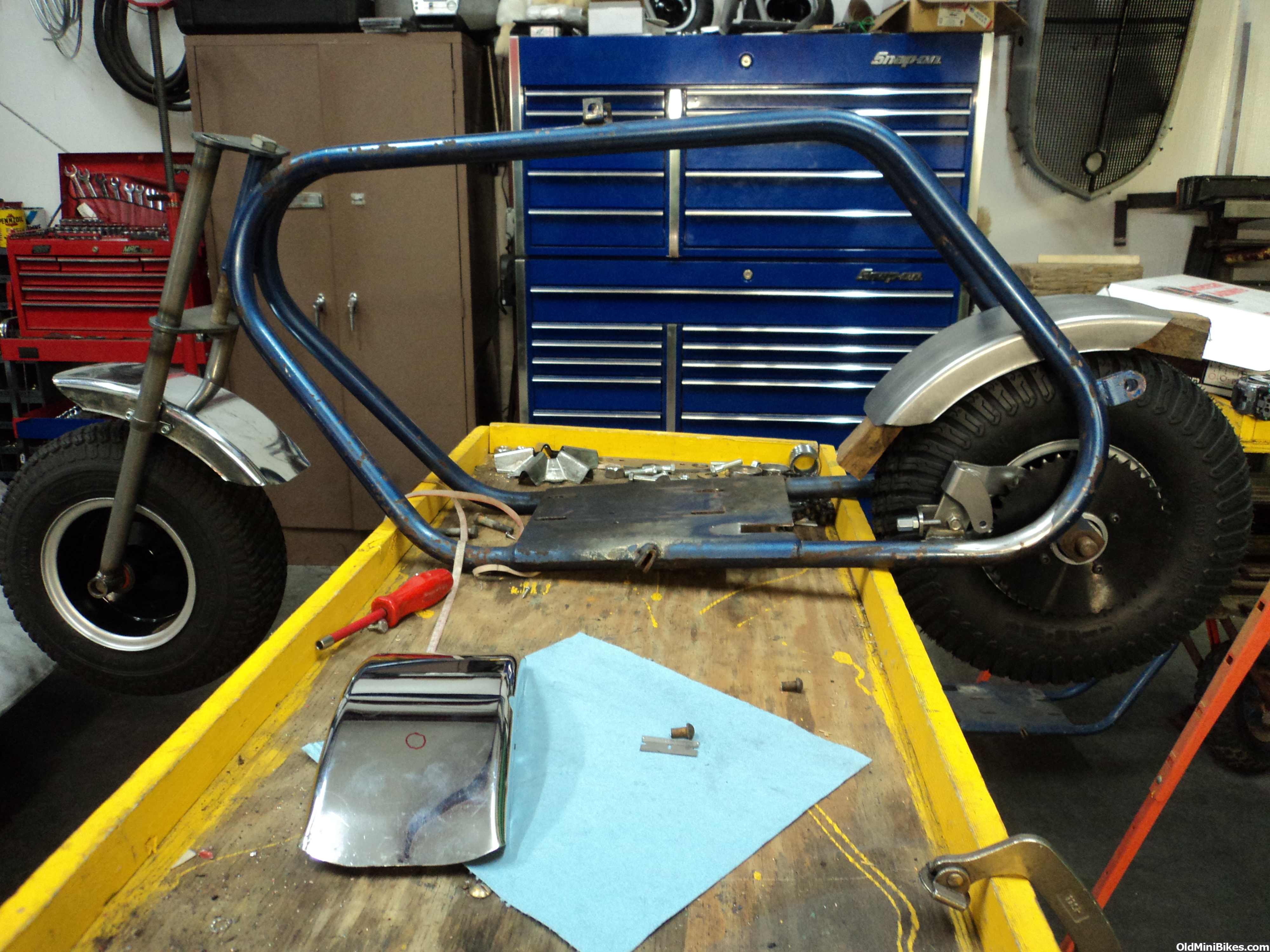

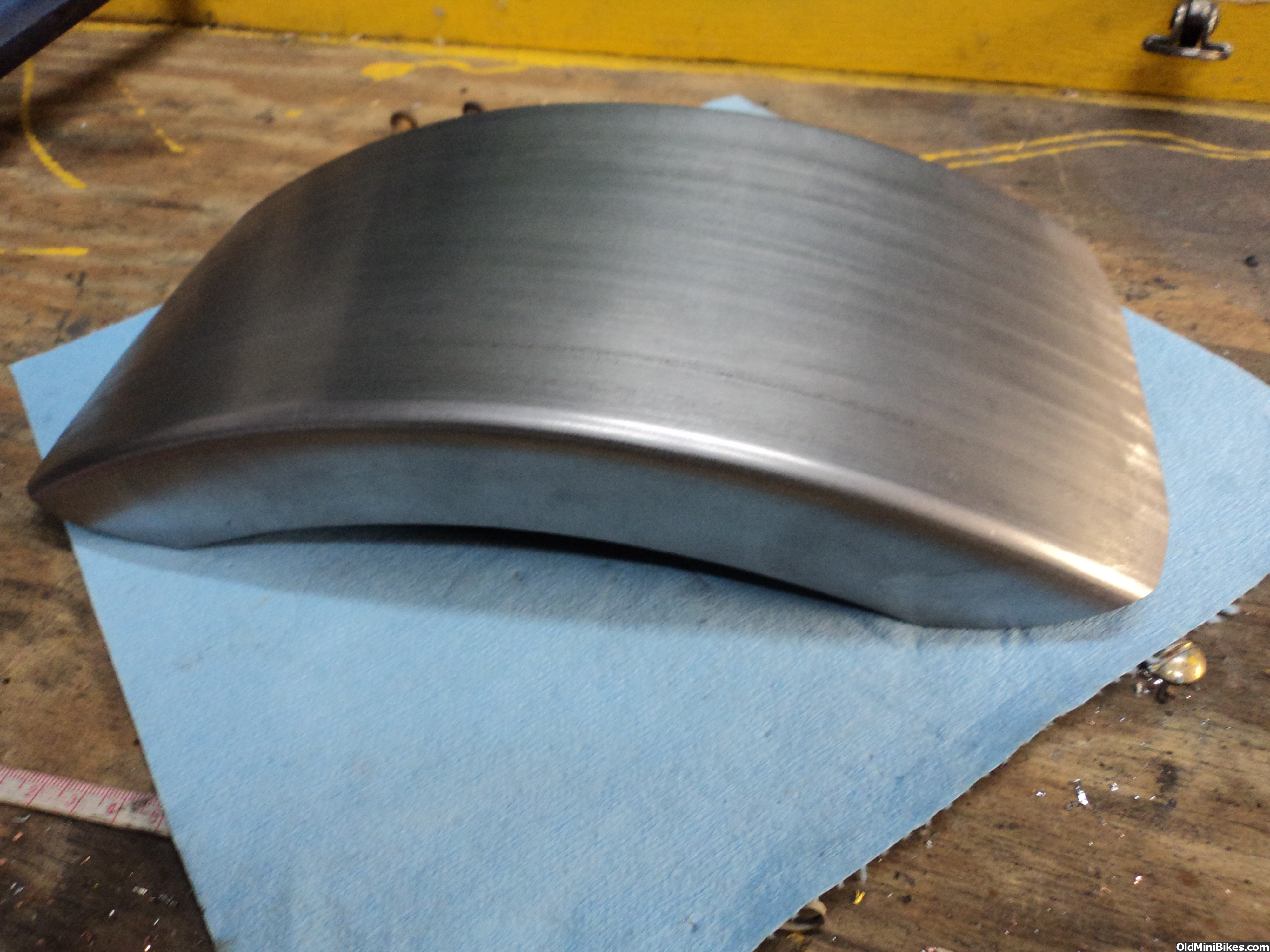

So I really need a rear fender for my other build off bike, but as we all know they're very hard to come by so...I decided to make my own. I also needed to make a wider one for this bike so I started with this one. Started with a piece of 18 guage and bent a channel using 3/8 rod for the rounded corners in my press brake. I then used my shrinker / stretcher and formed the arch which left the the top area with a concave shape. After some time on the english wheel it flattened out and then I sanded the shrinker marks off the sides. Being the rear tire is a little bigger, I went ahead and cut it a little longer than a stock fender but kept the shapes of the original. Next I used the tipping rolls in my bead roller and added the small flare to the bottom side flange just like the original. Next I will have to mount it, but until then I added pictures of it mocked up with some wood blocks...
#34
man , what they said , really great work ! I can see the Cat fender orders coming in quick :thumbsup::thumbsup:

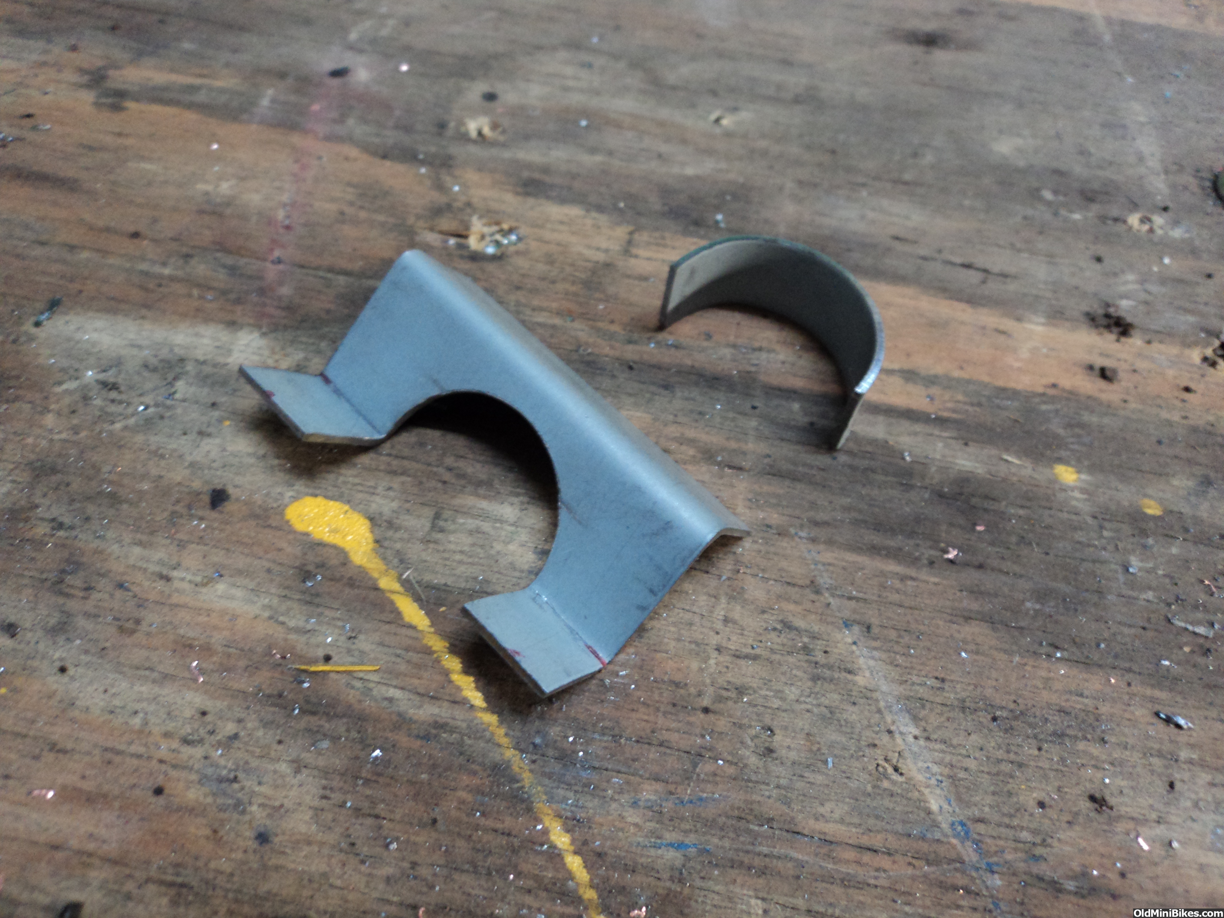

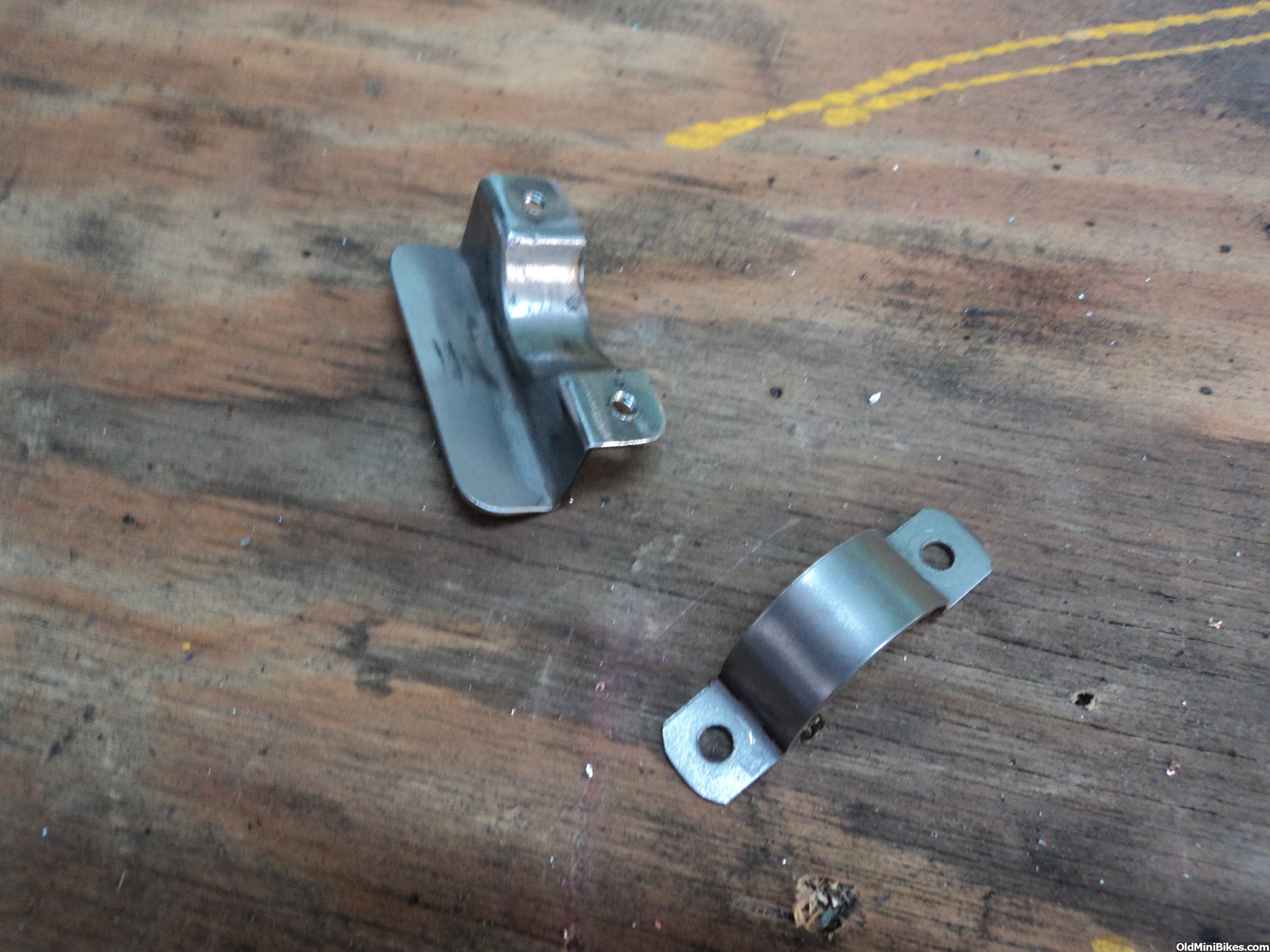

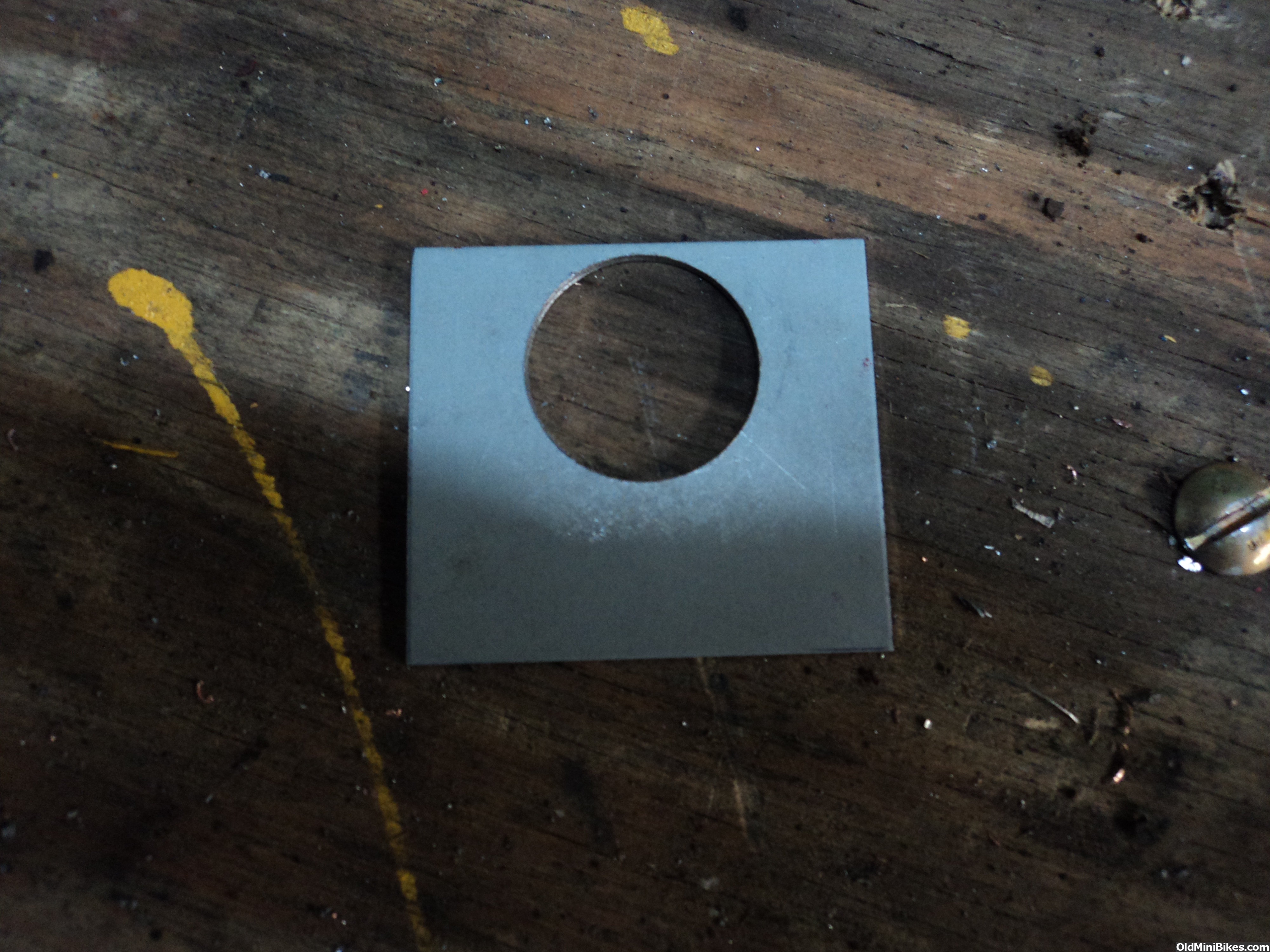

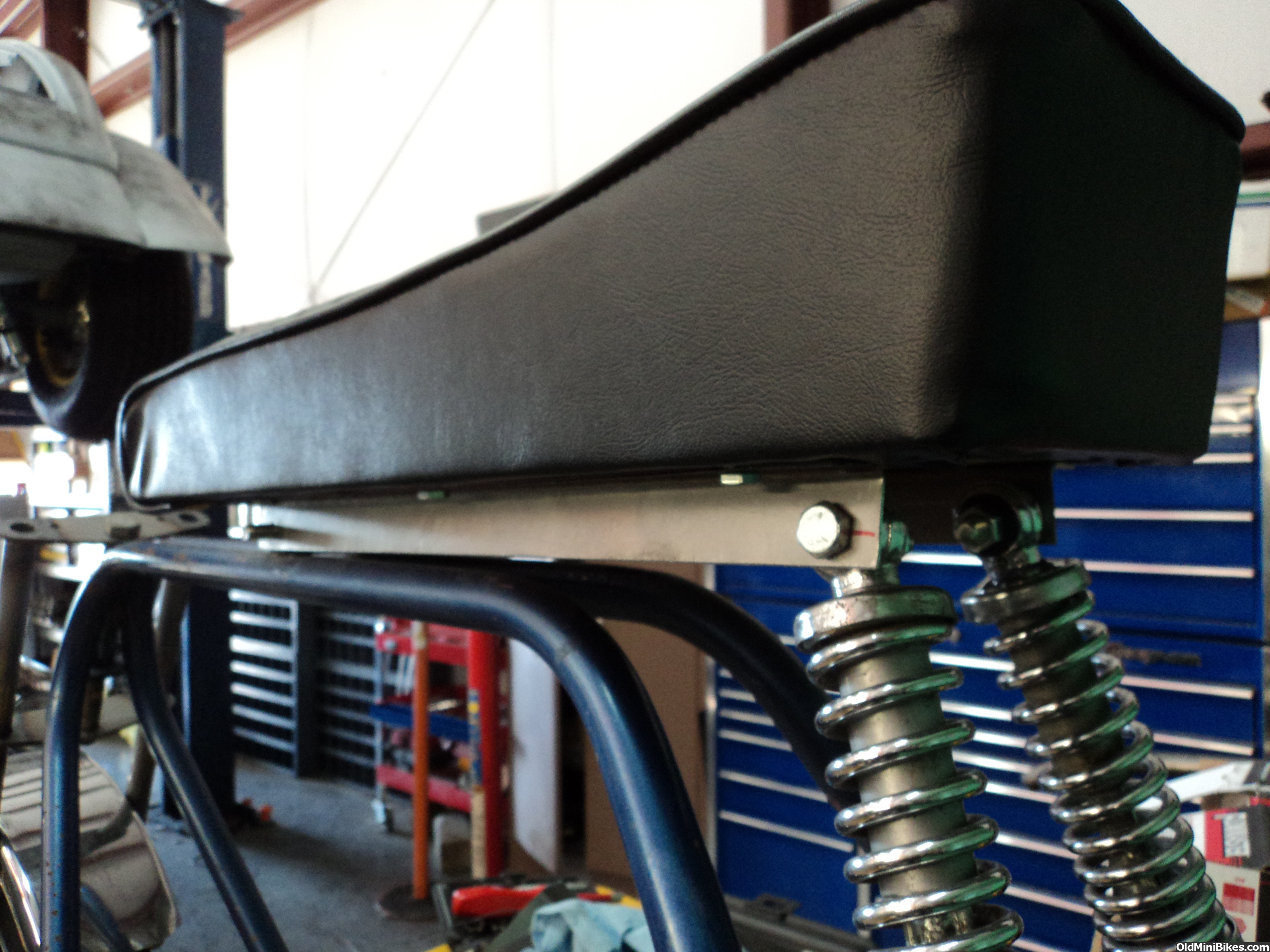

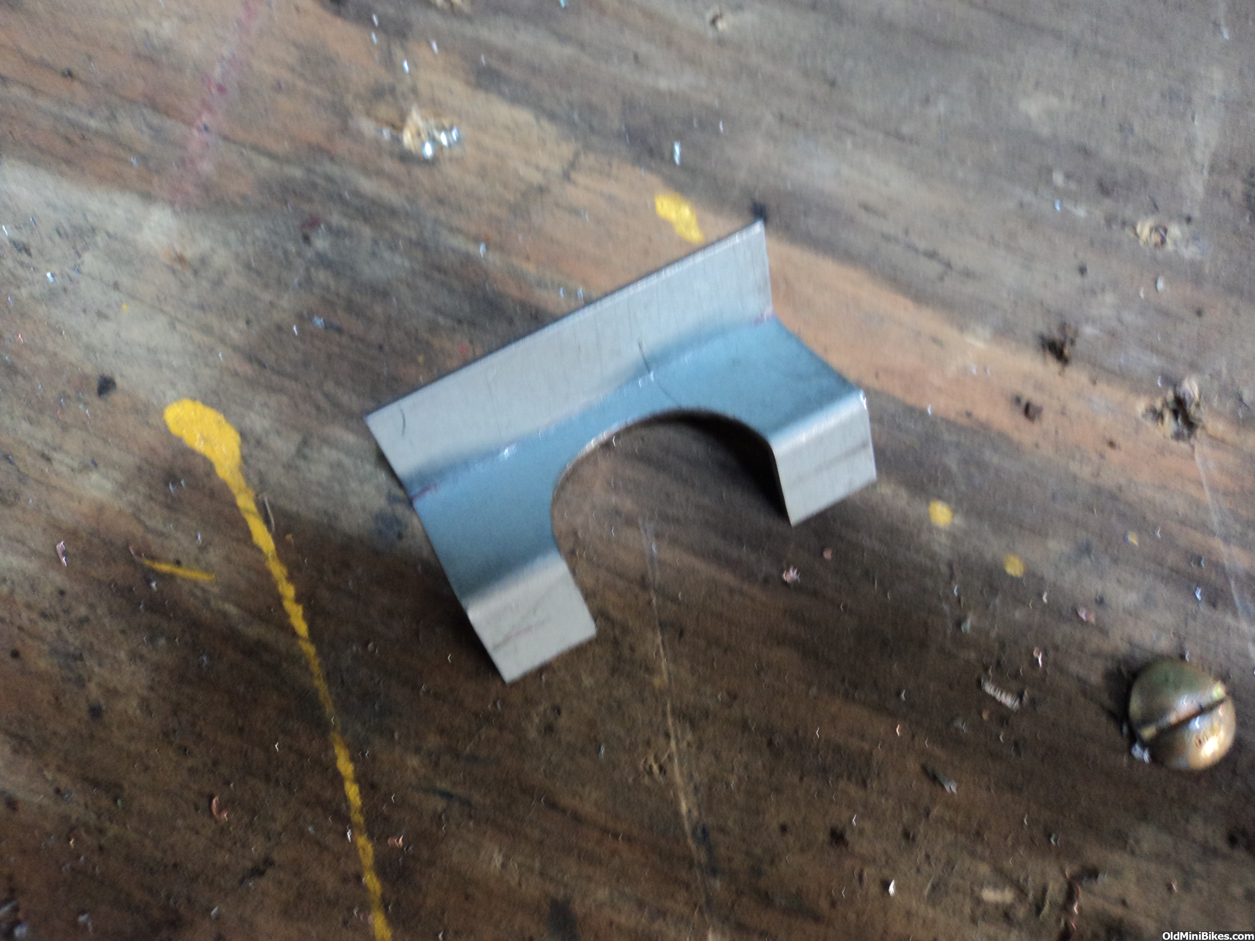

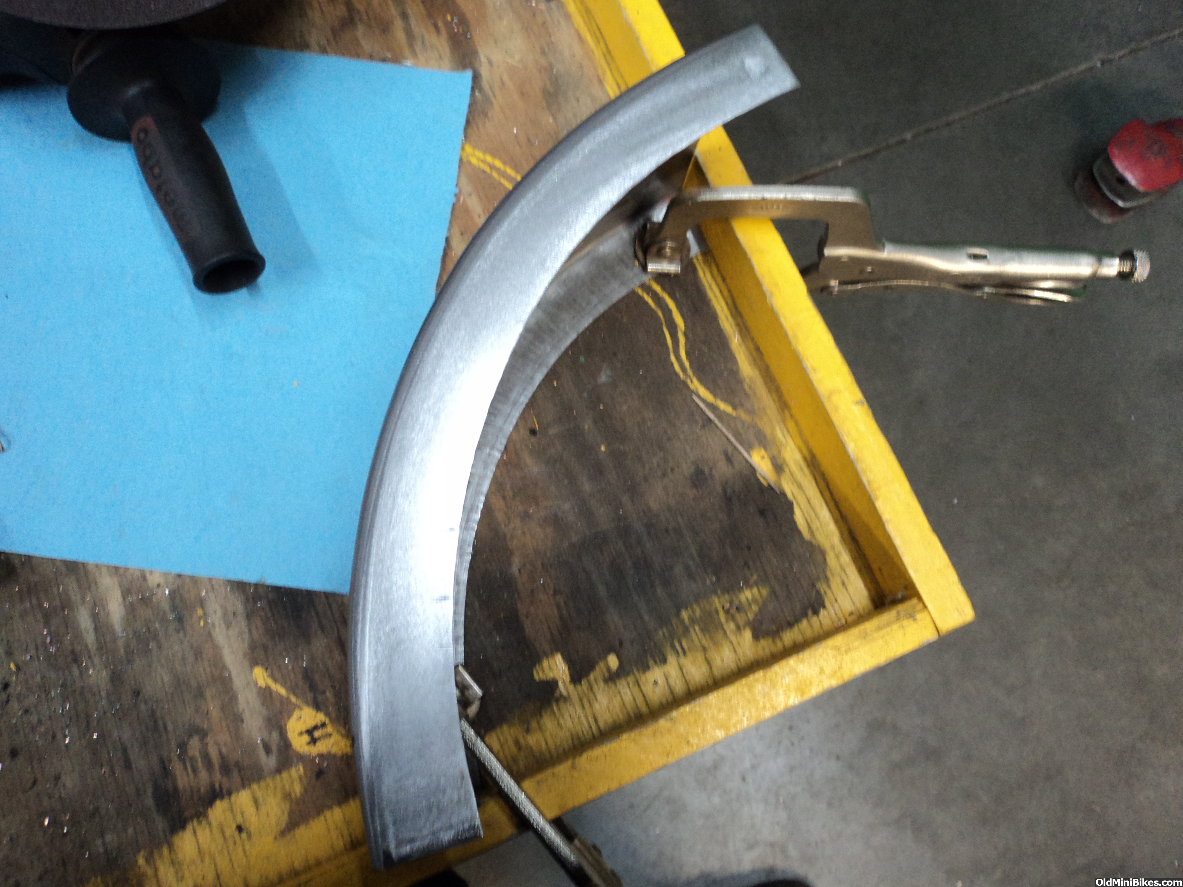

UPDATE...So the only things I have had time to do this month was make the rear fender brackets and some new seat brackets....all just like the originals..

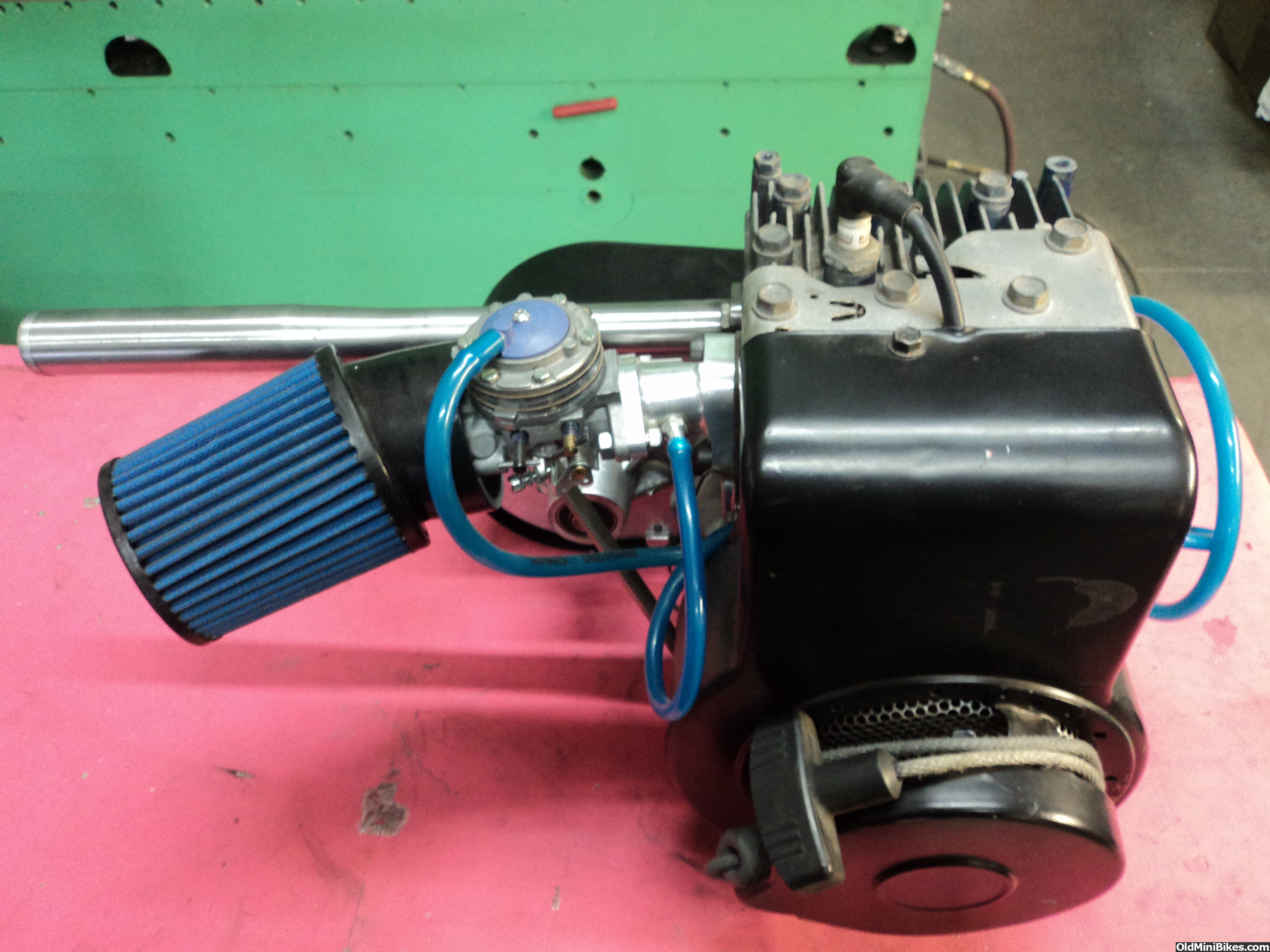

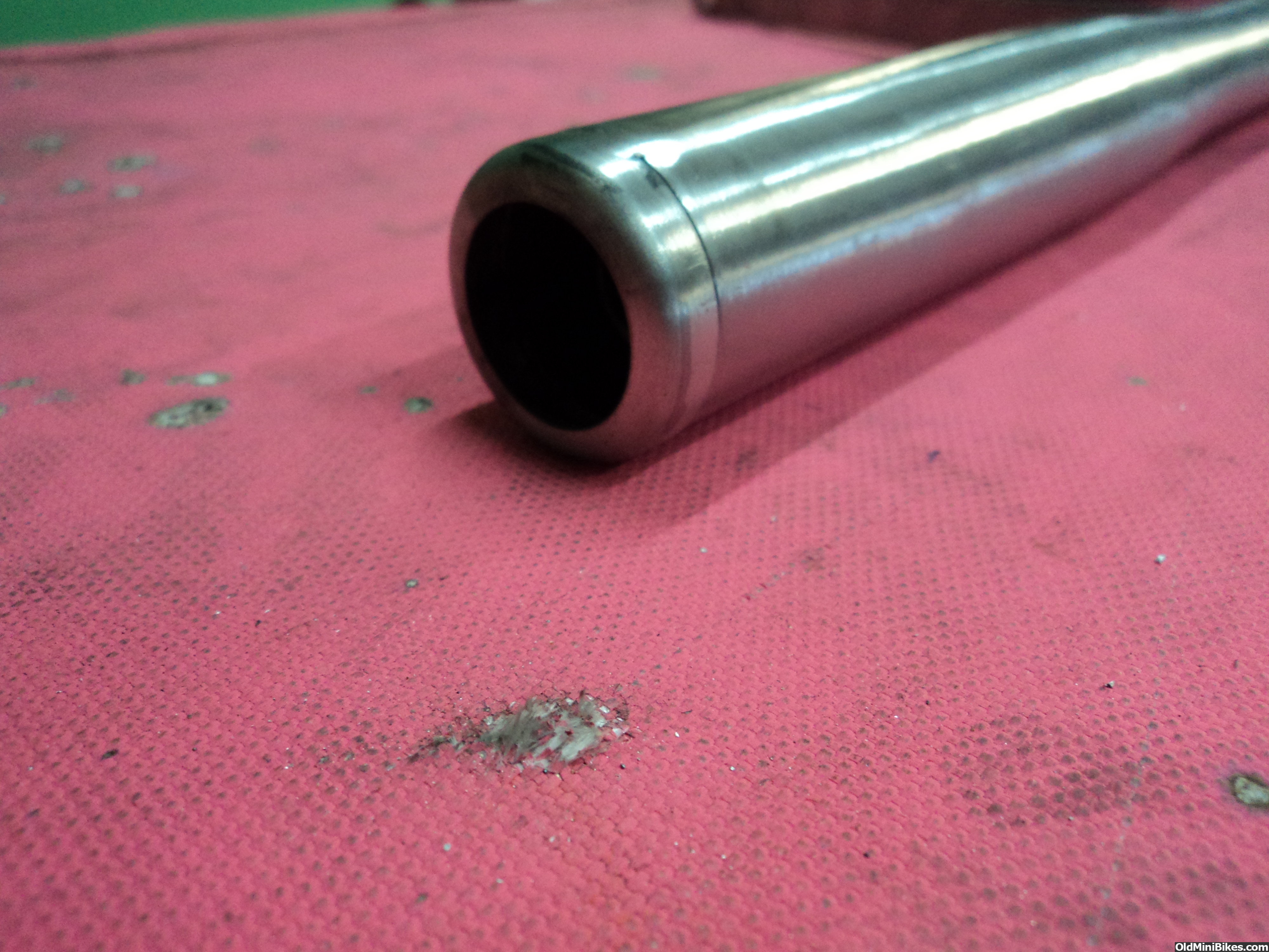

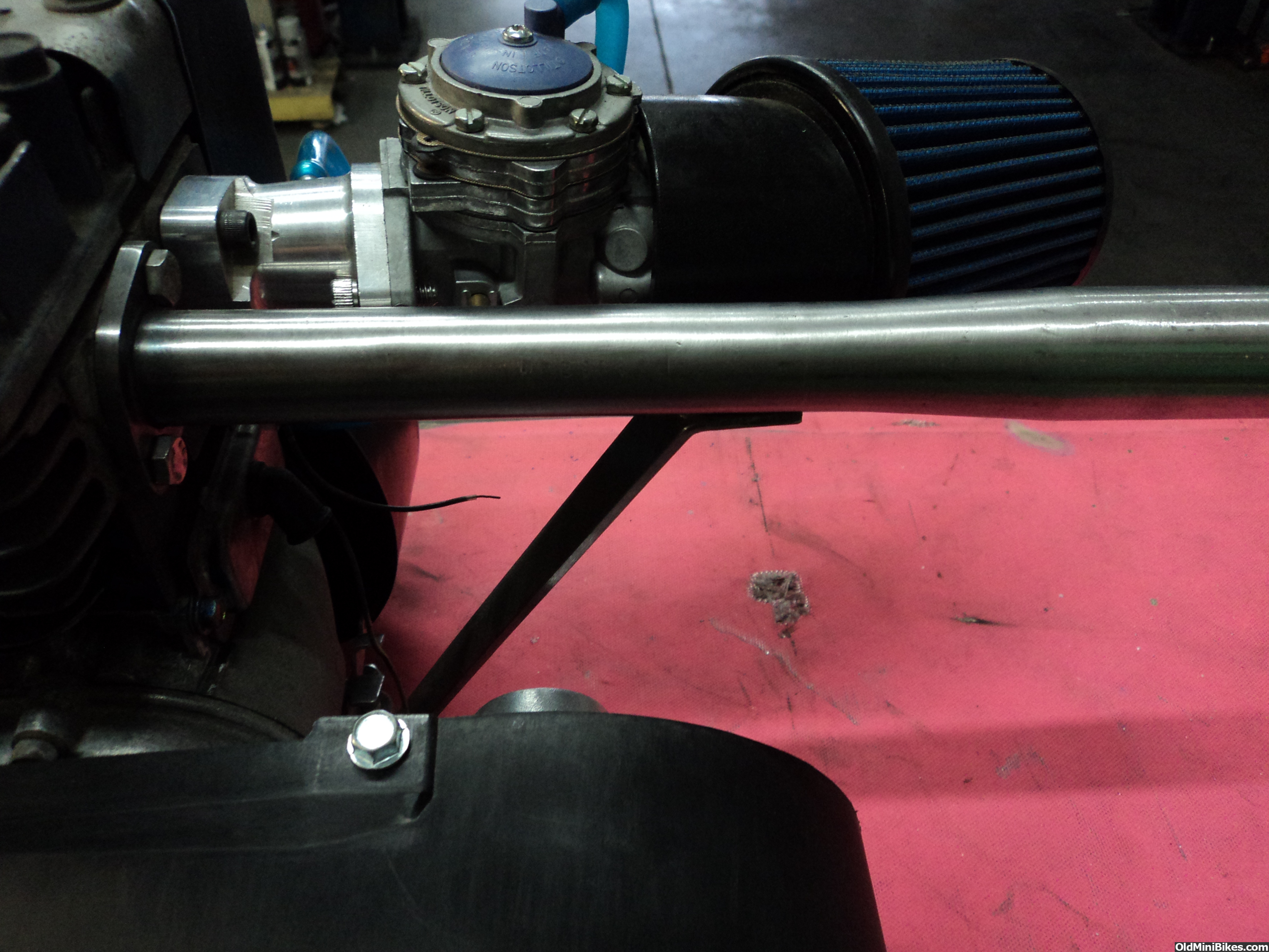

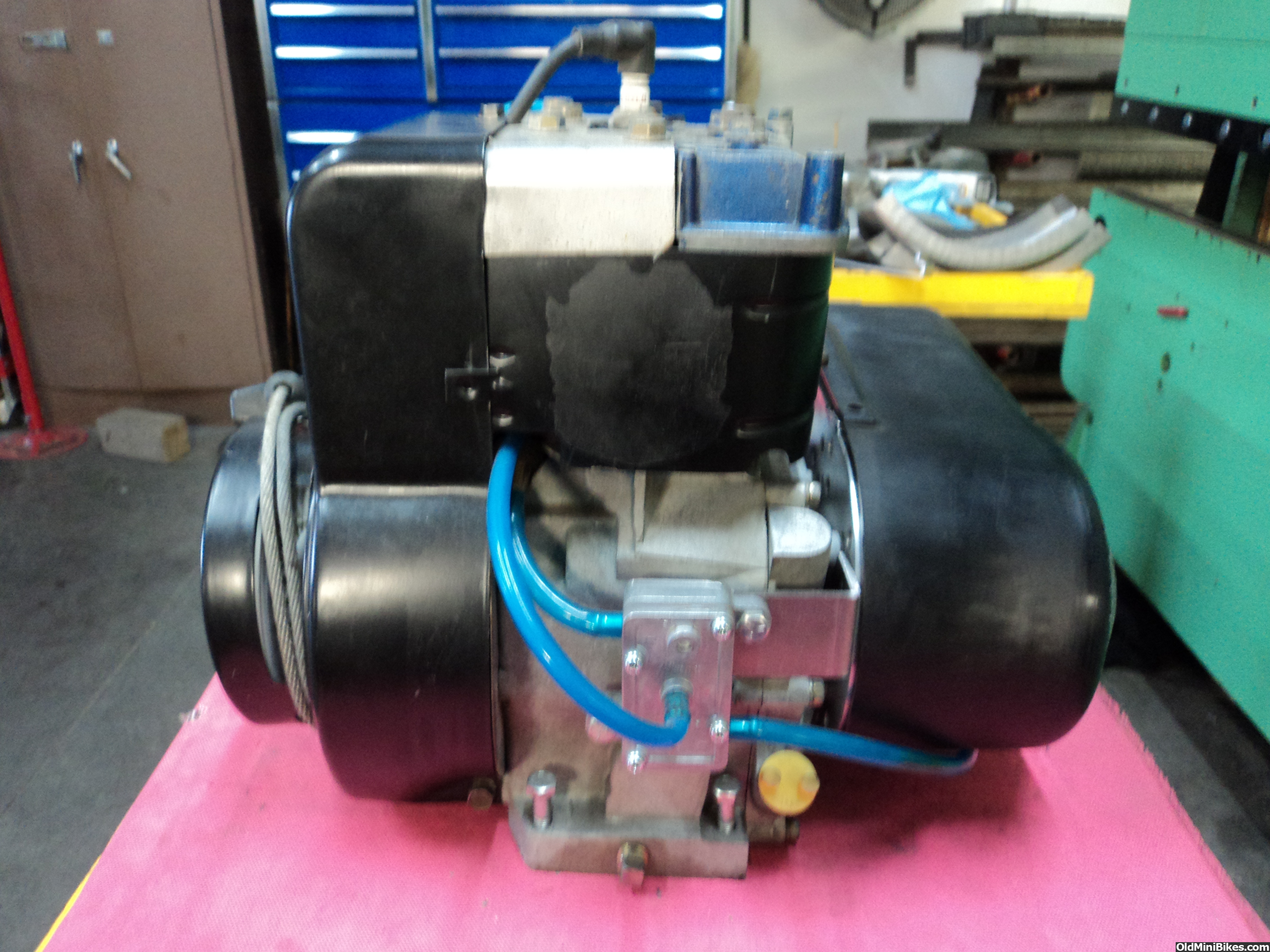

So I haven't done much again this month other than I made the exhaust pipe and a bracket for the fuel pump, and installed the intake manifold and carb.

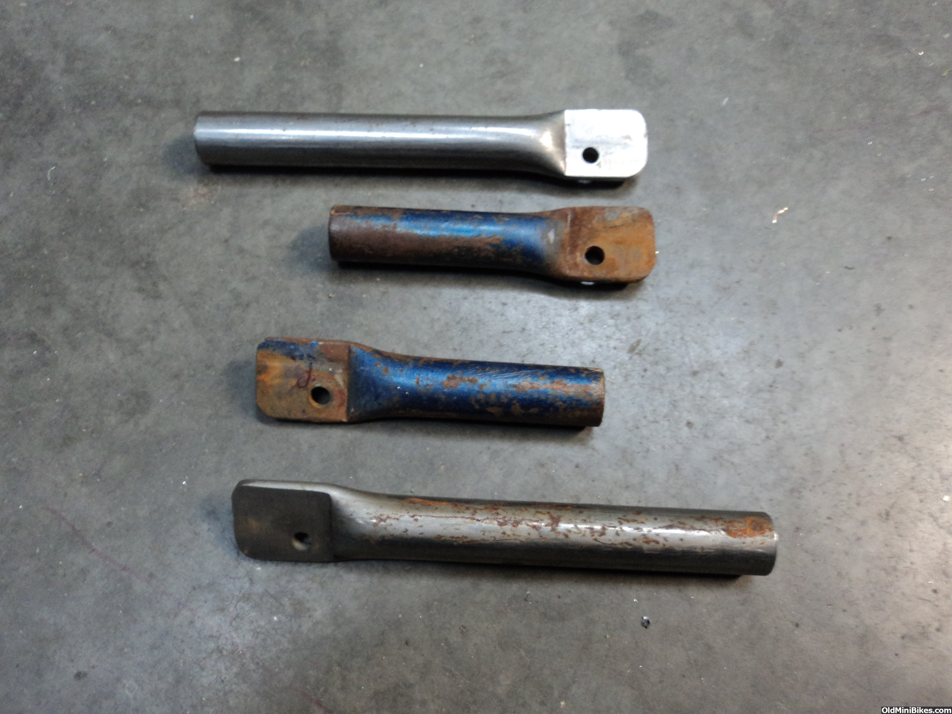

Not much done again this month other than I made a set of longer foot pegs to clear the fan housing and torque converter cover.....I better hurry...
