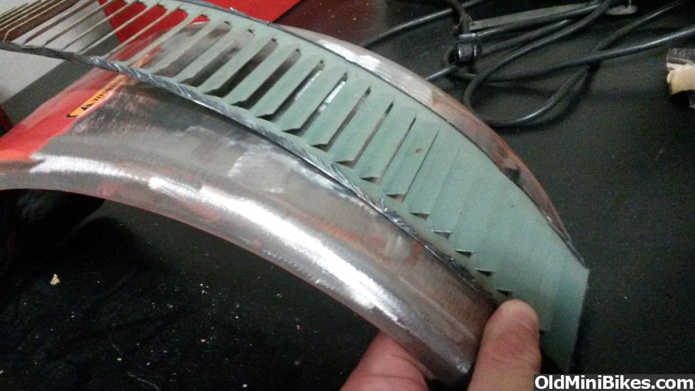

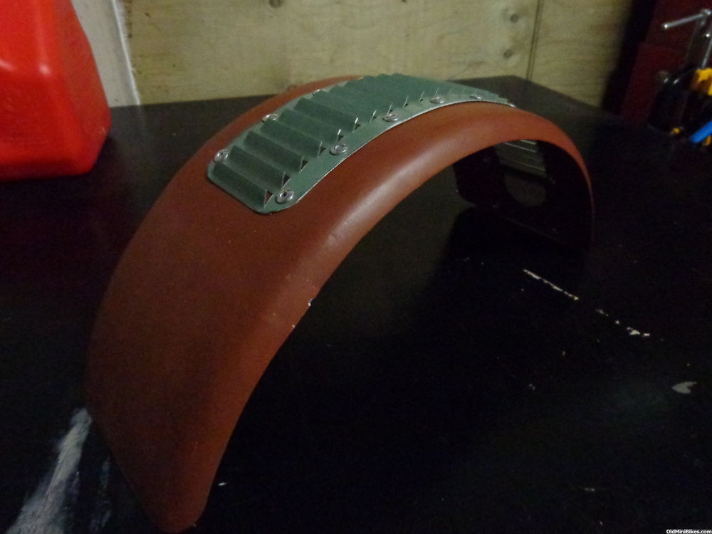

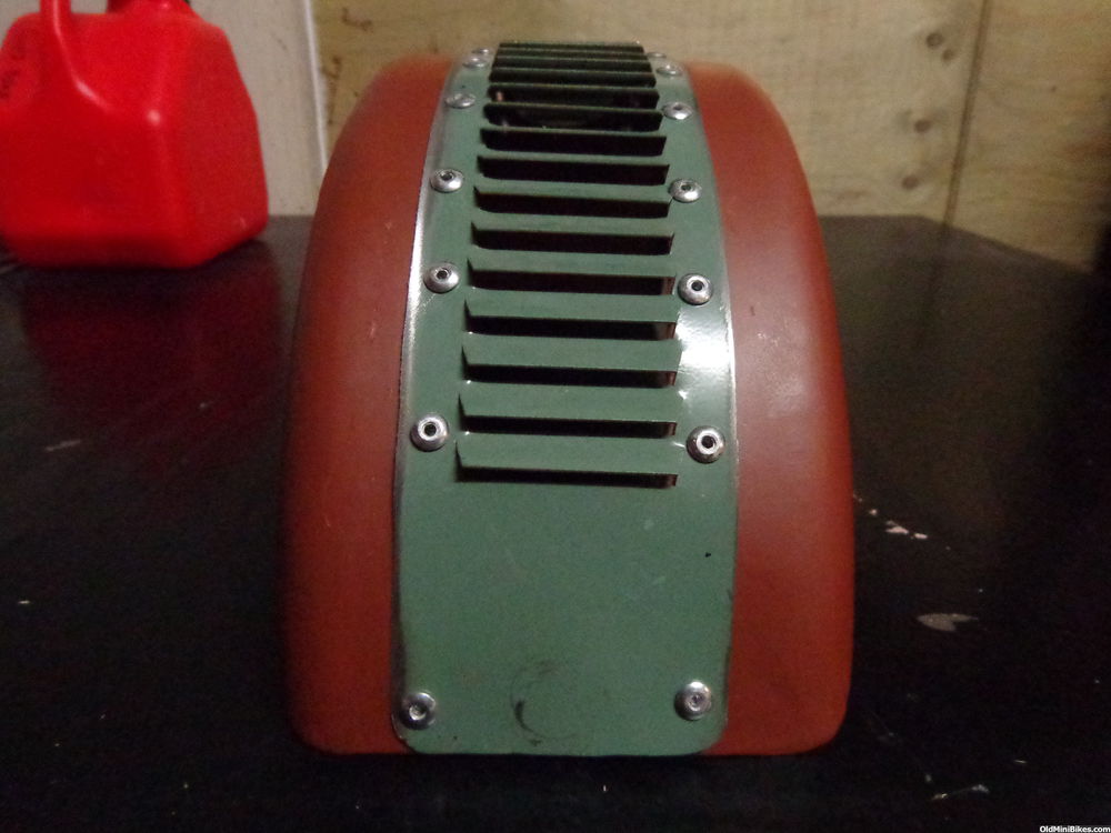

Here is my rear new fender. The first order of business was to extend my rear fender. My end goal is to build some mud flaps to replicate the style of old rally cars. Here is what I have done so far:
The two parts were butt welded with braces on the under side (Thank you SidePocket) After cleaning up the joints I removed the middle section of the fender and added a strip from my old furnace cover.
Originally I had planned to weld this but I decided on rivets - true dirt track style. I do plan on giving this bike a new coat of paint but right now I am really enjoying the "furnace green" and primer red...:laugh:

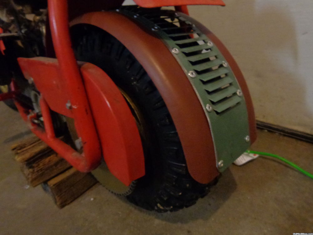

Test fit up - you can see in the top of the picture where the original fender sits. Can't lie, this modification was inspired by FatBoy04's build off bike from last year. (if he sees this - let me know if that project was ever finished :thumbsup:)
