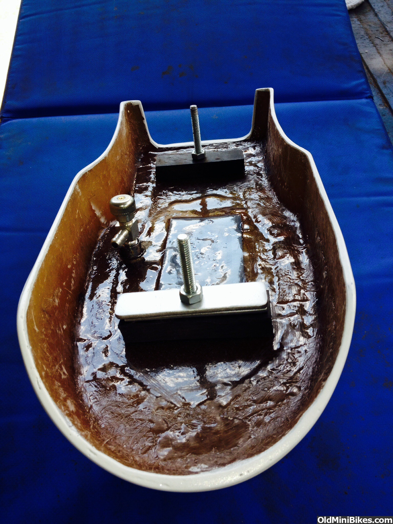

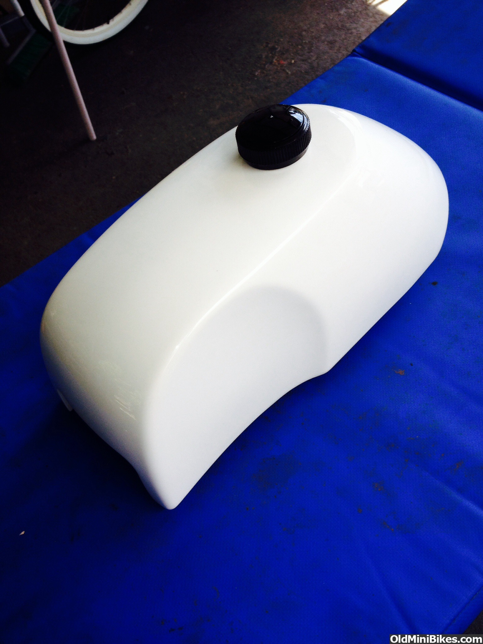

125ccCrazy
I was curious about the necks and Bill told me that they the metal necks were basically sat on top like Marcus mentioned and like George said they would stick to the cap and unscrew off the tank leaving what looked like a fiberglass filler neck... I been playing around with a mold I made from a tall Tec filler neck and made a few fg necks...metal caps screw on them and tighten down good... looking at an alternate option for the harder to come by Tec filler necks.. Briggs work but are a bit short and don't leave much space between the bottom of the cap and the top of the tank when they are glassed in from the inside of the tank..

Will do Marcus, so far I have only come across them on old tanks, the fg ones I made will work but if I'd rather use original metal necks..
125ccCrazy
No I'm looking for actual metal ones to solder back onto tanks....those came out REALLY nice though :thumbsup:
these are just for some universal fg tanks I'm messing with... I've searched high and low for new metal necks myself but haven't come up with anything vintage style.. only the newer twist and lock ones..
