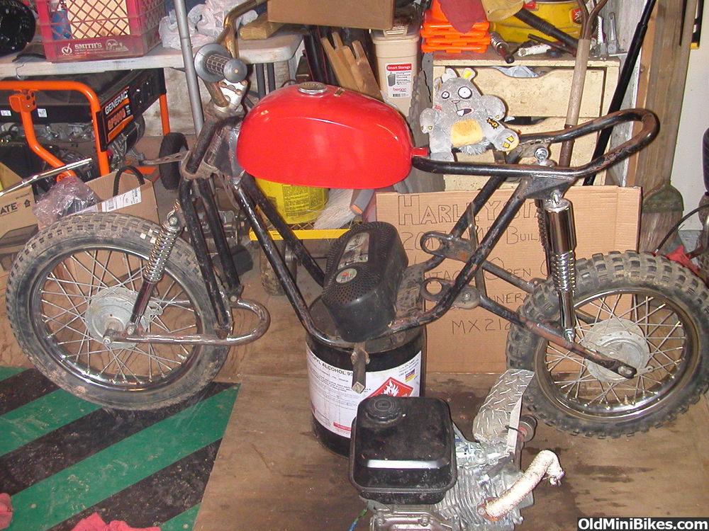

Thanks guys :thumbsup: I was going to take more pic's but as soon as I took that one the battery in the camera died :doah: I get more pic's later :thumbsup:
#6
Here is a better pic with the tank I am going to use :thumbsup:
The fenders have some un needed holes that need to be filled, the tank and fenders will be painted Yellow :thumbsup:
I'm going to make plate mounts and try and use 3 yellow number plates with black numbers :thumbsup:
I got a set of period correct grips from a clown on the west coast :laugh:
I'll be using this predator that came off my Wards trike before I sold it :thumbsup: its a mild motor with rejet w/adjustable main, air cleaner and I will do a custom header that will go over the motor and down the front and under the bike with a removable muffler :thumbsup: I'm not sure if the fly wheel cover will be black or yellow :shrug:
The swing arm was already stretched when I got the bike, I need to make the # plate mounts and a rear fender mount(the oem fender mounted to the bottom of the seat) The frame will get a gloss black paint job :thumbsup:

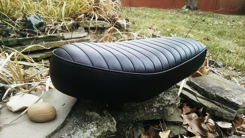

I got some thing in the mail yesterday from a clown.....I mean my good buddy Eric/CarPlayLB :thumbsup: I think it compliments the Fox decal I bought when I got the tank :thumbsup:

Looking forward to watching this build. Anything fox or speedway I love. Was thr rear swingarm lengthened?
#18
Hey Randy nice to see you in!! I like that tank on there! What did it come off of originally?
#19
Thanks J the tank is off a small Chaparral E-bay add said "new old stock" but I think its a repop :shrug: I did find an OEM tank but its like swiss cheese :doah:
