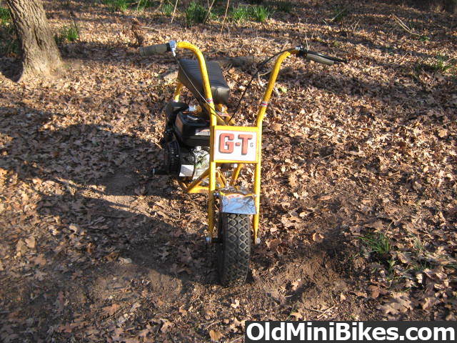

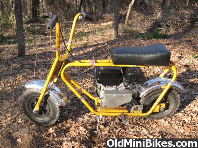

I'm finishing this bike this weekend, got some trail 70 fenders that I'm planning to use on it. They are beat up but they are chrome, free, and they fit the contour of the tires. I have the controls mounted and a big 30 amp chrome toggle for a kill switch, the Predator is in place but the throttle has yet to be hooked up. I need to install the chains too. Bout done and it's going to be a ruffian but I like the overall look. Gonna use cap nuts atop 1/4 20 bolts to fill the extra fender holes. I will ride it while I look for some 6" Manco wheels with the proper spacer and a good sprocket or Astros if I can get a good sprocket for them, I'll do a band brake then and put the Azusalites on a yard kart that doesn't need perfect wheels. I'm hating the wheels and brakes but it's what I have. I have yet to spend a cent past the $40 Kenny special which I'm also hating. The seat is fine, just not on this bike. I'm having a big ass tuck and roll seat made for it by my boat seat guy when I can get with him on the particulars. I'm not doing any more minibikes for a while after this, gonna enjoy the summer with my kids and load the DBs for a few trips to the lake. I'll take this bad boy too to test it in the sand and the hills with the tall traction tires. :thumbsup:

Finished
All done, went for several shake down runs and no issues. Fenders turned out OK, I'll get used to the seat till I can get the one I originally wanted finished. I will of course put a cheater spring on the Predator's arm to get the revs up for more top speed. I like it.:thumbsup:
#24
Looks good Outlaw Ace. :thumbsup: Those CT70 fenders really fit great, they are nice and close to the wheels. Looks like the perfect rider. Nice work, I am sure you will get lots of enjoyment out of it. :thumbsup:

#32
Looks good Ace. elaborate more on the fenders What are they from ? I have a Trail Horse I am working on and its missing a fender. Always interested in options :thumbsup:
#33
Thanks Paul. They are Honda CT70 fenders but don't get me lying on the year, I drilled the holes on the side and used nuts for spacers then put bolts through the extra holes and ran some flanged nuts down on em. It's a rough old bike but that was my intention, it runs very well and I've been riding it since completion. The blue DB is getting dusty. I'll search for some inner sprung Trailblazer or Horse forks to ease the bumps some but it's been on the road and will be mainly. I have off road bikes though.
