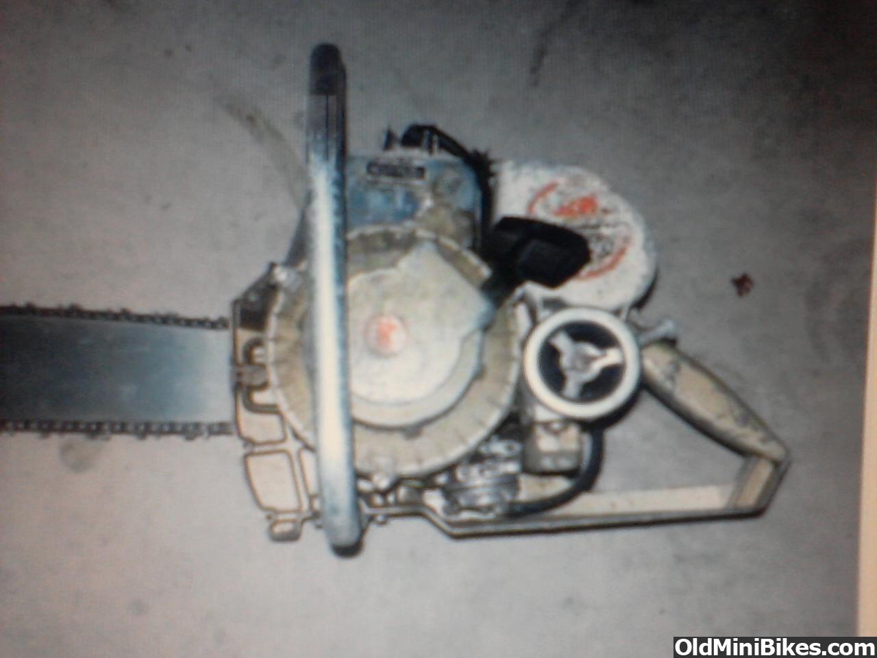

I recently picked up a Power Products AH58. I had been looking for one for awhile, and had even put a wanted ad in the local Craigslist. (Later, I realized how rare these engines are and that it was a longshot but that ad turned into some pretty cool connections) I was able to get the engine from a friend and local OldMiniBikes'er, Karterman. It needed a lot of work and this is the first two stroke I've ever owned. Fortunately, my uncle Louie knows a bit about them and was able to help me out a lot! In other words, I got to watch a master at work. I wasn't just a bystander though. I took care of the cleaning and painting. BAB hooked me up with the cool header which I polished up. :thumbsup: The rest was Uncle Louie. Here are some before and after pics and video of the engine as it is now... decals, air filter, and engine mount are in progress. Huge thanks to Uncle Louie, Karterman, and BAB for their help with this. :drinkup:
