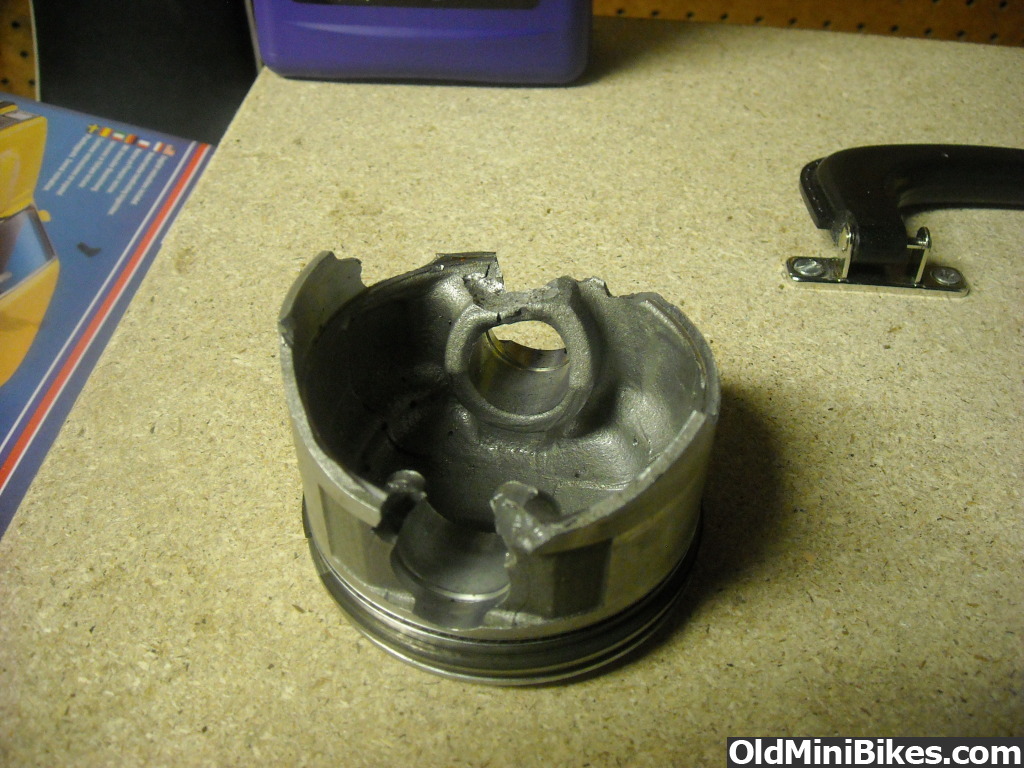

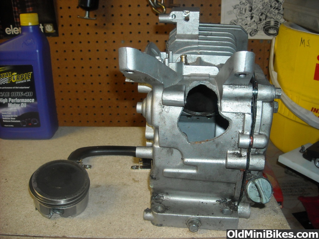

Here is a Tec that had a rod failure. Found by Jeep2003 in another forum. Stock engine Gov removed
