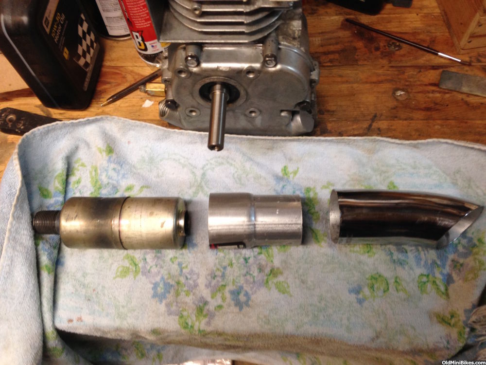

Tired of looking at your 5hp sausage muffler? Does it distract from your otherwise beautiful mini? Here's a solution that can take many variations all for under $12. Ingredients needed: 1-sausage muffler 1- 2 1/4 x 2 1/8" auto exhaust reducer/adapter and 1- 2 1/8" auto chrome exhaust tip.
Cut the adapter and tip to size, add a few set screws, and voila--
