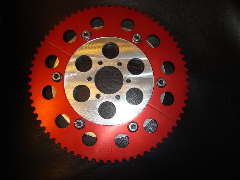

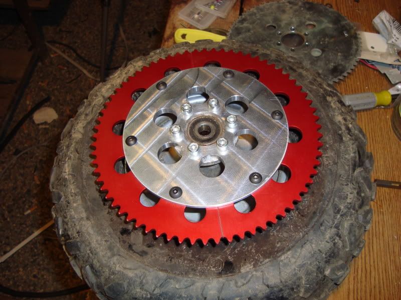

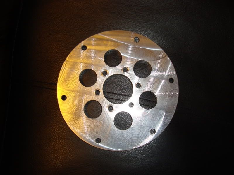

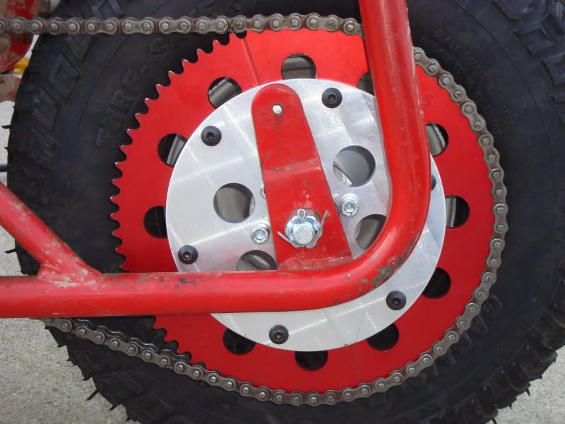

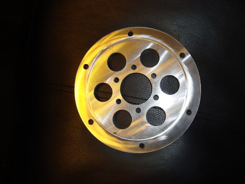

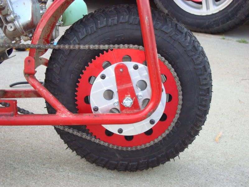

Ok guys,
Final product will be glass beaded to give it a more uniform look (unless everybody likes the unfinished look). This adapter keeps stock alignment of chain, so no shimming to make it work, also you use your stock bolts on the hub (I suggest you buy new ones cause there cheap and the stock one tend to round out the allen). Either take a few links out or put them in for gear changes or move your engine for proper chain tension (1/4"-1/2").
Ok a few things to think about before wanting a 80 tooth gear. You will have less the 3/8" clearance if you go with a 80 tooth. 65 or 70 is stock btw. Use this to see speed and RPM's go-kart racing Gear Ratio Calculator. I tried 3 different sprockets today 57 (1/4 mile not to full speed) 66 (felt good for my motor) and a 80 (chain grinder on corners and a wheelie machine). Also have 68 (as seen in pics) but alot like stock
These work on old (2003ish) and new style Doodle Bug(2007-current) rims with 6 bolts on the hub
Cool thing about this set up is you can buy gears at almost any kart shop. This adapter is a industry standard 4 9/16" center registry. Horstman Sells gears and so do a few others, here is a link to online at $18 Sprockets at Comet Kart (make sure to click #35 if your staying stock). You can use split (don't have to take the rim off) and solid gears (have to take the rim off).
Also if you feel the need you don't have to keep you DB a #35 chain. If you purchase a clutch for chain size #219 or #40/41 so you can use the 219 or 40/41 sprockets with this adapter.
